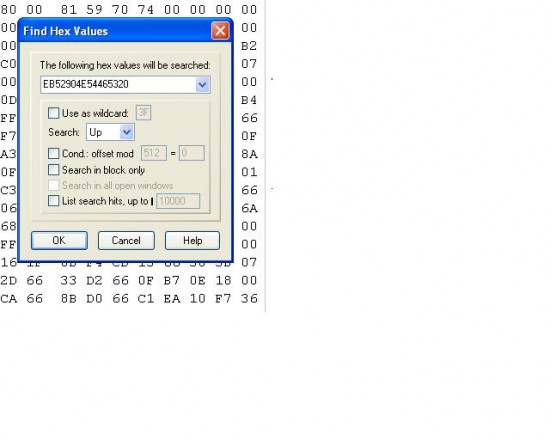

If your raid are still working like before and no one program helped, so there is something else which prevents to get data in useful format. If you have winhex or something like this open raid in it, go to the end of raid and search like in a picture in attach.
Yes, the RAID is still a RAID. Still reads as 1.82 TB to Windows, WinHex sees it as a RAID, as does most other programs I've worked with thus far. I found that Hex location, sector 3,907,035,135 of 3,907,039,232.
What should I do with that?
Please give us content of those sectors.
