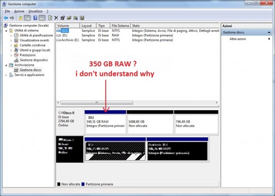

Hi, i've this drive:
WD My Book WDBFJK0030HBK-04 - 1230
USB bridge: ASMEDIA ASM1051W BNF2502783

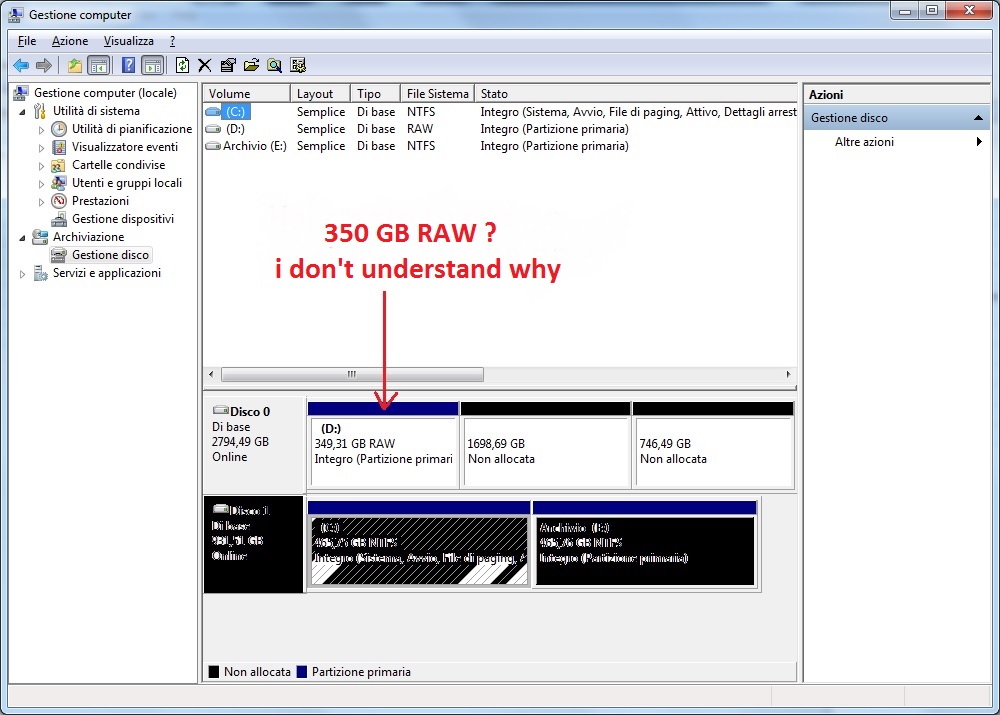

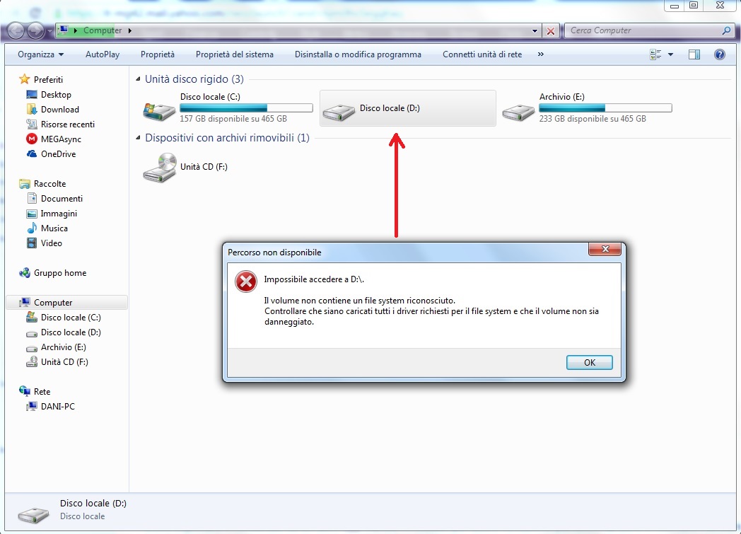

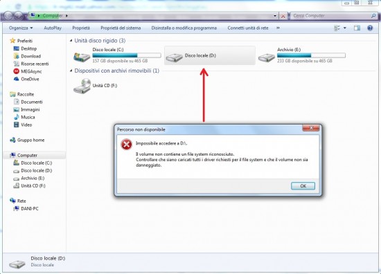

I attached the drive directly to my MoBo via sata, i would expect that windows was not able to detect partition due to HW encryption, but this time his behavior was a bit different. Windows detected the partition but as corrupt (it asked me to format).
Woow that's strange, usually when i attach My Book drives directly to the sata, windows is not able to detect any partition, but this time it detect somehow!

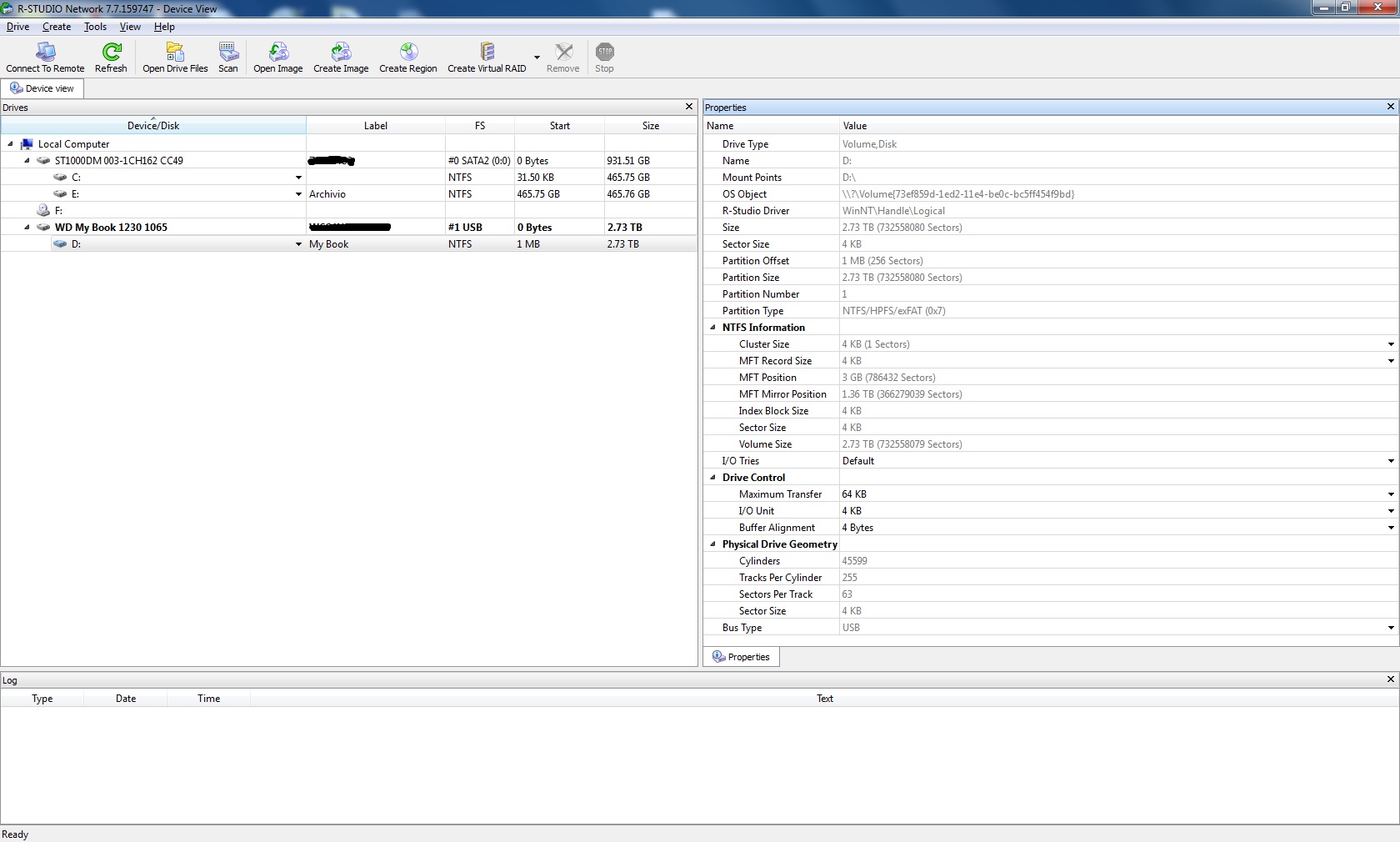

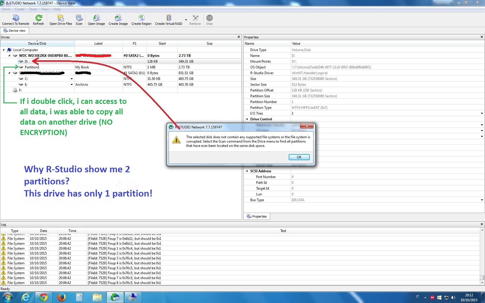

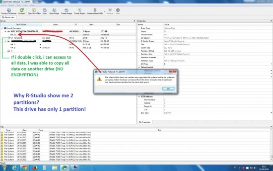

So i thought that maybe it wasn't really encrypt but had corrupt filesystem, so i opened R-Studio:
With my surprise i found that R-Studio is able to see and recover all files and folders if i double press on 'Partition1', it shouldn't be able even to detect partition if there was a real HW encryption! :shock:
What's strange also is that R-Studio detects 2 partitions, but this drive i know that it has only 1 partition (maybe R-Studio is not detecting 2 partitions but just 2 pieces of 1 partition).
Ok, so i guess it is not HW encrypted this drive, but why windows doesn't detect the partition?
Another pic about what 'disk management' show:

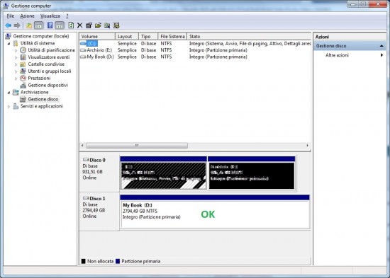

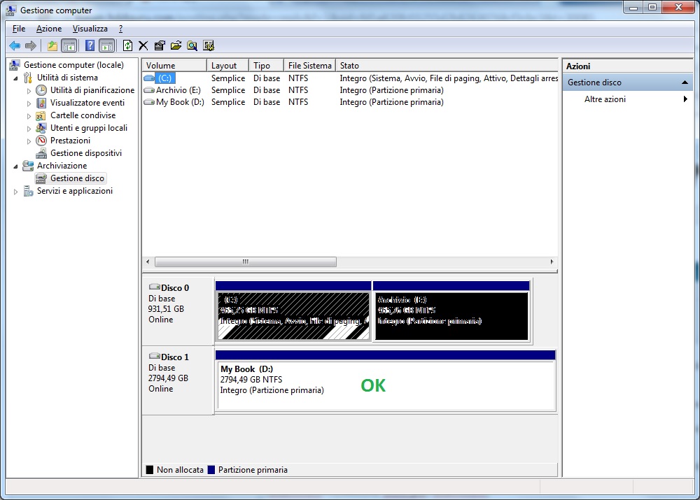

Now i have mounted the drive on his MyBook enclosure, it is detected without any problem on windows.
This is what 'disk management' see now that the drive is again mounted on his enclosure:

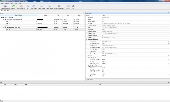

and R-Studio:

There is one answer for all your questions - box uses 4k sector for read\write operations (instead of regular 512b sector in windows).
 Post subject: Re: WD MYBOOK WDBFJK0020HBK - 1130 DECRYPTION
PostPosted: October 13th, 2015, 21:47
Posts: 17223
Seagate's and WD's 3TB external drives are configured with 4KB LBAs. When you remove the drive from its enclosure, you expose its native 512e LBAs. This means that the OS now sees a 4Kn file system on a 512e physical drive, rendering the file system inaccessible.
The reason that Seagate and WD do it this way is to enable a legacy OS such as Windows XP to work with the drive in MBR mode. When the drive is connected to a SATA port, Disk Management sees a single MBR partition. The capacity of this partition is 349 GiB (= 3TB / 8).
