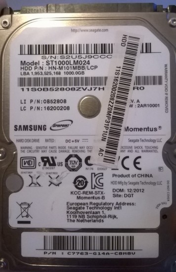

Hi All,
My HDD got broken and now it sounds like this: https://youtu.be/5hbqLCXx5LM
A guy told me that the heads might be broken and it will cost around €1000. Not sure if it's worth but if I could restore some data - would be nice.
I'm thinking about replacing the heads on my own but I'm wondering where to get the parts from.
It's difficult to find a drive on the web with the part number HN-M101MBB/LCP.
Wondering if it's ok to use parts from drives with a different P/N ending like EX2, D1 or AV2 instead of LCP.
Please advice about the parts! What are the chances of successfull repair doing it for the first time? :)
BTW: I'm located in the Netherlands. Maybe someone does such repairs privatly and could help?
Cheers,
Lukasz

I would recommend to give drive to some one who did it before. If you want to do it by your self anyway - I recommend to buy 2 similar working hard drive and exchange heads between each other. If it will work after - so you could try to do it on original drive. But there are still could be other problems with system modules or something else. I don't know how you will solve those problems without special software.
I could try to recover data from your case for $300. I have experience, tools, parts. If I can't recover data - you will pay only for shipping to Canada. If it's suitable for you - PM me.

if you are doing it for the first time am afraid chances of success are very very low. you can try to send your disk to Seagate they have office in Netherlands (+31 20 316 7300).

Thank you all for your replies! If the risk is that high doing it for the first time I will use your services.
