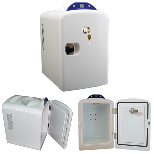

Just so you know, IMHO the "proper" way to do it is with a Peltier-effect mini-refrigerator. They cost about $100. I have experimented with some crappy designs that failed, so quality is important.
A typical hard drive dissipates about 6 watts during operation. Lets assume about 9 watts to be safe with an imperfect calorimeter. That equates to about 31 BTUH. Not a huge load to dissipate to achieve thermal equilibrium.
According to Wikipedia, "The COP of current commercial thermoelectric refrigerators ranges from 0.3 to 0.6. So that's 15 - 30 watts input. A fridge like the one shown draws about 4.5A at 12 VDC, or 54 watts. Plenty of margin to get the job done. Notice that the one shown has a nice LED for temperature display. Some modification required . . . sure to void the warranty. :D
Sufficiently elegant for you, sir? Or have you a better idea?
Oh yeah - don't forget the importance of desiccant.
