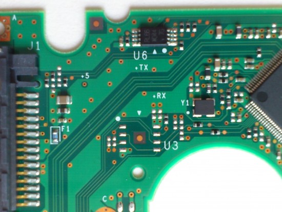

Please go easy I'm green to this. I have a friends HDD that I'm repairing for his Mum purely out of kindness. I have never got so involved in a physical repair of HDD. I normally stick at software based recovery purely as an interest.
A cheap molex connector on a sata usb adapter was reversed so the story goes at his attempt to pull the data. The drive will no longer spin. The data is valuable.
The drive is a Hitatchi 120gb 2.5 SATA HTS541612J9SA00 P/N 0A50686. I have located identical drive and it's on its way, fingers crossed here. It was manufactured in same month of same year (May 2007) and the codes on the pcb board (both) are identical. My plan is to swap the boards but need assistance here please.
I have read around Hitatchi drives and the NVRAM chip which I believe is located at U6 on this board. Given that the board is a great match can I just swap boards or is this NVRAM chip exchange critical for function, like a unique code is to a safe? I ask as I will need to farm this out to a guy who has competence with components/soldering. Could I damage/corrupt the disk if I swapped the board prior to exchanging chip to see if it would work? I can't slip up here.
Another question I have is given the nature of the over voltage causing the malfunction and putting the replacement pcb board to one side for a moment could it be worth bridging the fuse at F1 (I think) just to get data off. Is this likely all that has blown or is this a definite no no? There is no evidence on pcb of charring. A multimeter gave a reading to earth from one side of fuse only, no continuity across it. I'm clueless as whether fuse is on an earth circuit so advice is very much appreciated here..

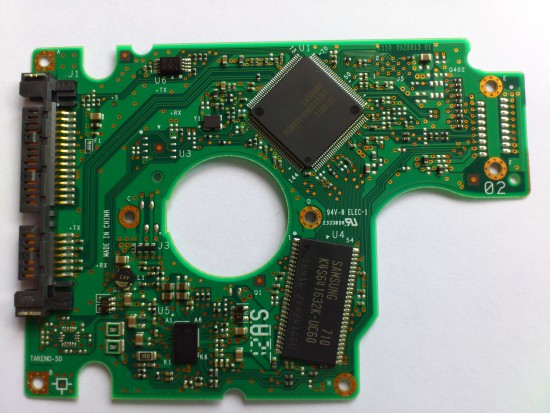

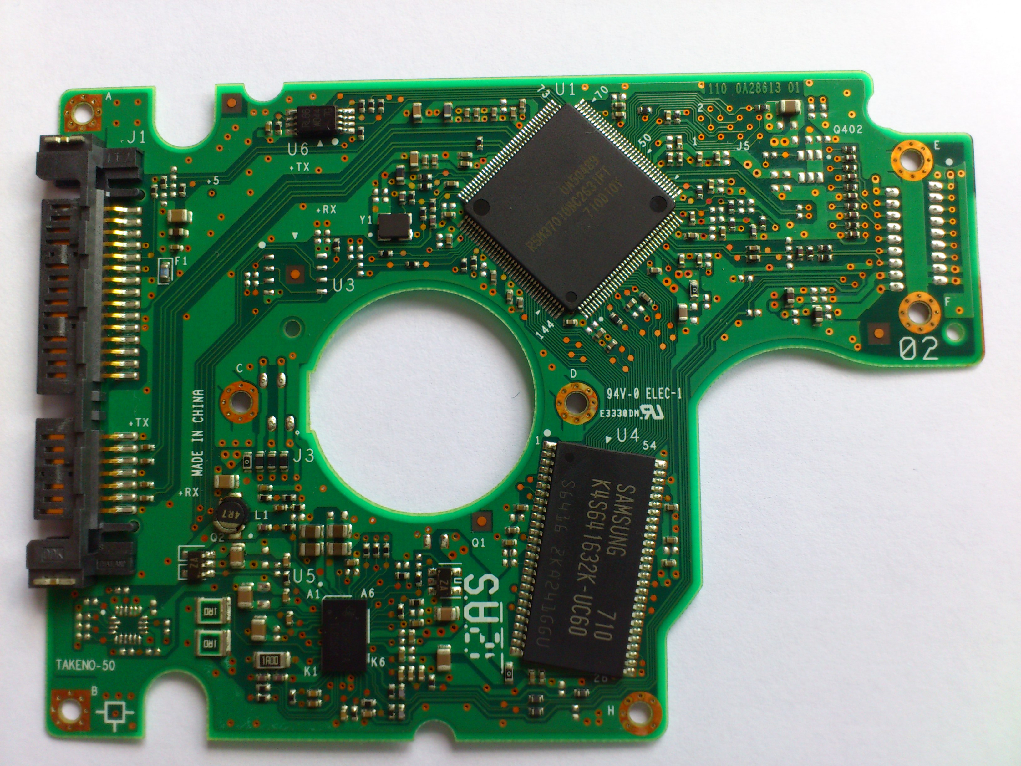

You MUST transfer the NVRAM, or its contents, from patient to donor.
I would not swap boards without swapping the NVRAM, even for testing purposes. I believe there are certain conditions under which some Hitachi models may rewrite the NVRAM, rendering both patient and donor inoperable.
As for the fuse, I wouldn't bridge it. There is most certainly a fault elsewhere on the board. If you would like to do some simple testing, then upload a detailed photo of the PCB.

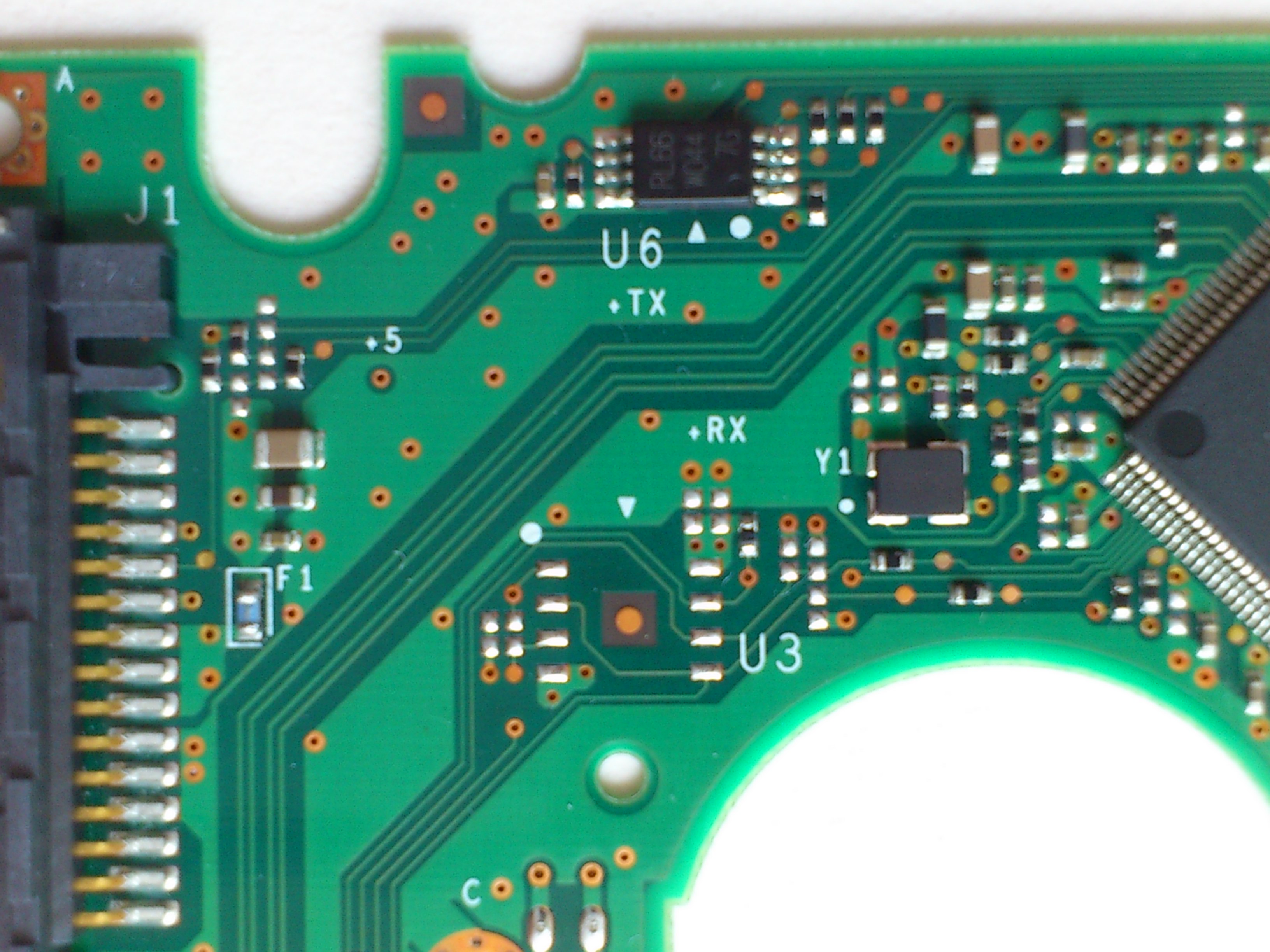

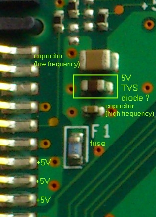

Hi, Thanks for the replies guys. Really appreciated.
Fzabkar, here are a couple of images that I hope will be ok for diagnostics.
As green to all of this how feasible would it be possible to transfer data as per your last post to NVRAM chip.
'You MUST transfer the NVRAM, or its contents from patient to donor'.
What equip would be needed for this purpose?
As a last resort, this is an idea (only) on the backburner. Would a platter swap be ok from patient to donor in clean area and if so would patients NVRAM have to be swapped to the working pcb also.
This situation is causing angst, sometimes it would be easier just to say no or not offer to help but I'm in deep now and resolution it is hoped is only option and that is thanks to the kindness of you guys too.
Your help is really appreciated.

IMO the safest DIY approach would to transfer U6 to a compatible donor PCB. Certain PCB suppliers offer a free chip transfer service.
http://www.onepcbsolution.com/
http://www.hdd-parts.com/
Alternatively, your local TV/AV repair shop should be able to transfer this chip for you.

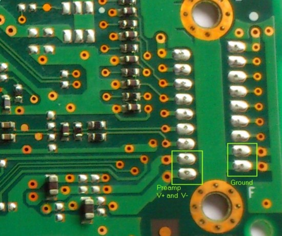

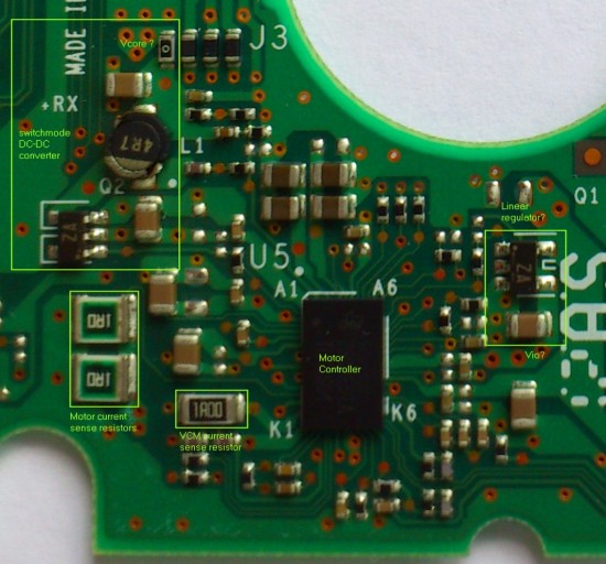

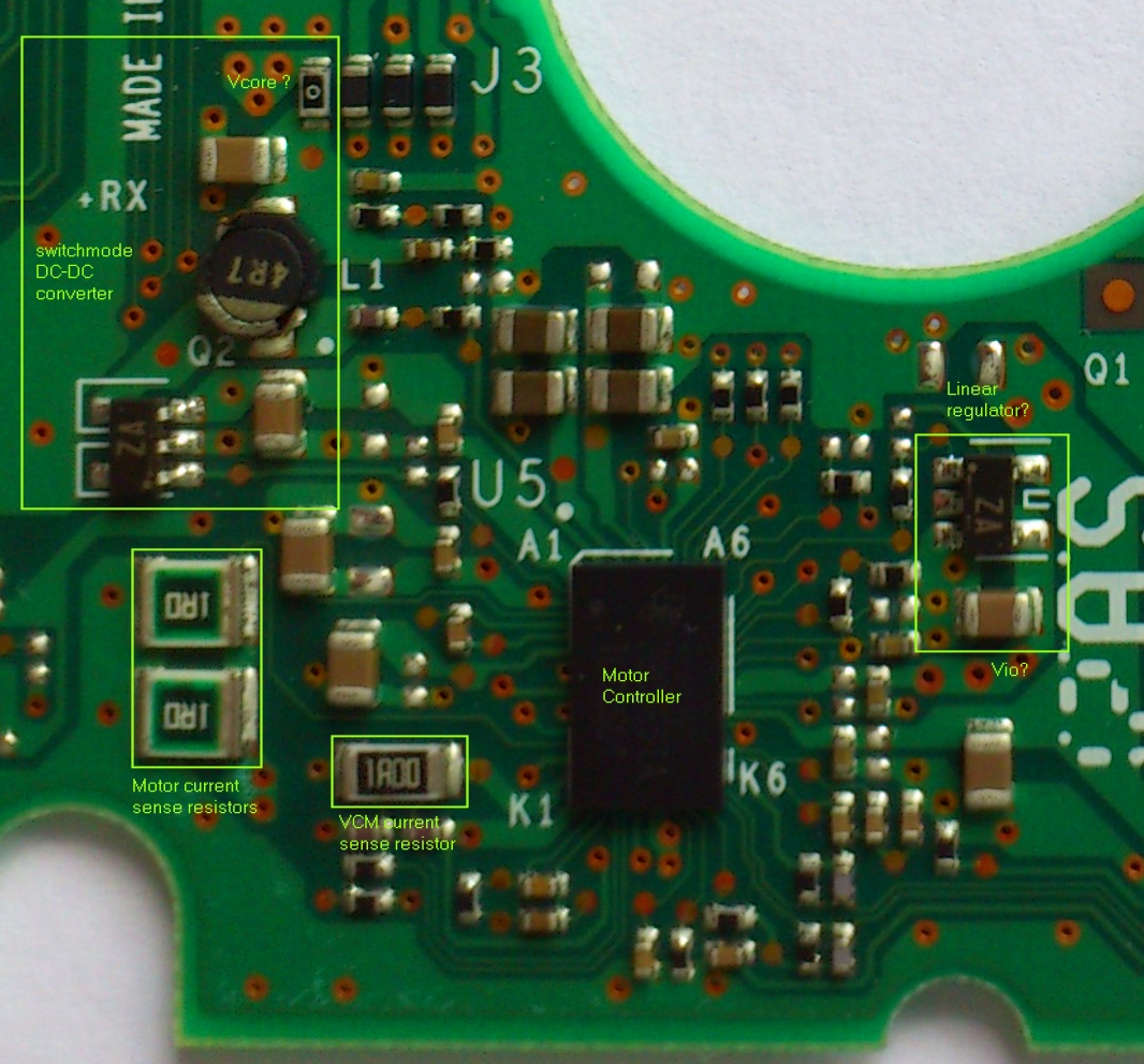

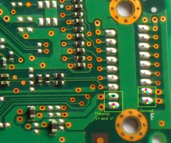

There are some measurements that you could take to assess the extent of the damage. The first would be to measure the resistance of the fuse and a component which looks like it might be a 5V TVS diode. If the diode measures close to 0 ohms, then remove it and retest both the diode and the circuit. If the circuit still measures 0 ohms, then there will be problems elsewhere.
The protection devices on Hitachi HDDs don't appear to do a very good job, so even after removing a shorted TVS diode, there may be additional faults. The next thing I would do would be to determine whether there is any continuity between the +5V pins at the SATA power connector and the V+ / V- pins at the preamp connector. If so, and if the fuse F1 is open circuit, then this would mean that the supply to the preamp is not fused, which would in turn mean that the preamp may be damaged. What resistances do you measure between +5V and V+ and V-?
The next thing I would do would be to measure the resistances between ground and each of the Vcore and Vio test points.

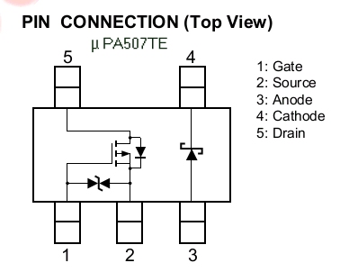

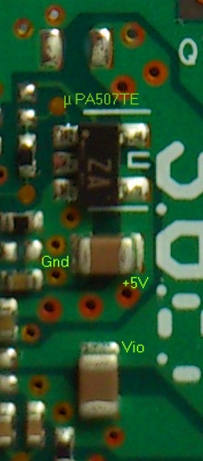

I think the Vio regulator is probably wired as follows:
uPA507TE, NEC, P-Channel MOSFET with Schottky Barrier Diode, marking ZA, 20V. 2A:
http://documentation.renesas.com/doc/Do ... V0DS00.pdf
http://pdf.datasheetcatalog.com/datashe ... oac03y.pdf
Edit: The Vio supply is wired to the SDRAM's supply pin, so it would be +3.3V.
K4S641632K, Samsung, 64Mbit, 1M x 16Bit x 4Banks SDRAM, 3.3V:
http://www.datasheet.directory/samsung/ ... K-UC60.pdf

Have located a DMM and have a few measurements for you but need a little clarification on where to take readings from Vcore and Vio components.
I'm new to this and its been a steep learning curve to say the least this past week but I'm in it till the end now.
At this stage I'm trying to preserve donor HD until I know without shadow of a doubt patient PCB is shot and irreparable. Of course I will take your advice and swap over NVRAM chip at U6 if original pcb is not salvageable to donor I have.

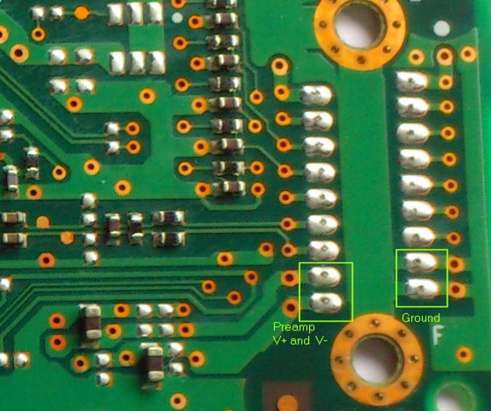

Here are some readings for you. (Meter set at 200K)
F1=0.01 ohms
5TVS Diode = 0.0 ohms
Resistances between +5V and V+ and V- = 3 read 0.1 ohms and 1 read OL Please see attachment.
There was no continuity from sata 5v to any of these points so am hoping pre amp is unaffected.
A long shot but could it be just F1 is faulty?
Look forward to hearing from you soon.
Kind regards
