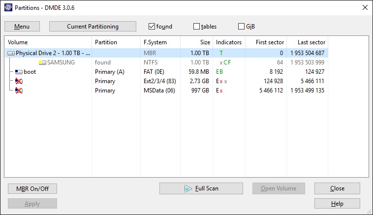

Hi guys, i know everybody here use a lot win32DiskImager... and i had one problem that maybe some have experienced it.
I have Accidentally wrote a retropie image(*.img) (using Win32DiskImager) to my external hard disk instead in my SDCard.
5s after i start have canceled the win32diskimager.
Now it reads 55MB as a partition is established on that.
there is any way to recovery the DATA that was in my external hd.
Oh god... i had so much important stuf there.....
im so sad...

Try an NTFS Search using DMDE:
https://dmde.com/
Can you show us DMDE's Partitions window?

So this is what I did in the weekend .

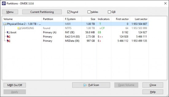

When I checked the partition that the windsik32 make, i had this ( atached Partition img )
Then i made the partition readable on the windows and start to use WONDERLIST to recovery the folders.

the DMDE is atached on this post
DMDE Partition
Partition img
Re: Accidentally wrote a retropie image on External Hd.... :
June 6th, 2016, 18:36
Double-click the 1TB Samsung partition.
Expand the Root
... or ...
Expand [All Found + Reconstruction]
- select Default Reconstruction
Select a large file, r-click and Recover the Object to another drive
Test the recovered file
