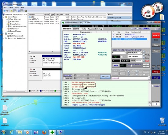

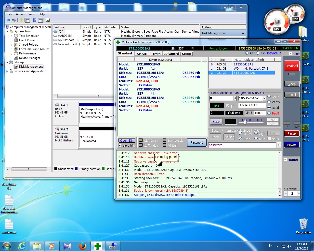

some time connect for one min with sata to usb convertor
but with wrong serial number

The serial number reported via USB could be the serial number of the bridge hardware, not the S/N of the HDD.
Is the bridge IC a JMicron JM20337 or JM20338?
Can you show us the drive's SMART report?
