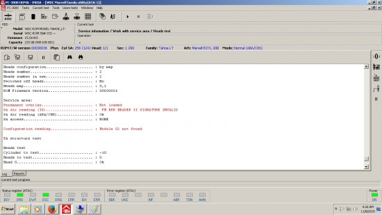

WD 500 GB
After Head Replacement from Exact Donar in clean room gives following error in PC3k
Techno mode key
Techno mode key......................... : Ok
RAM:
HDD Info reading........................ : Ok
Heads number............................ : 1
Cyl Count............................... : 256
Zone allocation table................... : HDDs RAM reading error - Device Error Detected: "SCT INVALID FUNCTION CODE"
ROM:
ROM reading............................. : Ok
ROM Data size........................... : 192 Kb
ROM version............................. : 03.36B
ROM generation.......................... : 03.55B
Link table version...................... : 05.02.
Consolidated ROM version................ : 00030036
ROM Modules:
Flash ROM dir reading................... : Ok (Active)
Flash ROM dir reading (Ext)............. : Ok
Modules directory address............... : 74 084
SA regions address...................... : by default
SA Translator loading................... : Ok
Heads number............................ : 2
Heads number in use..................... : 2
Switched off heads...................... : No
Heads map............................... : 0,1
ROM Firmware version.................... : 00030036
Service area:
Permanent overlay....................... : Not loaded
SA dir reading (ID)..................... : FM ERR HEADER II SIGNATURE INVALID
SA dir reading (ABA/CHS)................ : Ok
SA Access............................... : NONE
Configuration reading................... : Module 02 not found
SA structure test
Heads test
Cylinder to test........................ : -10
Heads to test........................... : 0
Head 0.................................. : Ok
11 Module not loaded , I have loaded from Resource .
Is this error related to Micro jog ?
Please help.
Peter

sorry i did't understand, the screenshot is from UDMA India and your location is USA, what is correct India or USA ?
disk is spinning fine no abnormal noise no spin down?
