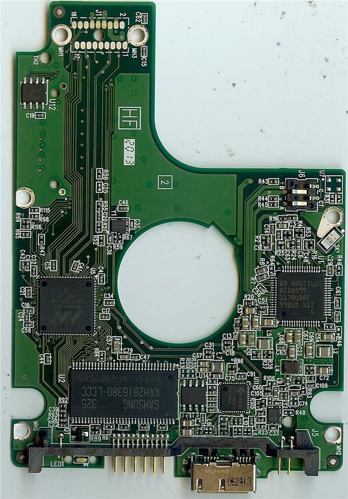

Hello guys,
Someone able to help identify compatible board for WDC_WD20NMVW-11AV3S2 2TB drive?
I would like to convert it to internal sata. There is a sata connector on the board but cannot identify the pin-out of the 12pin header. Only get as far as the power goes, and the drive would start. If i de-solder the second SPI Flash (U14) the usb device "WD My Passport 0820" disappear from devmgmt, and identifies itself as "WDC_WD20NMVW-11AV3S2" as a normal sata drive would. Got physical DUMP both of them, did some research. I am not new to binary and hex modding. Could someone help identify the SATA pins or a compatible PCB? The only firmware i need to take care is the 1st (U12) near the Head connector
I uploading both if someone need it but i removed my serial from the 2nd (U14) Replaced witha string "SERIALSERIAL" , i name security_fw.
I am a soldering tech so damaging the drive is no concern to me.
Look for a 2060-nnnnnn number on the underside of the PCB.
There is no SATA connector. I don't know the function of each of the header pins, but I believe they are used in some models for LEDs and pushbuttons. There may even be a couple of diagnostic pins (according to WD tech support), but I'm not sure. If I were you, I would trace these pins back to the MCU or bridge IC. Then obtain a SATA board with the same MCU and see where those same pins go.
Thanks, that's interesting. IME, in the absence of an external EEPROM, other bridges identify themselves with the bridge IC manufacturer's PID and VID.
You need to remove capacitors C31/C37 and C13/C18, then tap into the SATA Tx/Rx pairs on the underside of the PCB, namely E71/E72/E73/E75.
AssimilatorX wrote:
The only firmware i need to take care is the 1st (U12) near the Head connector.
Yes, that's right. U12 is the drive's PCB firmware (aka "ROM") while U14 contains the bridge firmware.

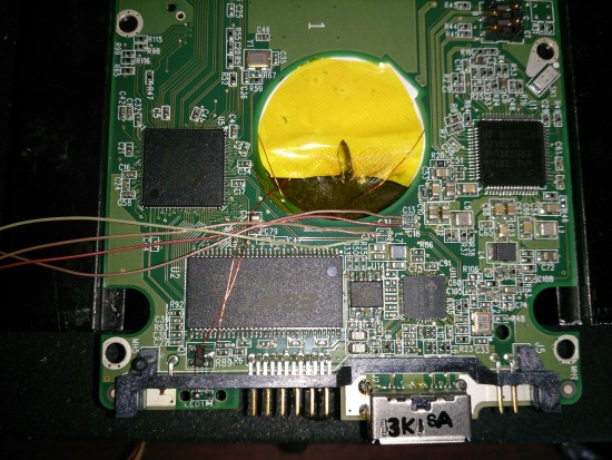

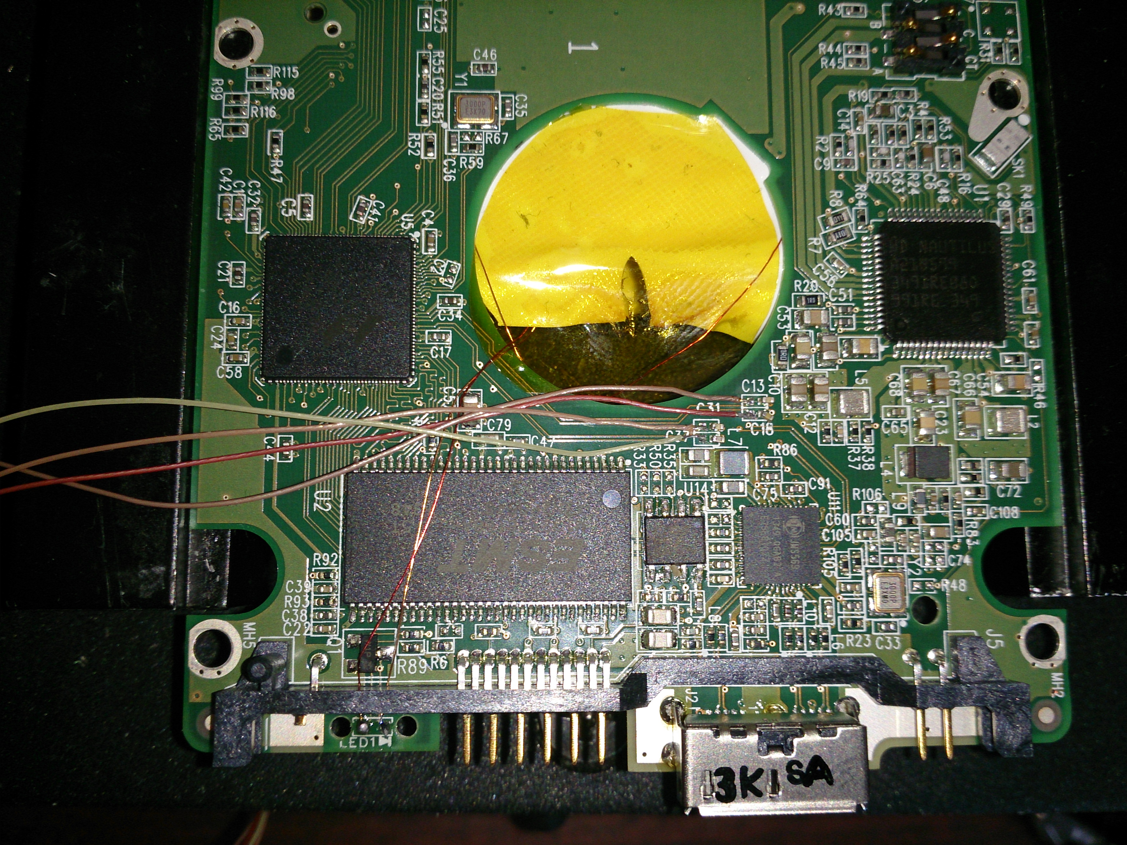

Update
the first trial is no success :( managed to identify the pins for sata conn c13 is A+ ,c18 A- c31 B- c37 B+ with help from fzabkar I got pics from another drive where the connection clearly traceable. LOL For first it did not worked on esata maybe because i used longer leads (soft core) same what hp using for their sata in their laptops. Maybe U14 also need to be removed so is not interfering with the drives firmware. Or perhaps my esata plug i used are faulty is been soldered countless times. Will try it later. 4 now just made a mod so is fit for my laptop :D Will not give up drive still works and if i kill it just go RMA . Report back when i got something useful. Meantime try to get a WD20NPVX drive :D PCB almost same except the USB 3.0 crap.

Update!!! ITS WORKING.
Just had to have those capacitors on but de-touched from the side which goes to the JMS chip. Nerveless the config really fragile, but working. Had to power it from the usb 3.0 port and remove the 2nd flash chip, and because of that i got a JMICRON USB device and a WDC_WD20NMVW-11AV3S2 in dev mgmt. However SMART data cannot be read and the drive not showing in any diagnostic software. Is accessible from diskpart, diskmgmt , can boot as well :D but not appear in crystal disk info.
Conclusion: is good for recovery if the usb bridge has blown, and don't have a spare pcb.

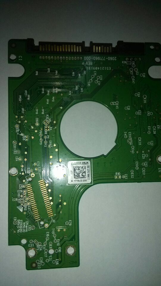

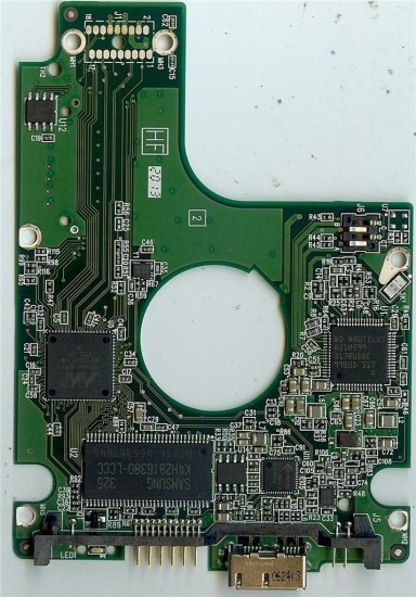

2060-771960
