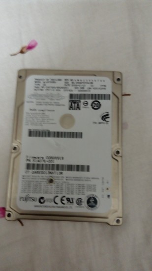

I am new to this hard disk recovery. I had a dead Fujitsu 320 GB hard disk with model no MJA2320BH, made in thailand to be recovered. The current status is being taken in this video -https://www.youtube.com/watch?v=uMr2B1UMZn0 . Kindly guide me to try out different steps to recover data from this hard disk. The disk seems to be scratch free. Thanks for the support. :|

The photo of the drive is -

#1: Don't open the drive.
Too late...

Probably problem in system modules, but there is no free software to work with system modules. Even pc3000 doesn't work well with this fujitsu model. If you need data - go to pro. If data is not important-just forget about drive. You took worse model for beginners.
