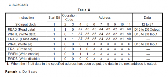

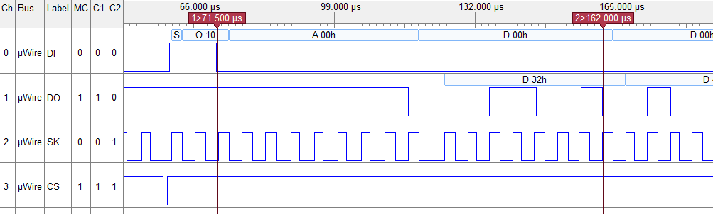

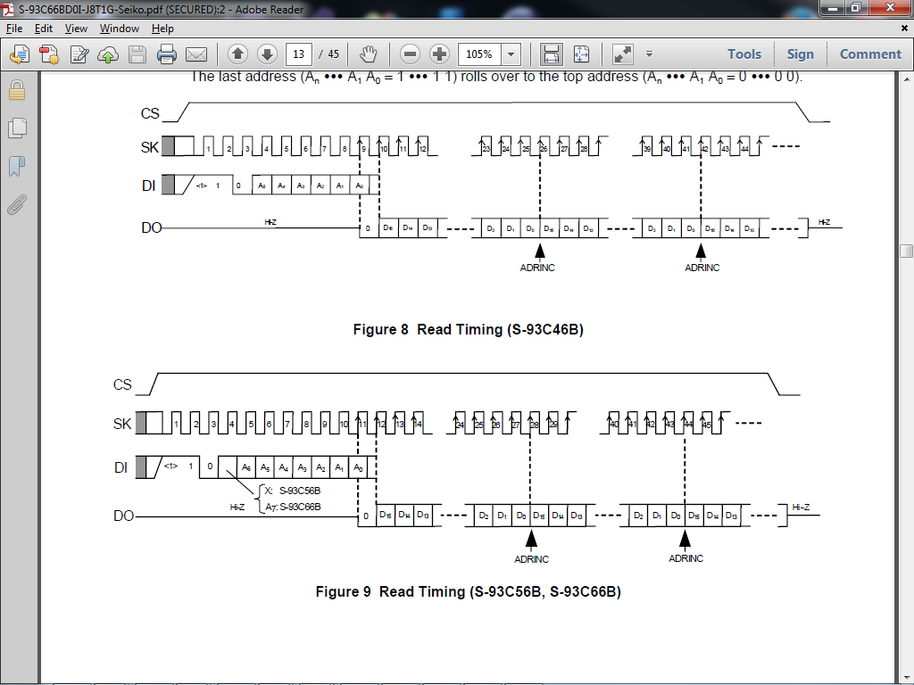

Looks like dumping the EEPROM will take a bit longer, it's not SPI as I initially thought, but MicroWire.
I ended up writing a little protocol decoder in order to make sure that I'm communicating with the chip properly and out of curiosity I hooked up the logic analyzer to the EEPROM, while it was mounted on the PCB and the PCB on the HDD.
I may have stumbled upon the reason why the EEPROMs on these HDDs are known to get corrupted.
It appears that they're clocking in the data in reverse clock polarity than what the EEPROM is expecting. They setup the data on the same edge that the EEPROM is sampling it and they're getting away with it just because there's a bit of a delay between the setup time and the clock edge, so the EEPROM reads the correct value.
They either misread the datasheet and got confused by the fact that the EEPROM is expecting data in on the rising edge, but it's pumping out data to be sampled on the falling edge, or the main MCU was unable to deal with this properly and they had to work around it, but if that was the case, they could have simply used a different EEPROM, because this solution would have simply been unacceptable. My money is on misunderstanding the datasheet and getting away with it through sheer luck, which from time to time ran out and the 10 command that indicates a read, became a 11 command, which indicates a write.

Indeed. I attached a couple of screenshots to back my claims.
In the logic analyzer screenshot you can see how the DI data is being setup on the same edge with the DO data, when the datasheet clearly shows that that's not how it should be, because after the opcode and address are received, there's a polarity change and the data shifted out by the EEPROM is meant to be sampled on the opposite edge than the data shifted in.
I will attach the contents of the two EEPROMs in a bit, I just managed to extract the contents from the IC that was on the working HDD.

As for the traces, the datasheet specifies a minimum data setup time (tDS) of 0.2us. ISTM that the delay between the trailing edge of DI and the leading edge of SK may actually satisfy this requirement, but you would need to expand the scale to be certain.

Looks like you may be right about the setup time, I thought I'm on to something. The time between the samples in the LA screenshot is 0.5 us so I'll have to check again once I have one of the HDDs assembled again.
