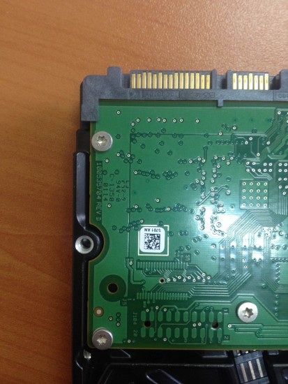

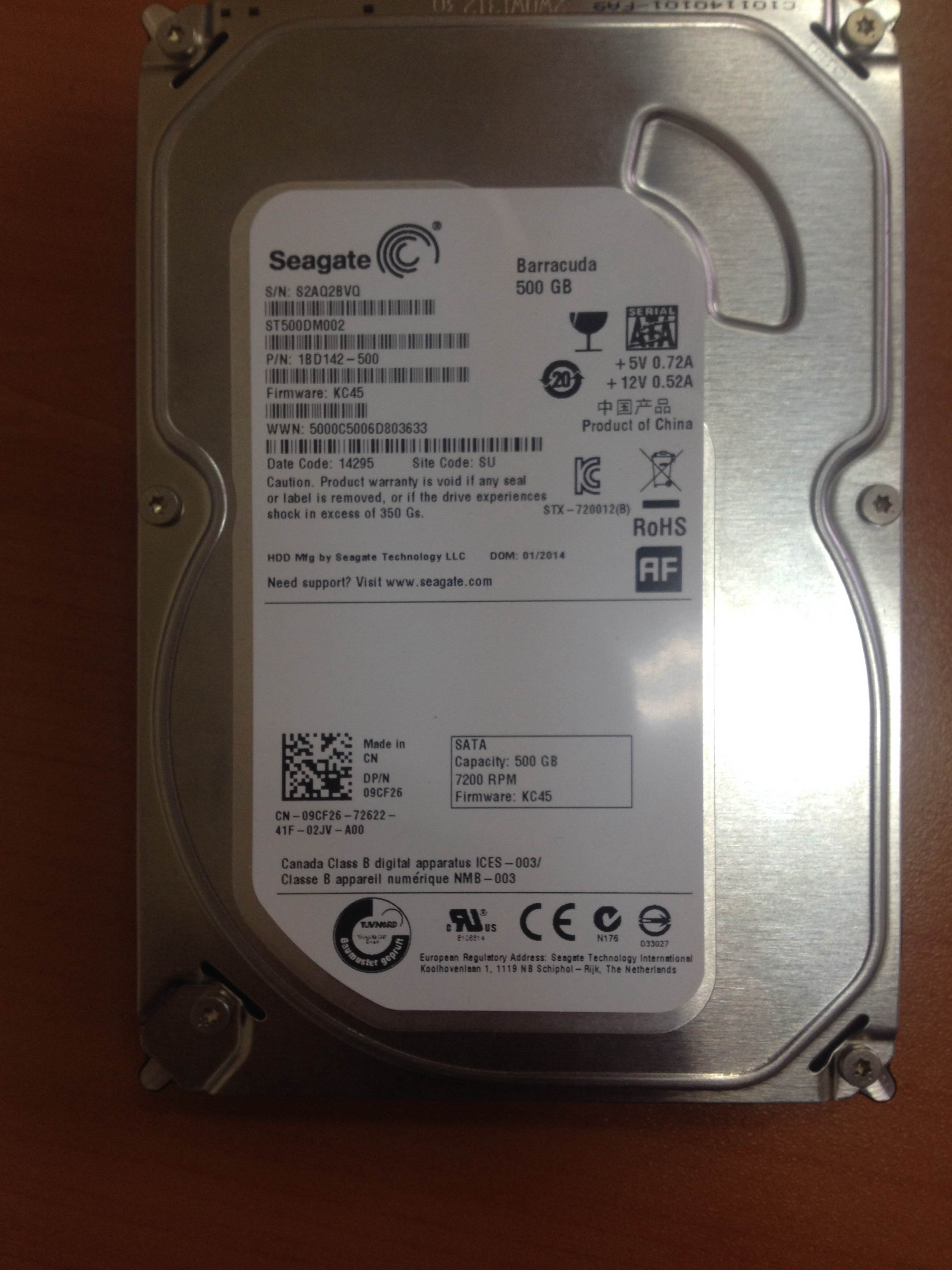

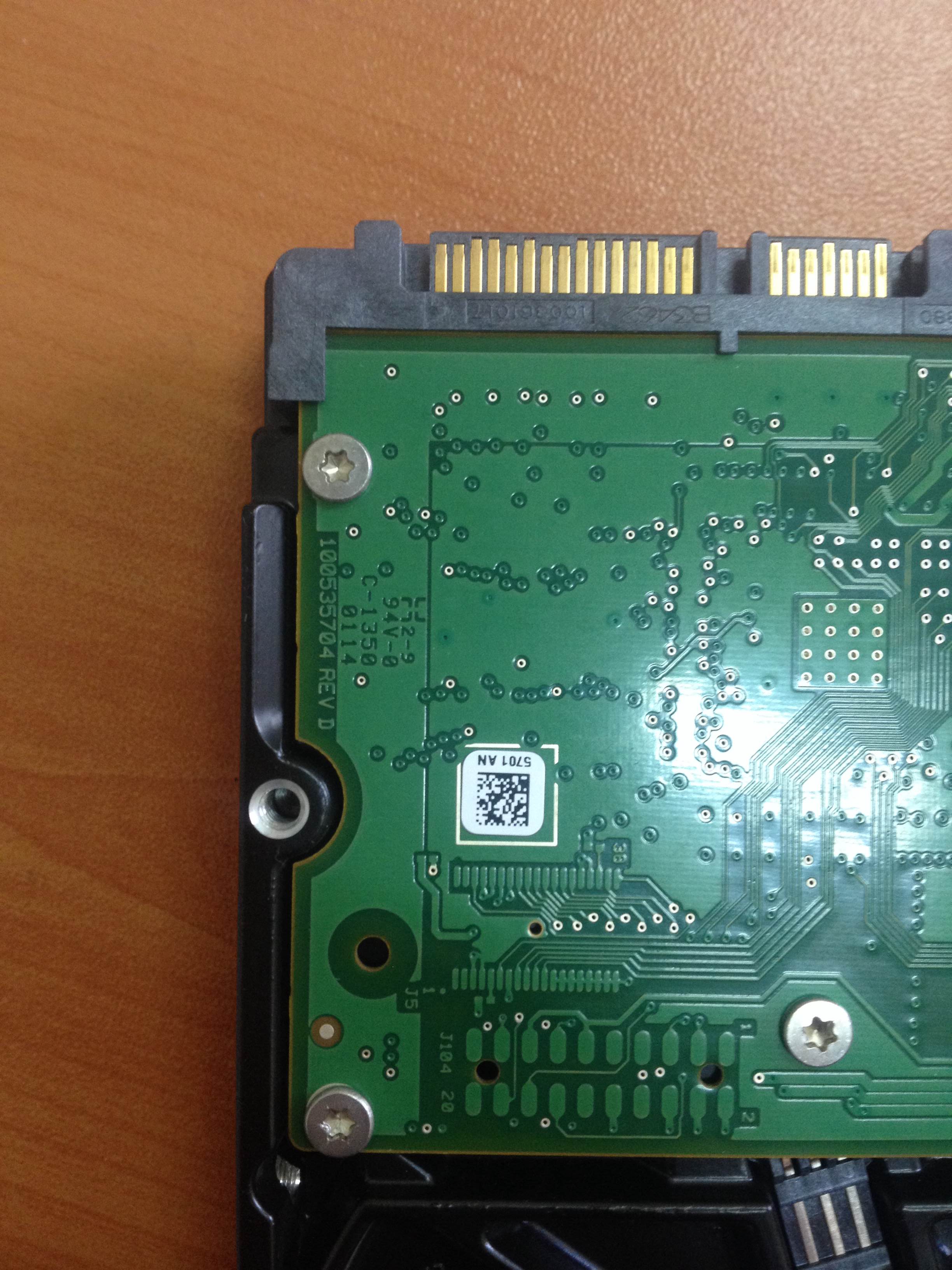

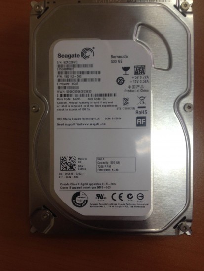

Hi, my HDD is Seagate ST500DM002. It sounds like it's spinnig normally but not detecting in both bios or disk management. Its PCB also looks like normal in both sides (no physical damage).
I've tried to change its PCB with same drive but no success. The donor drive's PCB is "100535704 Rev C" but mine is "100535704 Rev D". I wonder that what is my chance if I found the identical PCB with same Rev? or is there any other way that I can try? Thank you in advance.

@OP, you can't just cold swap these PCBs they have an adaptive ROM so even if it's a perfect match it'll still never work. With this particular model I'd say it's about a 0.01% chance that it's a PCB problem. Most likely it's failed read/write heads or a firmware issue likely relate to the media cache.
You'll definitely want to seek out pro help on this one. Not a model you want to attempt anything DIY.
