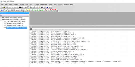

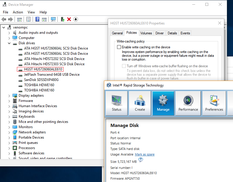

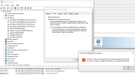

I have the odd issue on two drive one Toshiba 6TB and HGST Ultrastar 7K6000 6TB drive that I can't enable the write cache on these hard drives.
While the other 2 HGST Ultarstars same model and another 6TB Toshiba works perfect.
I have tried in Windows and Linux, changed the ports, cables plugged it into the connection where the other worked but no luck.
I have tested it on a Intel PCH X99, NForce, Intel Z170 they all fail to change the cache on those two drives except: ->
The only way I can active the Write Cache is when I connect it to my Adaptec 71605 Controller which is strange?
I have also tried with sginfo in Linux but it fails too..I power cycled the drive also but no luck
Are these drives faulty is there a way to reset the firmware somehow? I filled already RMA but not sure what to tell them.
Thanks for your help

I tried it with hdparm too. But the same result it echos it will enable Write cache but on the new line the switch is off.
Is there a way to read out the SCT Table?
I never mentioned it is a SAS drive :-D the specs I got from HGST support engineer obviously not knowing his own PartNumber and Serial Numbers.
So is there something else I can try? I used sginfo to change the value but it fails also..wenn using sginfo -cXR. Somehow the drive is in a strange state

When I enable the WCE (write cache) on the Adaptec and plug the Hard drive to the Intel it is sstill enabled and the outpute shows WCE is enabled.
I don't use the controller to enable the dfrives cache since it would require me to init the drive and all data is lost. So I just plug it into raw mode and enable Write cache of Windows or hdparm in Linux. Strange behaviour right?
The controller of Intel is configured as Raid and AHCI I tried both configs. I also switched the mainboard, chipset (7170, X99 and an old nForce).
But sginfo should work SATA too as far as I know and read.
