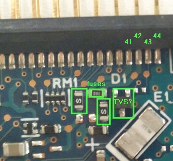

The "ROM" appears to be embedded within the MCU (88i6612-BCJ1).
IMO your best DIY chance would be to repair the PCB. There appear to be fuses at the bottom RHS of each PCB near D1 and E1. Can you zoom up this area of your board?

Here is a closeup of the old PCB around the area you suggested:
Can you please elaborate a little?

Measure the resistances of the two fuses marked "S". Also measure the zero-ohm resistor marked "000".
D1 appears to be a 5V TVS diode. Measure the resistance between ground and each of its pins.

Just measured the resistance of the fuses, all seem to be OK (close to 0 and I get the same readings for the respective fuses on the working board).
As for the TVS diode, are you sure it is actually a TVS diode (it has 3 feet, I thought they had 2)? Measuring resistance between each of the 3 feet and ground (pin 40/43 I suppose?) renders no reading whatsoever on both of the boards...
Any other ideas?

Diodes are sometimes packaged in pairs, ie 2 diodes in one package, with a common anode or cathode. Anway it appears that the fuses are OK, as you say.

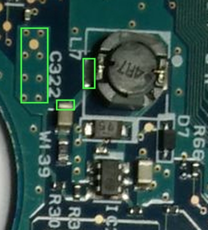

My next step would be to measure the voltages at the onboard DC-DC converters. I expect that the 4R7 coil (L7) would be part of the Vcore supply. Measure the voltage at this point.

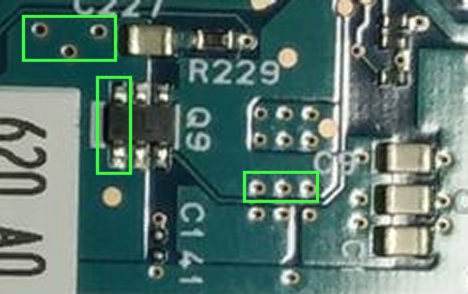

There should also be a Vio supply. Can you measure the voltages at Q9 (bottom middle of PCB)?

Can you blow up the areas around L7, IC24 and Q9?

Try to measure the voltages in the highlighted areas.
Set your multimeter on the DC voltage ranges (10VDC or 2VDC, as appropriate). Connect the black probe to the Com terminal and the red probe to the Volt/Ohm terminal. Place the black probe on a circuit ground, eg the a screw hole. Then place the red probe on each of the test points in the highlighted areas. I expect that you should find +5V, +3.3V, and approximately +1.2V.

OK, I finally got some interesting results:
1) All spots marked on the 2nd image (L7 area) read 1,17V on both PCBs, so we are OK there.
2) The 3 spots above Q9 on the 1st image read 5V on both PCBs
3) The rest of the marked spots on the 1st image (bottom legs of Q9 and the 3 spots SW of it) read 3,25V on the new PCB, but just 0,64V on the defective one.
Does that mean that Q9 is the culprit? Please say yes, it looks like one of the few components on the boards I am actually confident I could solder/unsolder :-)

Q9 is probably an NPN BJT transistor. It would be the pass transistor for the Vio supply. The Vio supply powers the 88i6612 MCU and SDRAM (IC21). The control signal comes from the TLS2291A motor controller IC. My fear is that the IC is faulty rather than Q9. :-(
I would now measure the pin at the bottom RH corner of Q9 (with the thin trace). That should be the base (control) pin. Normally it would sit about 0.6V higher than the output, so we should expect around 3.9V. Just be very careful not to short the adjacent pin with your probe.
Next, with the power off, measure the resistance between the base pin of Q9 and ground. This will test for overloads. Use the 200 ohm and 1K ranges.
Now perform a diode test (on the diode range, with power off) between the base pin (red probe) and the 5V and 3.3V pins (black probe). Then reverse the probes and perform the same test. This will test whether Q9 has failed.
