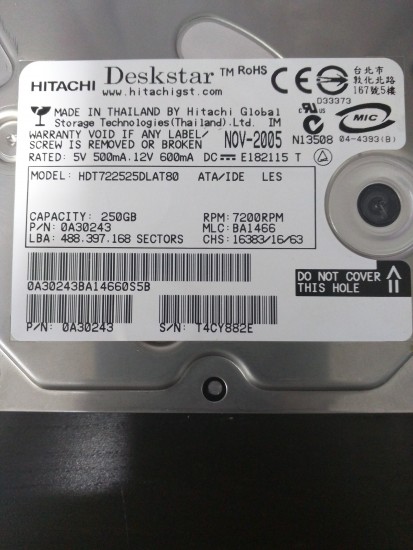

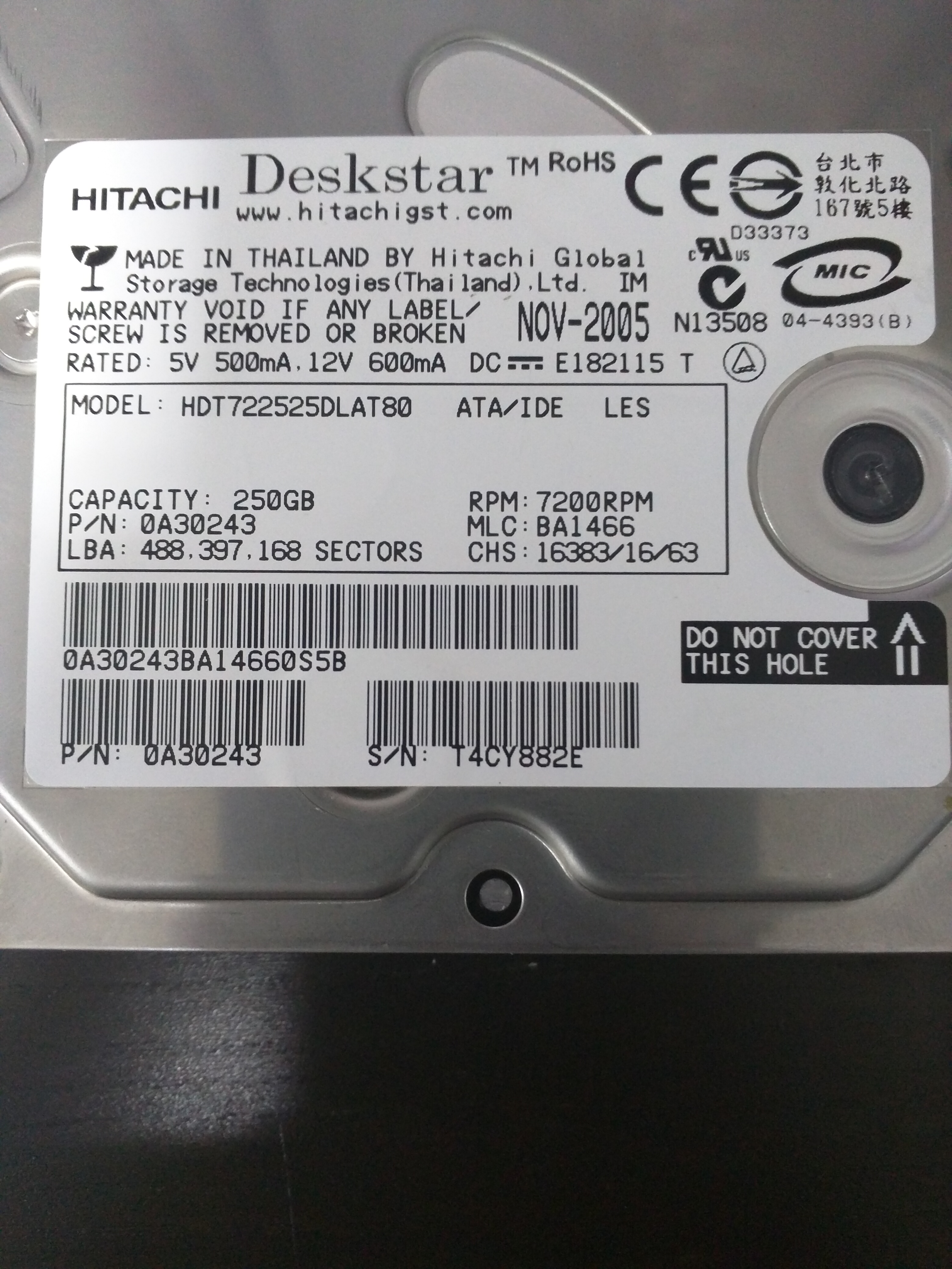

 Post subject: HDT722525DLAT80 NV-RAM ERROR.
PostPosted: December 4th, 2015, 13:24
Posts: 413
Can anyone provide me with the NV-RAM file for this disk ?
USAG module also fails to read. :(

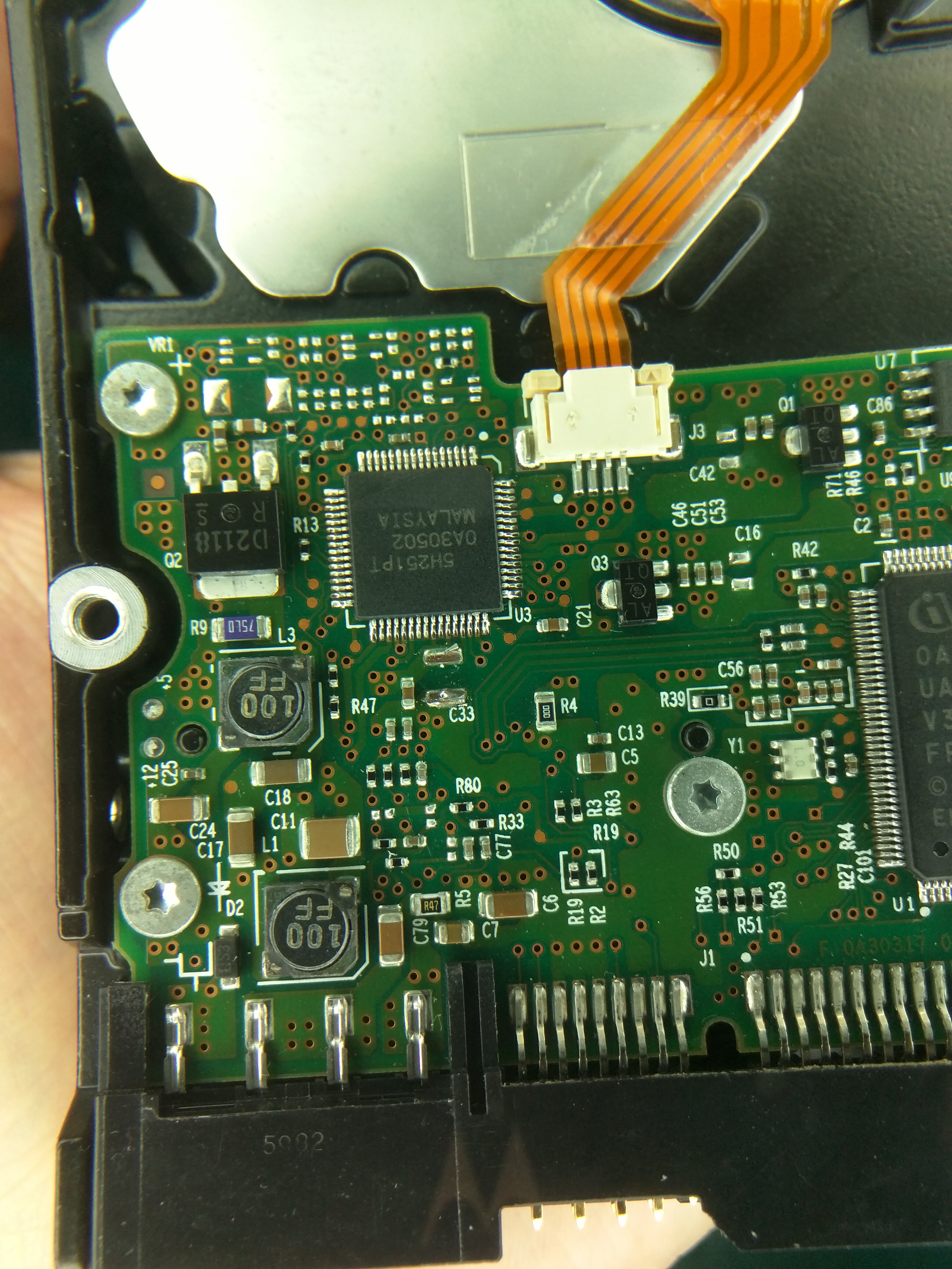

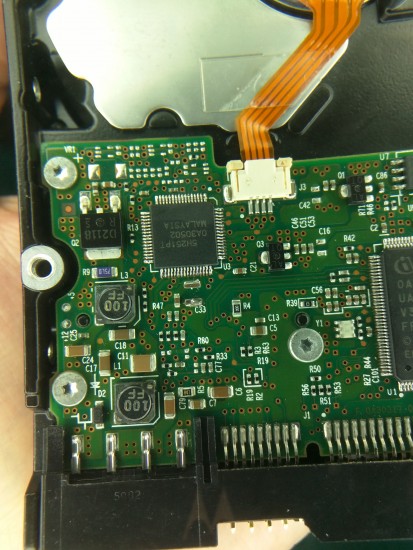

So i got back today, only to find out that:
All modules fail to read, ATA1 fails to initialize the device.
Can't load Teachkey, can't load NV-RAM, nothing.
 Post subject: Re: HDT722525DLAT80 NV-RAM ERROR.
PostPosted: December 7th, 2015, 14:14
Posts: 413
Spildit wrote:
Were you able to read NVRAM to start with ?
Does your pcb have external ROM as well ?
No, I couldn't.
Yes it does.
Please pay attention to C33, it looks damaged.
PostPosted: December 7th, 2015, 14:31
Doesn't look damaged, it looks missing. :D

I have the same model drive here and the missing C33 capacitor is the same physical size as C11 but on my drive it is a darker brown colour. C11 is lighter brown colour. That may or may not be important.
PostPosted: December 7th, 2015, 15:16
Posts: 17232
Measure the voltage between the pins of C33. If it is 18V or so, then it is the boost capacitor for the VCM servo.
FWIW, the L7250 SMOOTH datasheet specifies a 330nF VBOOST capacitor. I don't know whether the smaller capacitor to the left of C33 can cope on its own. If not, then I would expect instability in the servo.
PostPosted: December 7th, 2015, 16:20
Posts: 17232
The headstack would probably still move, but it may not lock onto the track reliably. The boost voltage is required for controlling the drive to the high-side MOSFETs. The drive to the low-side MOSFETs would still be OK. I'm not completely certain, though.
In any case, I could be wrong about the function of C33. It may in fact be bypassing the +5V or +12V supply to the motor controller, in which case its absence would not be super critical. Perhaps dick could confirm the voltage on his PCB.
PostPosted: December 7th, 2015, 17:53
Posts: 927
Location: uk
Happy to oblige.
So it measures 11.89v across the capacitor.
12v rail direct from the psu reads 11.94v
PostPosted: December 7th, 2015, 18:12
Posts: 17232
It looks like C33 may be the bypass capacitor for the low frequency noise on the +12V supply. The smaller capacitor would then be filtering the high frequency noise. A continuity test between the +12V terminal of the capacitor and the +12V input to the PCB would confirm this beyond doubt.
PostPosted: December 8th, 2015, 4:05
Posts: 927
Location: uk
As expected NO noticeable resistance was measured.
