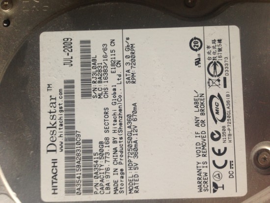

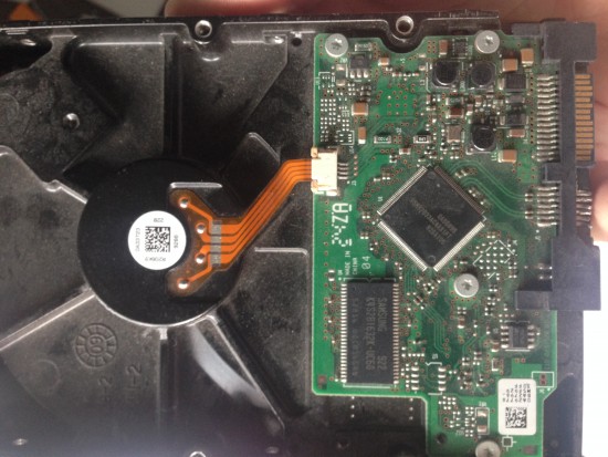

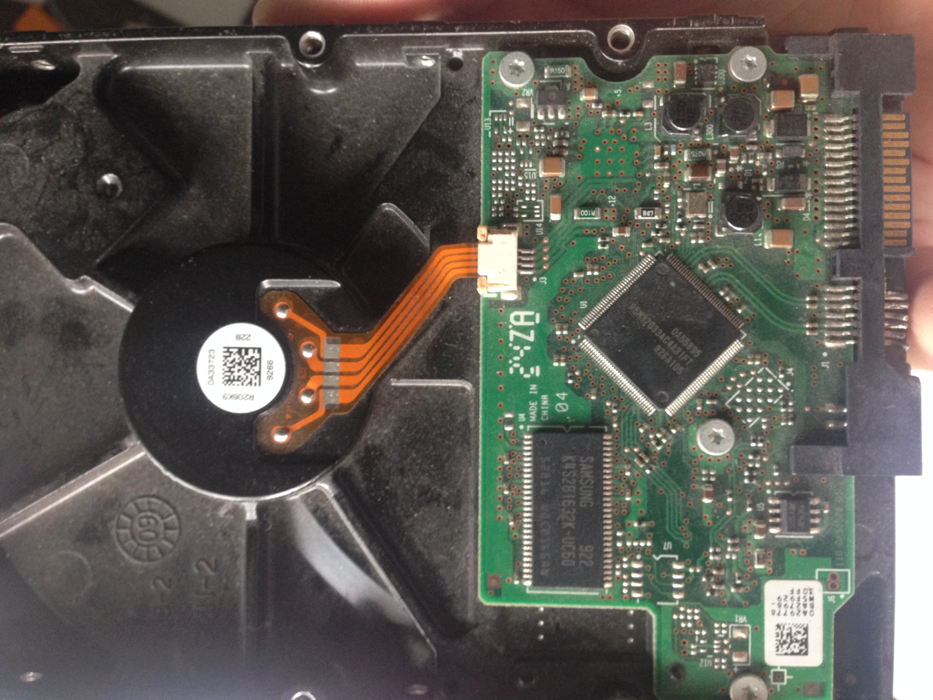

Hey Guys,
I have a Hard drive which I broke a few years back, recently I've been motivated to get all that data back since another failure.
In this instance I broke the SATA port by pushing it too far into my video card when installing... very depressing times.
As you may be able to see my friend tried soldering it onto a SATA sable.. his presumed skills were way under par.
I've found a PCB replacement near me on Ebay:
http://www.ebay.com.au/itm/HITACHI-Hard ... Sw~OdVcEt4
But apparently I need to swap the Bios chip?
Before I buy the part, does anyone know how to do this, and could I do the work myself?
Cheers.
 Post subject: Re: Hitachi Deskstar 0A35415BA28310C97
PostPosted: December 8th, 2015, 4:43
Posts: 3977
Hi, I can do it for you, I am in Adelaide. I can recover as well and copy to another media
PostPosted: December 8th, 2015, 9:33
Posts: 17232
The following supplier charges US$50, including a free firmware transfer:
http://store.yahoo.com/yhst-14437584971 ... 41823.html
PostPosted: December 9th, 2015, 2:58
Posts: 3977
If you were going to supply the board and media to copy data onto if you wanted that, then just the actual shipping cost back to you is all. Not a bad deal from the Canadian site either.
