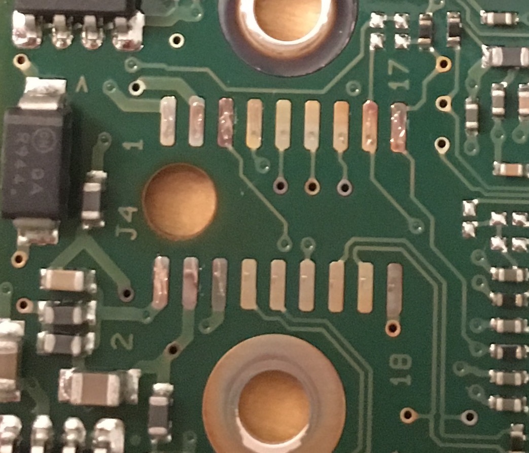

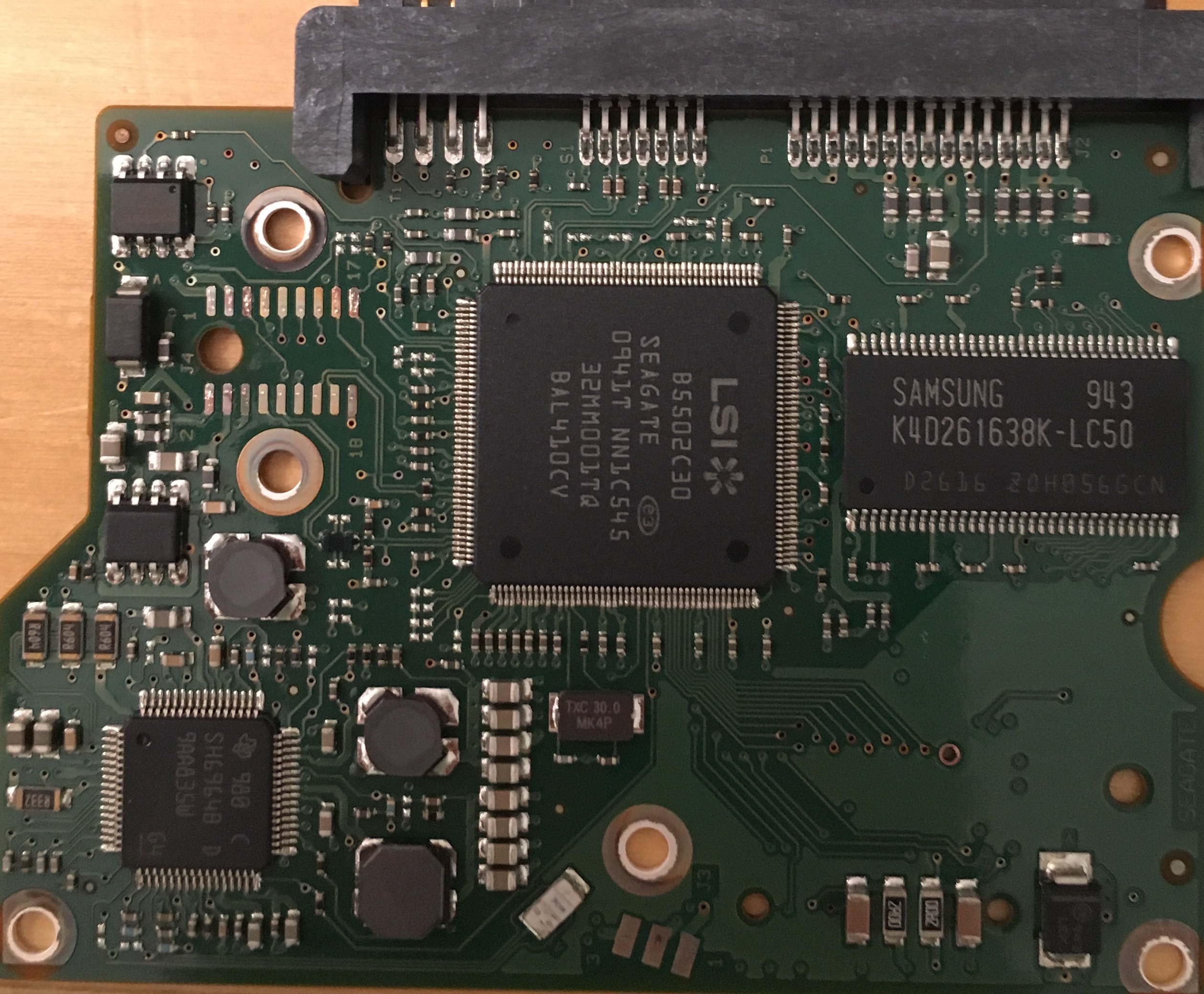

Hello folks,
first the HDD was BIOS recog. after a restart of the computer it was not recog. anymore. No spinning up - completely silent.
Seagate Barracuda 7200.12 500 GB - FW: CC45
bsy bug?

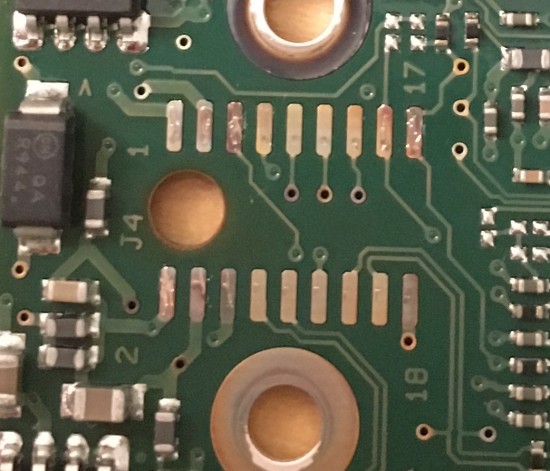

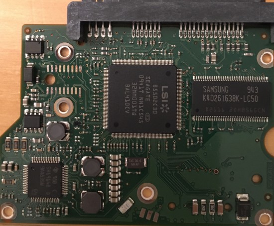

corroded contacts? -- attachment
any DIY recommendations? ;-) RS232 TTL adapter I have.. already reanimated 2 Seagate HDDs with that. But in that case I won't do anything wrong.
Best Greetings
Benjamin
File comment: pcb overview
File comment: corroded contacts

If it's not spinning at all and silent then the PCB would be the first starting point.
First check the TVS top left of the PCB, if that's OK then get a new PCB of same P/N and you MUST swap the 8-pin "ROM" chip top left. Careful though, if you damage that you're in BIG trouble!
Good luck.

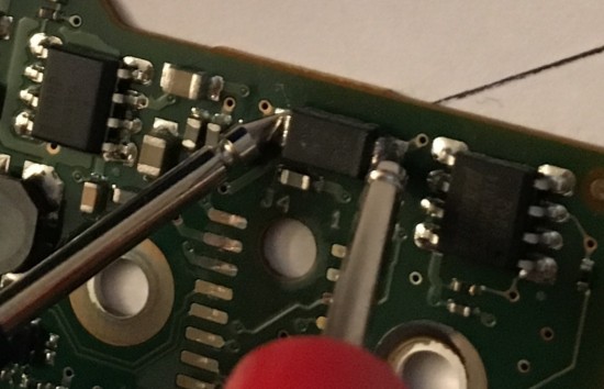

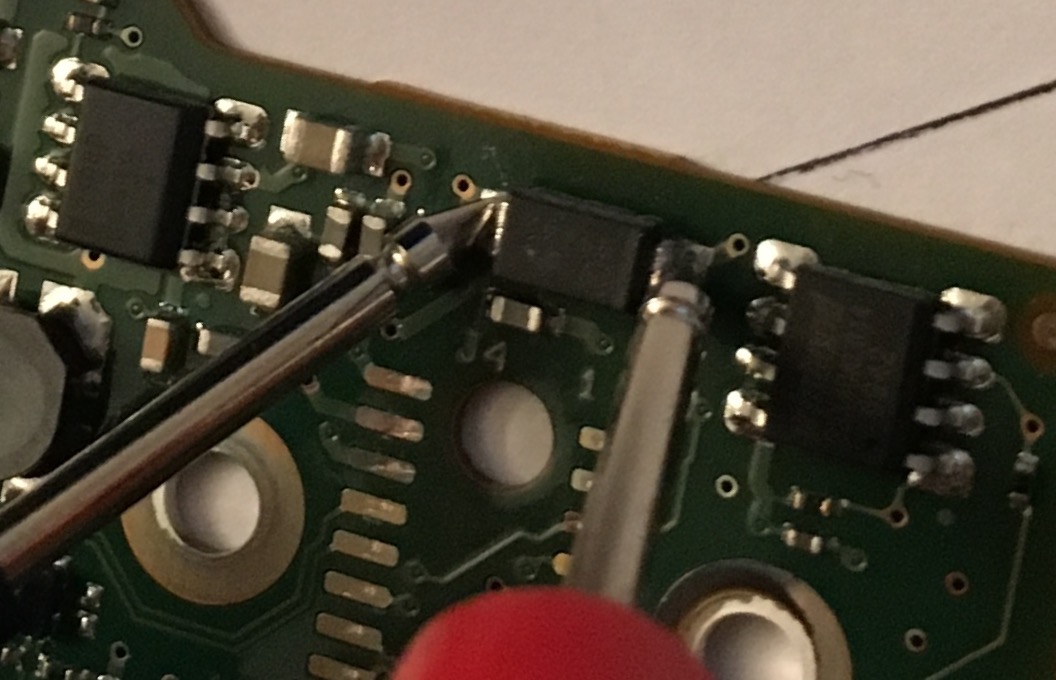

That TVS is driving me crazy... i have to put very much pressure on a specific point with the COM (black) cable to get 0 OHM. Next time I try it pressure doesn't help... next time I get 0 Ohm again...
I'm only at the beginning to check a Diode correctly.. any recommendations?

Acutally I need help in that case here... the 5 V TVS is high-ohmig in both directions. above 130 k in the direction I meassured it (see the picture above)... an 65 k in the other direction

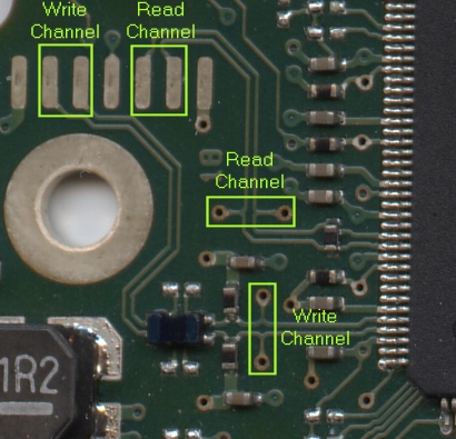

I have the exact PCB layout like in the attached picture
http://www.hddoracle.com/viewtopic.php?f=24&t=123&p=149
then I found this manual:
start your drive by shorting read channels
F3 T>/2
F3 2>Z
Spin Down Complete
Elapsed Time 6.035 secs
[Remove the shorting and give following command]
F3 2>U
HighPowerMode
ExecuteSpinRequest
Spin Up Complete
Elapsed Time 3.573 secs
F3 2>/
F3 T>m0,2,2,,,,,22
Max Wr Retries = 00, Max Rd Retries = 00, Max ECC T-Level = 16, Max Certify Rewr
ite Retries = not supported
User Partition Format Successful - Elapsed Time 0 mins 00 secs
F3 T>/1
F3 1>N1
Clear SMART is completed.
F3 1>
[disconnect the power, wait couple seconds and connect again]
Rst 0x08M
(P) SATA Reset
Should be careful about that?
Wouldn't it be dangerouse to use the same procedure for a 7200.11 drive on a 7200.12 drive die to the Non-Resident G-List issue ?
Answer: Not always, it's danger only if NRG is filled with some entries, if is empty it's ok to regen translators (m0,2,2,,,,,22).
You may check if NRG is empty with V40 command.
like in that post:
viewtopic.php?f=1&t=18907&start=40
Can I do any harm when I short circuit the Reading Points in the picture and get terminal access.. when NRG is empty can i regen translators?

measuring 100 ohm in the read cirucit - and 50 ohm in the write circuit... so the points should be the right ones? Just double-checked it and compared it to the pictures in the hdd-oracle thread.

Decided to let the ROM transfered (soldered) to a new PCB.

Try with the new PCB with ROM swap. If drive still doesn't spin check TTL log with PCB.
That I will do let do ;-). Thanks for support.

The last two posts doesn't belong there. The issue was resolved by donor board and ROM transfer.
