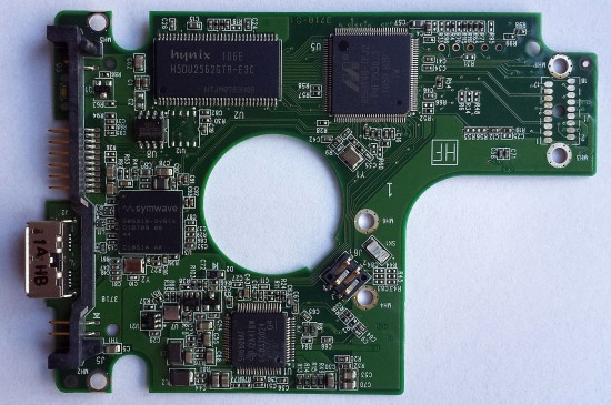

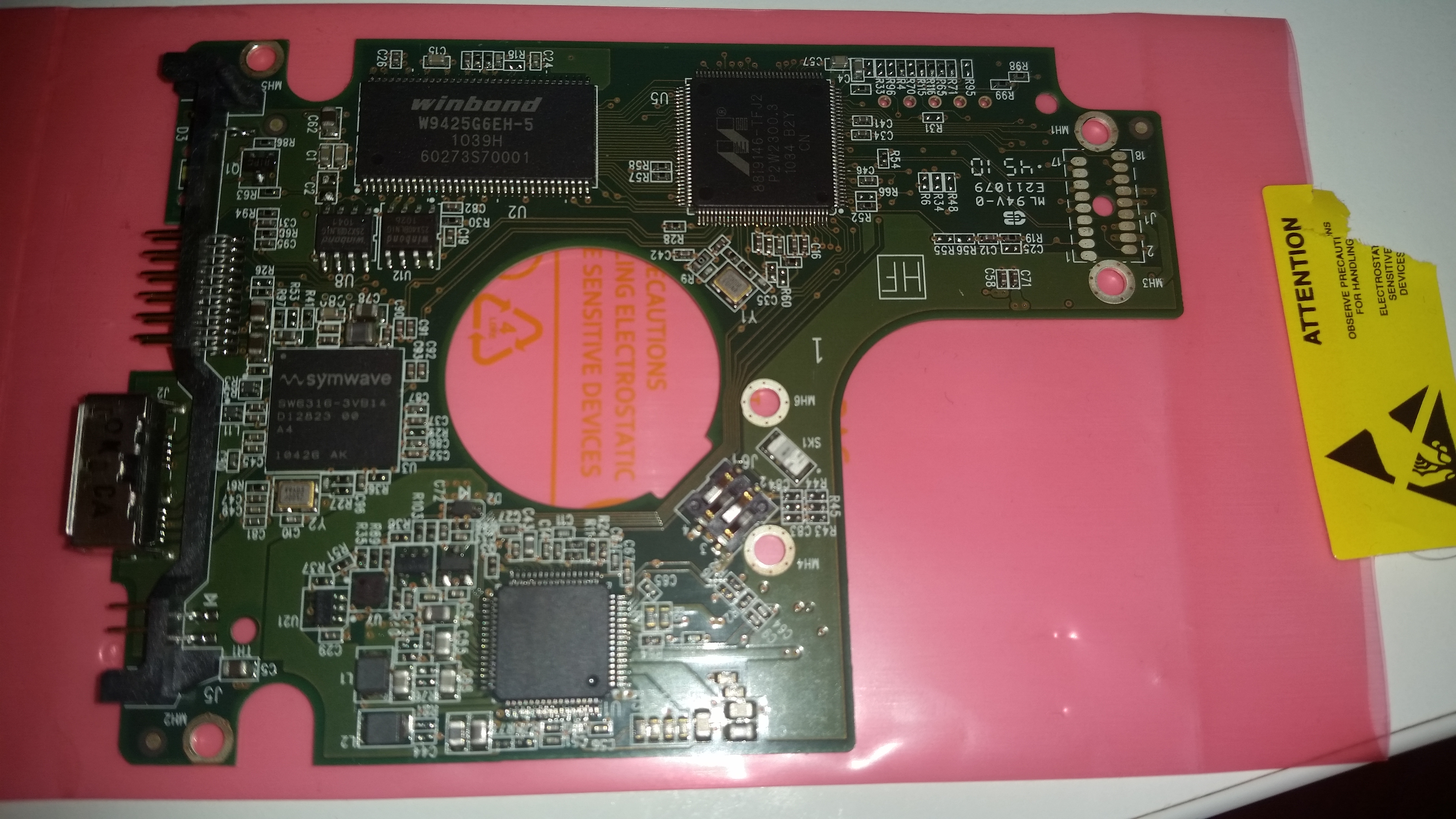

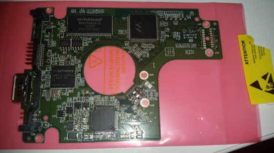

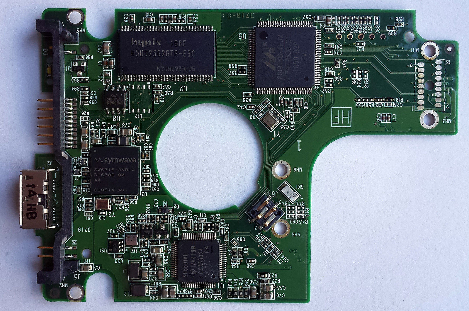

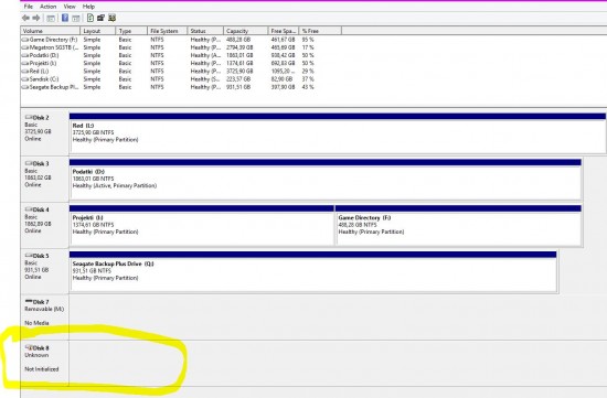

2 weeks ago my old Passport 500gb drive 'died' 'WD5000BMVW-11AMCS0' Model .. After further investigation, I came to the conclusion that the PCB is faulty (PIC PREVIOUS PCB) the light wasnt going on or anything so I ordered another one from ebay with the same fw version and everything.. however the pcbs/chips are not exactly the same as you see in the pictures the U12 CHIP near the u8 is not situated on the new board.. but after succesfully replacing them my windows actually detects the drive as MY PASSPORT 0732 and AS A NON INITIALIZED DISK IN DISK MANADGEMENT. Since I have some very valuable data and projects on the drive and with computer knowledge I know that now I mustn't initialize the disk. I tried to find/restore/recover the partition with a lot of recovery programs such as paragon, easus, wizard but none of which sees and finds anything..As you see below this is it.
I watched some videos on youtube and tutorials saying that some disks from WD need to replace the ROM from one disk to another but on some PCBs.
Can you tell me from the pictures I've send if this is my case 2 ? And what would be the best options for me? We dont have any bigger disc recovery companies here in our country so I'm on my own and rely on your help here guys. !
File comment: OLD 'DEFECTIVE' PCB

File comment: NEW PCB

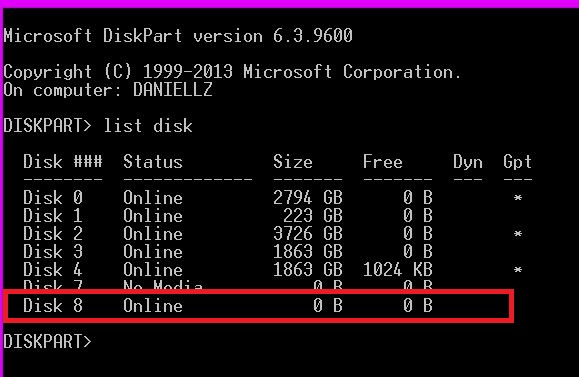

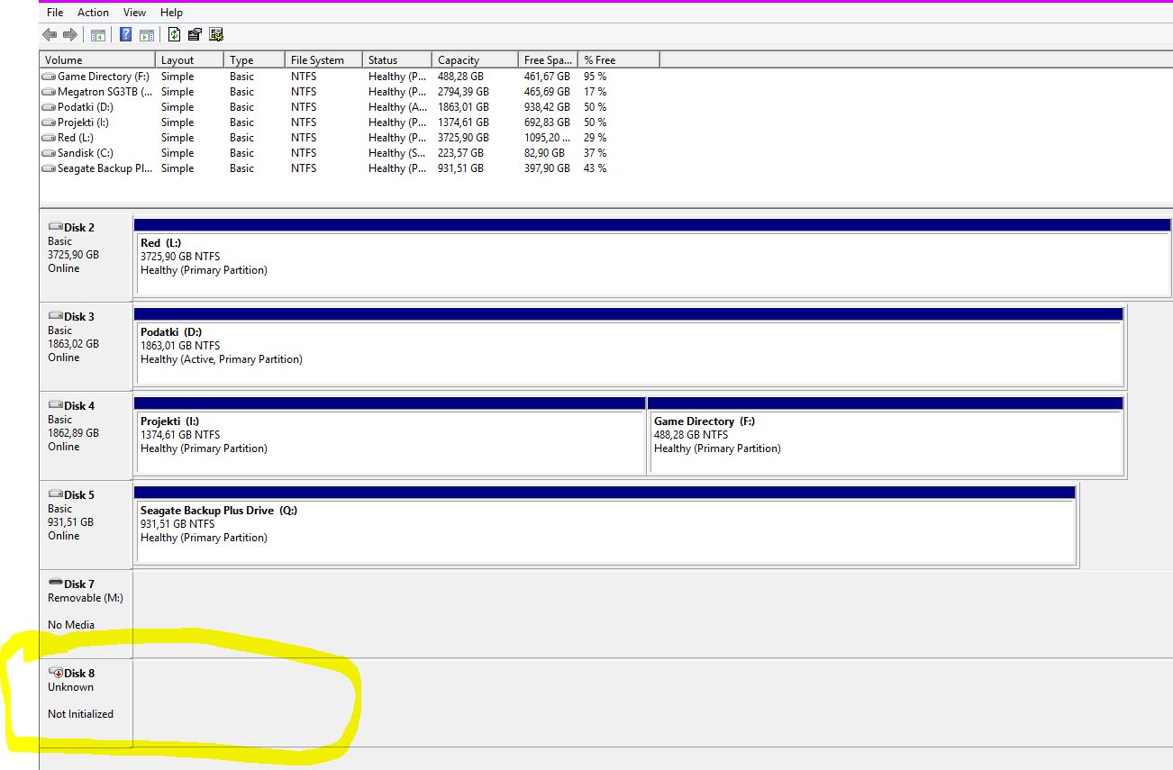

File comment: status2

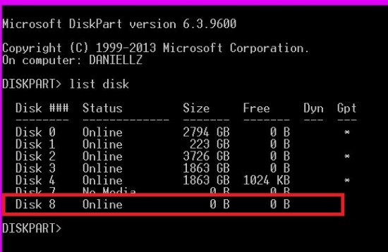

File comment: status1

First off, with any WD drive made this decade you always, absolutely always, need to transfer the U12 chip as this contains the adaptive ROM code which is unique to each individual drive. If you want to know if your PCB is even compatible after the swap though, all you need to do is flip it over and read the number printed in the board that's something like "2060-771692-001 REV P1" and be sure it's exactly the same as the original one.

WellI dont think I have the apropriate tools to replace the u12 chip.. maybe any tips about that? ..
The serial on the back is actually almost the same.. just the rev on the second one is P1 on the new one is A.. however the number and everything is the same...

what happened to the U12 on new PCB ?
you can try to ask the electronics repair shop in your area to do it for you
but you can ran into other problems, like firmware, preamp...

I can only assume that the donor PCB has had the U12 removed in preparation for you to solder your own chip on, from your drive.
This absolutely MUST be done.
BUT from what I've just read in between posting this message and editing it, it's almost certain that the PCB is NOT your issue. It could be that the connection to the USB is bad, in which case the new PCB would resolve that, but it's a long shot!

Since the mini led light right by the usb on the older PCB is off while on the new one it is always on.. just when I safely remove "My Passport 0748" it starts blinking so I can remove the cable. Thats the first reason and the second one is also I forgot to mention that when I had the old pcb the drive was displayed in windows as 'wd passport bad pcb' which is the prof that the PCB is the problem. Now its displayed as non initialized 'My Passport 0748' The drive doesnt have any stange sound or clicking in it..
I assume that the new pcb has the u12 slot empty to solder the smd on it right by yes. But I have another question. I will need to solder the u8 chip to or it has to be the same?
A recovery specialist told me by mail that: "On PCBs with a USB interface, you must swap both the u8 and the u12 chips."

Well, few reasons:
1) "bad pcb" as a message does not exist and more than likely whatever message the operating system did provide it may be misinterpreted.
2) statistically, 90%+ of scenarios resembling your drive's description do not involve a PCB failure
3) based on countless of PCB related activity of various brands, families and models of drives, a PCB failure should cause a different behavior in this drive.
Could there be an exception? Sure, it is possible.
