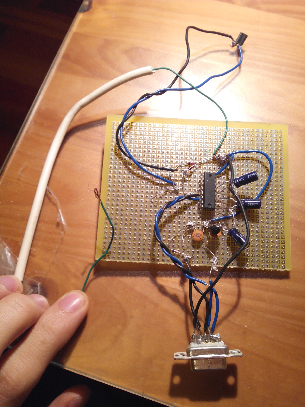

5 years ago I built the RS232-TTL [url]hddguru.com/articles/2005.10.01-Seagate-RS-232-adapter-schematic/serial_max232.gif[/url]; loopback tests with it work fine.
I connected it to the HDD. TX-RX voltage is 1.3V. The HDD tells me the following and doesn't accept Ctrl+Z/ any key input

AFAICT, the voltage levels should be 2.5V LVTTL. That's the supply voltage spec for the Winbond W9412G6JH SDRAM, so I'm thinking that should also be the MCU Vio voltage.
They are.
(I meant they are 1.3V with variations when the RS232-TTL CIRCUIT IS ATTACHED)

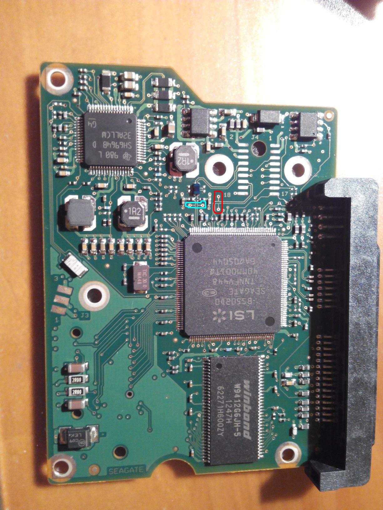

I intend shorting the pins, but I haven't found yet information 100% specific to this HDD. Which ones in picture: red and/or blue one? Should I do it after Servo errors stop appearing?
red
after spin up

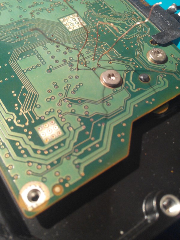

I tried shorting channel contact without any result, still no reply to CtrlZ commands. It seems the firmware is seriously locked... The TTL circuit works flawlessly in a 7200.11 HD, but maybe I should remove the resistor or something... In a couple days a new TTL cable arrives.
Also I don't like the noise when it spins...

I have tried shorting the read and/or write channel dozens of times, at different moments, for different periods of time. With my circuit and with a usual Chinese USB to TTL cable.
