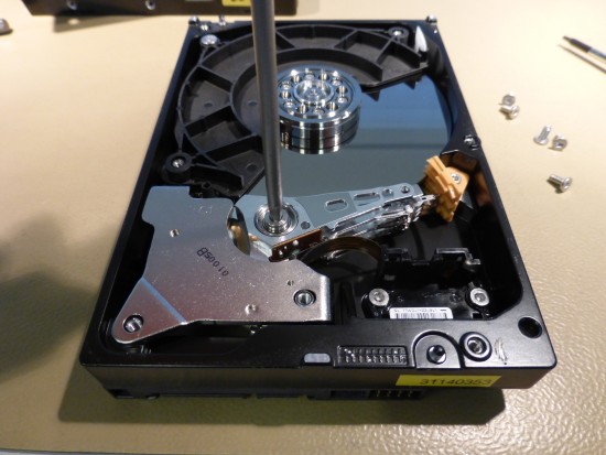

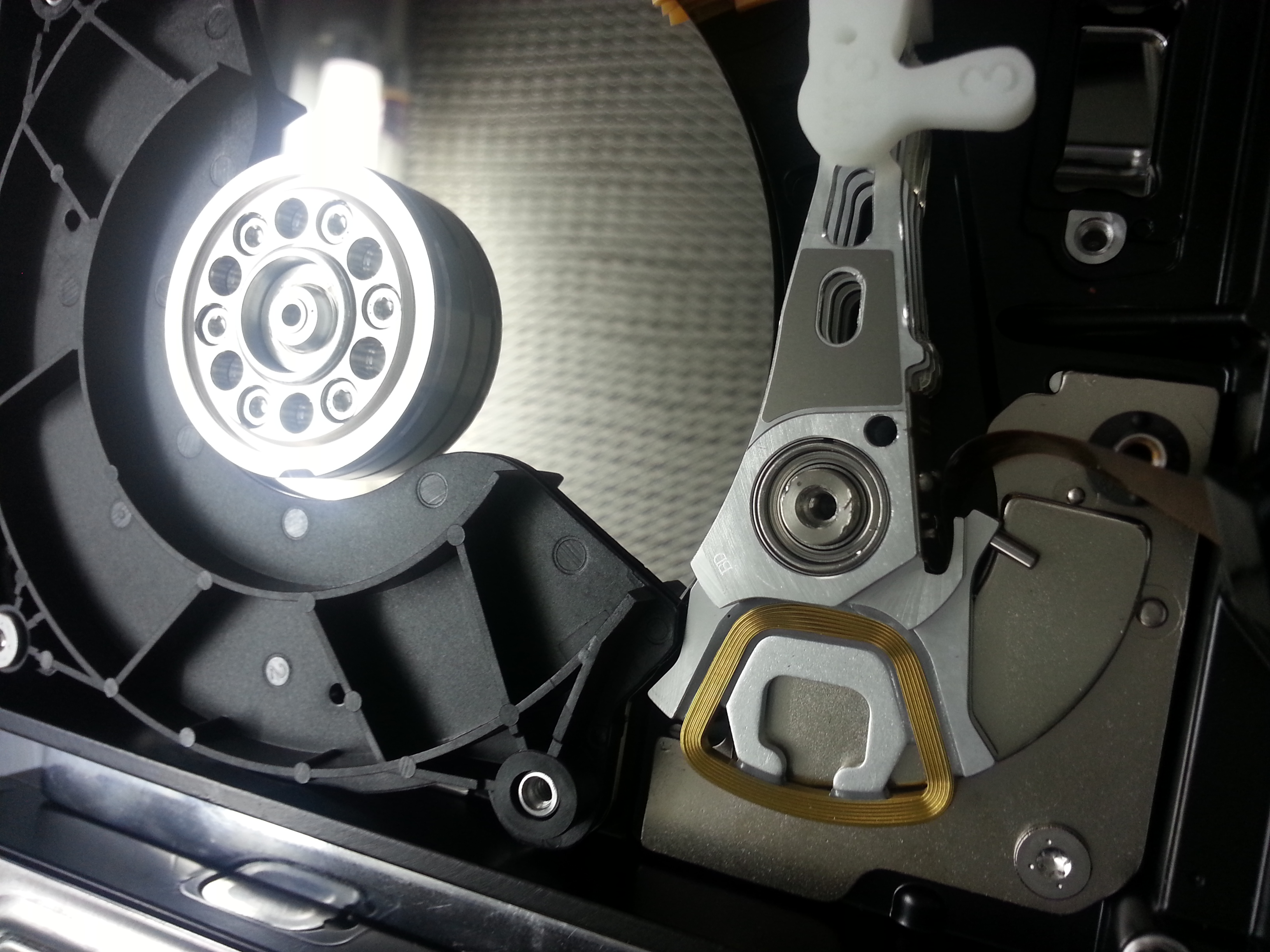

Hi to all
i have this drive (WD1003FBYX)
see the pic's on this website
http://product.pcpop.com/000286892/Orig ... 94820.html
This is first time i have same this module drive ..
i want to change it's heads .. but this problem is i can remove the head out ?!
and i have not seen any screw ...
please help me
thanks

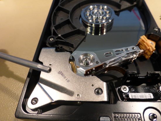

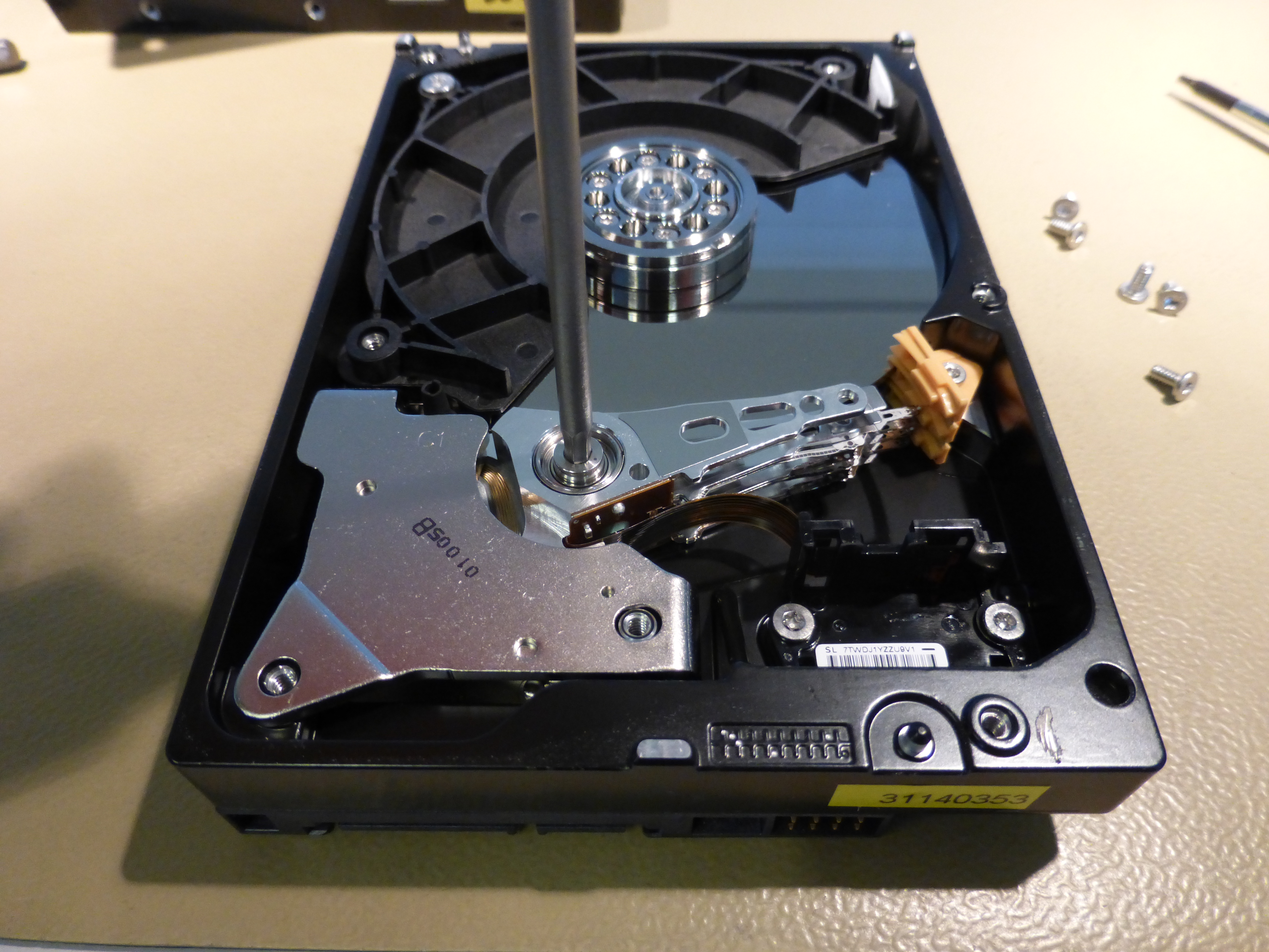

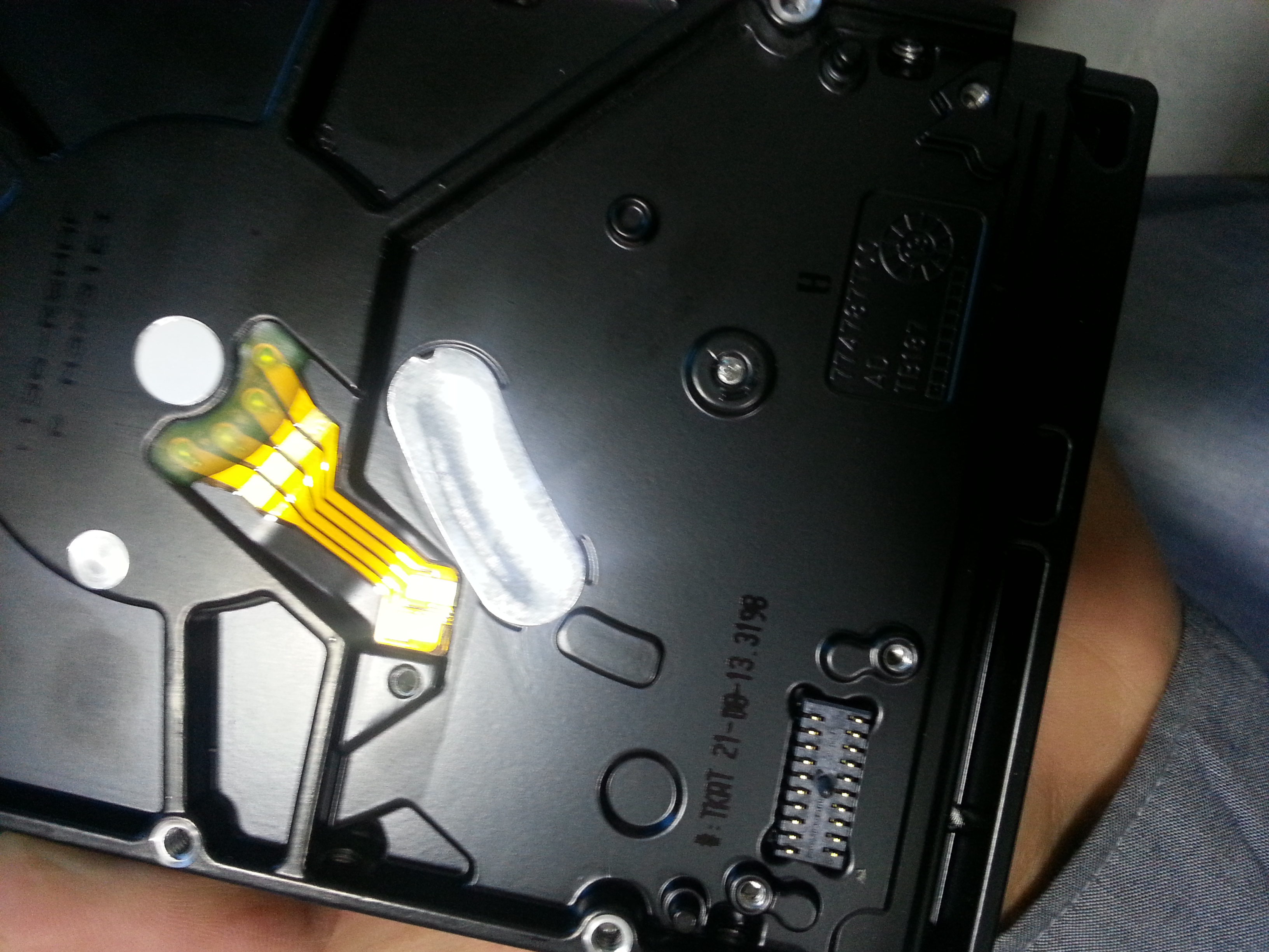

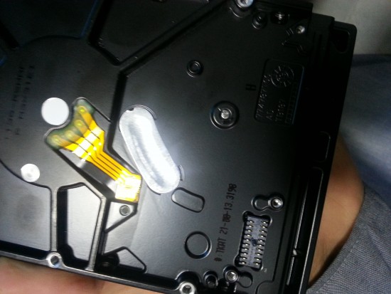

Sorry ... i can open the drive and i can do head swap .. but this drive i can't remove it up .. that what i mean
this is my first time face this drive please have a look for that pic ..
thanks to all

1 head is not reading ..
is there anyone work on same this drive before ?

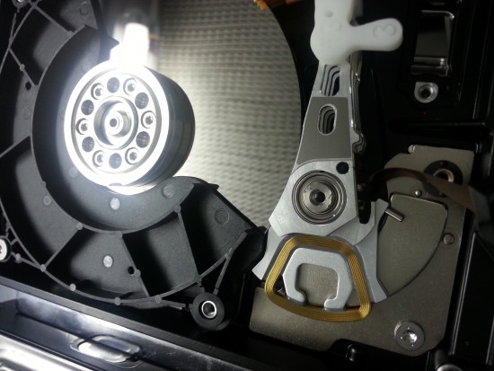

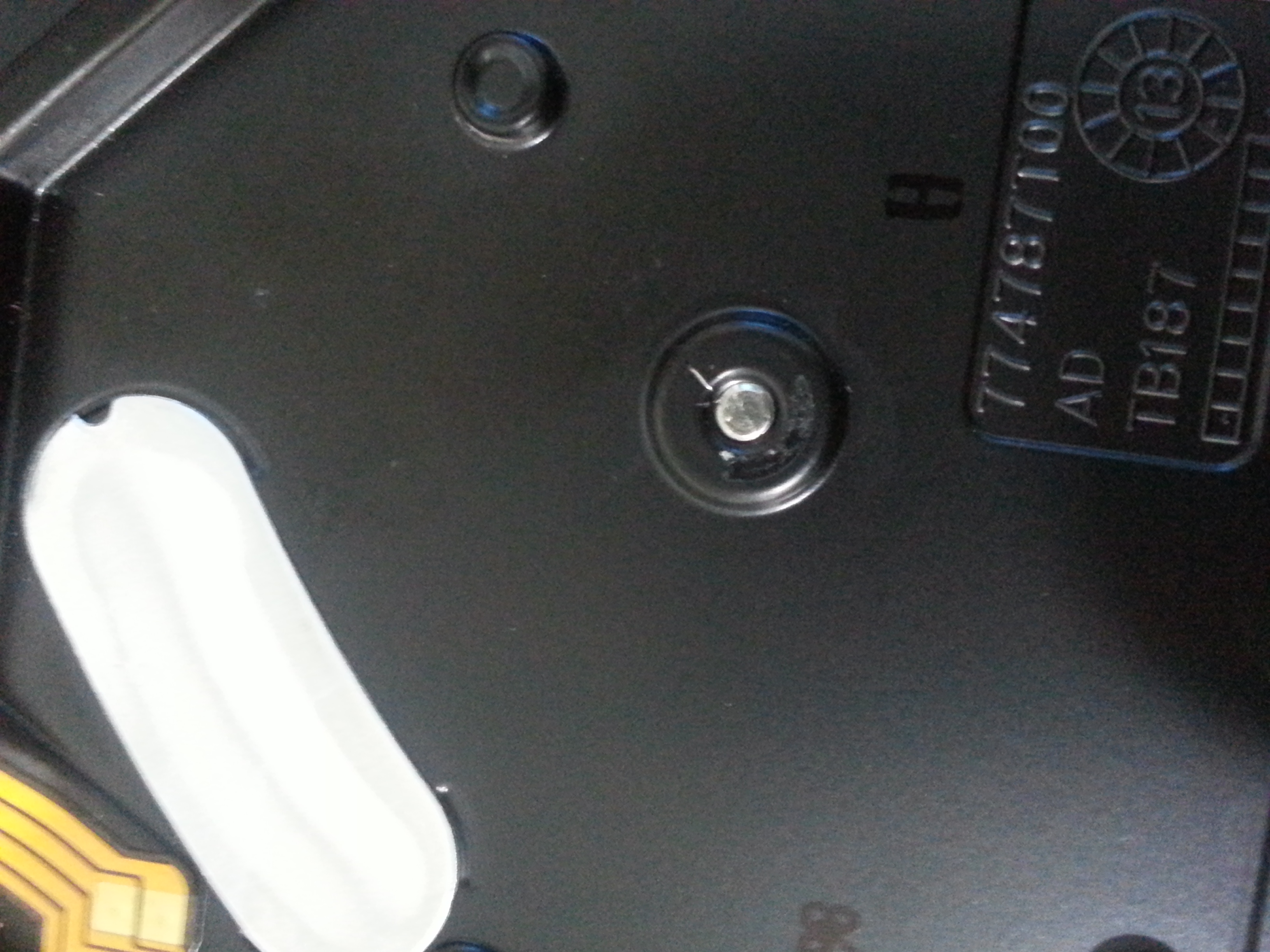

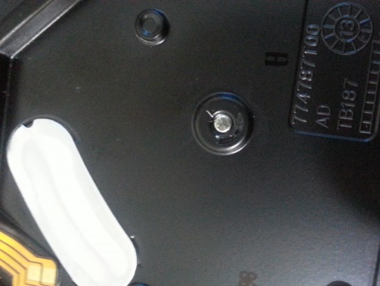

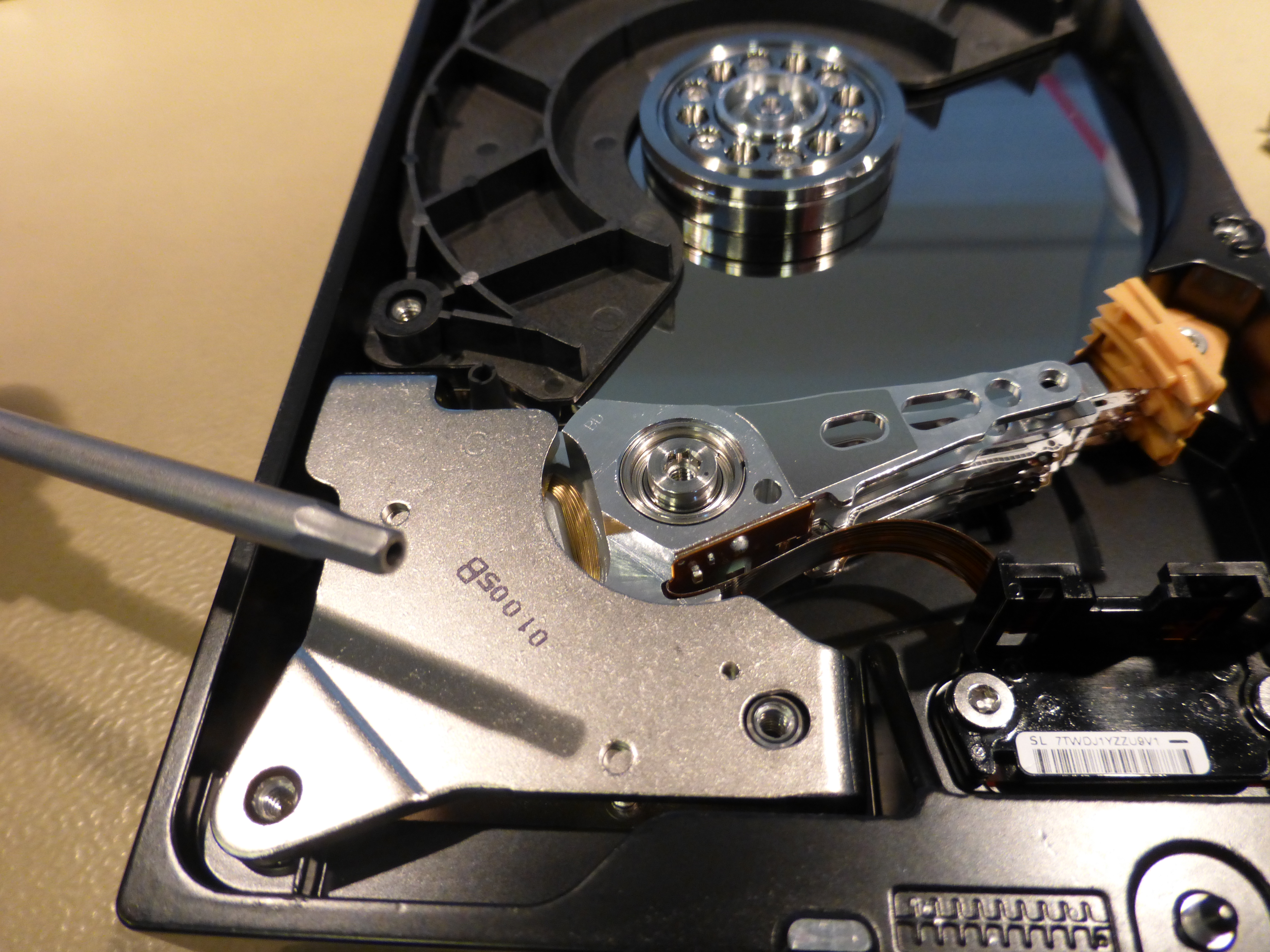

Could you give more information about the problem, anyhow i won't suggest you to open the drive nor change the heads, but at least we can try to address what it might be the problem.
 Post subject: Re: Please Help me .. i will give gift for who will help me
PostPosted: December 17th, 2015, 7:02
Joined: May 9th, 2012, 7:55
Posts: 121
Location: Western Europe
Using a Torx screwdriver you can take the heads out

I hope none of the metal shards from using pliers or vice-grips fall someplace they shouldn't. Good luck, hope you can get there in the end
