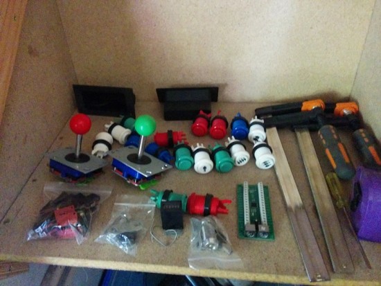

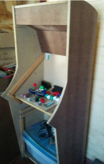

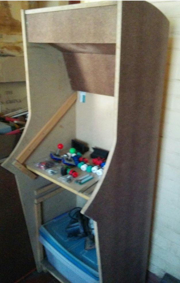

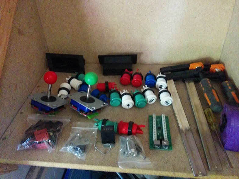

here is my arcade cabinet in the works, in it is going Ultracade guts...

cabinet is having an x86 PC running Ultracade. Nice work on the XBOX, don't you love how things start getting REAL technical? I was reading the thread and it just gets deep. fast. Looks like you have a pretty helpful mod going on there!
