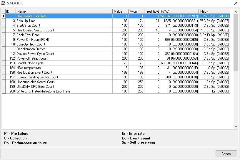

Hi Guys,
If you are here, thank you for at least taking the time.
I'm a computer technician for ~16 years. I'm no failed-drive data recovery expert as my policy is backups, so I hardly deal with recoveries on faulty drives. I have done a few board swaps (transfering firmware) with success, but thats about it. At least I'm familliar with some of the concepts and what not to do.
I have in front of me a customer drive that I sold him November last year to go in his Macbook Pro. The drive failed since. He usually does time machine backups, but last ran it Dec 26th 2015. Unfortunately when I tried to restore the backup, I noticed that the backup didn't finish (it backed up almost nothing), and to my surprise, there are no previous backups all of a sudden (I'm not sure if he started a new backup or wiped the old files or what). While I might be able to get something off the time machine drive still, I'll get back to it later.
As for the drive that failed, it's a Western digital 2.5" WD10JPVX 1.0TB drive.
When I plug the drive in to a workbench pc, it works - I can mount it and read the directory structure, but at some points it freezes and I have to wait a few seconds to a few minutes before the command completes. When I transfer a file, it reads for a bit, then transfer rate hits 0.0Kb/s. Sometimes it picks up to 130Kb/s for a few seconds and returns to 0.
Using HDTUNE to get to SMART it yields nothing out of the ordinary that I can see.
So far I've been using unstoppable copier to get some of the data off. I got all the emails, pictures folder, music folder, videos folder, but the Desktop (which also has some important documents etc) and Documents folder is proving difficult.
I think there's a chance of getting the data off, but I'm unsure how to proceed and would appreciate some direction.
I haven't opened the drive or anything. It's exactly as I got it. I only tried pulling the data off with tools like Unstoppable Copier and ddrescue + rsync under linux. I haven't done anything to write to the drive like running checkdisk etc. Lastly, I cannot image the drive. It stopped at around 8gbs of data. I decided to rather try and focus on the little bit of data I still have to copy, but am starting to reach my limit.
Sound wise, the drive isn't clicking or anything. When data does read, I can hear a slight movement from the head, then pause, till the next movement and data comes throuhg.
Last note, by unplugging the drive (which isn't warm when I unplug it) carefully, letting it rest for a while, and then plugging it back in after a few minutes, it seems I can get some of the data off - it reads briefly after being plugged in, but I'm worried that I'm exposing the drive to needless mechanical stress and botching the recovery before it's had any use.
Thanks again.
Edit1: Forgot to mention, I removed the daughter board and made sure the contacts were clean (no corrosion/moisture) already. Couldn't see anything, and cleaning made no difference.

Spildit wrote:
Yeah, sounds like "slow responding" fault, usually triggered by excessive read errors.

pcimage wrote:
Yep, could also be result of a weak head (s) giving those errors.

Thank you all for the responses!
I read about "the slow issue" but wasn't sure, so thought it best to ask first.
The symptoms are the same. What I'm not sure on is what software can I use to dump the firmware? The article mentions WDR, but three letters doesn't work well with Google :/

Update, used WD Marvel to pull some info off the drive:
Format version = 0x0002
Controller firmware version = 16.56G
Servo firmware version = N0.38
Overley firmware version = 16.57G
Surface format version = A1.A05
Read channel firmware version = G.00066A
Media count = 2
Physical head count = 4
Used head count = 4
Used head map =  0 1 2 3
Drive type = Mobile 2.5 Inch
Zone count = 61
Servo wedges count = 296
SA track count = 256
Spindle motor RPM = 5419
UA track count = 0
Cylinder skew = 31
Head skew = 78
Cluster Skew = 112
Code Residence = 5
PCBA type = Entek
Interface type = Serial ATA
Installed memory = 16Mb
Parts info
Controller chip Vendor = 0x0000
Controller chip rev = 0xA5C0
MicroP Vendor = 0x0000
MicroP Rev = 0xA5C0
Channel Chip Vendor = 0x00E9
Channel chip Rev = 0x0021
Preamp Vendor = 0x0000
Preamp Rev = 0x0000
Power IC vendor = 0x0000
Power IC Rev = 0x9022
ECC correction info
No. of interleaves in OTF ECC corr = 0
Number of bytes corrected by OTF = 0
Number of bytes corrected by FW burst corr = 0
No. of ecc bytes in read/write long sector = 0
Format info
Tracks per inch (in KTPI) = 0
Area density = 504Gb
Drive Format Type = 0
Media manufacturer code - A
Head manufacturer code - B
Drive config
Format version = 0x0300
DCM Selection = 0x0001
cur_stroke = 0x0001
used_heads = 00004
phy_heads = 0x0004
max_fmt_LBAs = 1971279072 - 1009Gb
max_target_LBAs = 1953525167 - 1000Gb
target_capacity = 0x0001
hq_capacity = 0x0001
max_HQ_LBAs = 1971279072 - 1009Gb
final_capacity = 0x0001
zone_count = 60
max_LBA_for_head_0 = 514102176 - 263Gb
Head 0 Zone TPI = 0x08 0x08 0x08 0x08 0x08 0x07 0x08 0x08 0x07 0x07 0x07 0x07 0x07 0x07 0x07 0x07 0x07 0x06 0x07 0x07 0x07 0x06 0x06 0x06 0x06 0x06 0x06 0x06 0x06 0x06 0x06 0x05 0x05 0x05 0x05 0x05 0x05 0x05 0x05 0x05 0x05 0x05 0x05 0x04 0x04 0x04 0x04 0x05 0x05 0x04 0x04 0x04 0x04 0x04 0x04 0x04 0x04 0x03 0x03 0x03
Head 0 Zone Cap = 0x02 0x02 0x02 0x02 0x02 0x02 0x02 0x02 0x03 0x03 0x03 0x03 0x03 0x03 0x03 0x03 0x03 0x03 0x03 0x03 0x03 0x03 0x03 0x03 0x03 0x03 0x03 0x03 0x03 0x03 0x04 0x04 0x04 0x04 0x04 0x04 0x04 0x04 0x04 0x04 0x05 0x05 0x05 0x05 0x05 0x05 0x05 0x05 0x06 0x06 0x06 0x06 0x05 0x05 0x06 0x06 0x06 0x06 0x06 0x06
max_LBA_for_head_1 = 444693312 - 227Gb
Head 1 Zone TPI = 0x1E 0x1E 0x1E 0x1E 0x1D 0x1E 0x1E 0x1E 0x1D 0x1D 0x1E 0x1E 0x1E 0x1D 0x1D 0x1E 0x1E 0x1D 0x1D 0x1D 0x1D 0x1D 0x1D 0x1D 0x1D 0x1D 0x1D 0x1D 0x1D 0x1D 0x1C 0x1C 0x1C 0x1C 0x1C 0x1C 0x1C 0x1C 0x1C 0x1B 0x1B 0x1B 0x1B 0x1B 0x1B 0x1B 0x1B 0x1B 0x1B 0x1B 0x1B 0x1B 0x1B 0x1B 0x1A 0x1A 0x1A 0x1A 0x1A 0x1A
Head 1 Zone Cap = 0x13 0x13 0x13 0x13 0x13 0x13 0x13 0x13 0x13 0x13 0x13 0x13 0x13 0x13 0x13 0x13 0x13 0x13 0x13 0x13 0x13 0x13 0x13 0x13 0x13 0x13 0x13 0x13 0x13 0x13 0x13 0x13 0x13 0x14 0x14 0x14 0x13 0x13 0x14 0x14 0x13 0x14 0x14 0x14 0x14 0x15 0x15 0x15 0x15 0x15 0x15 0x15 0x15 0x15 0x15 0x15 0x15 0x15 0x15 0x15
max_LBA_for_head_2 = 508778928 - 260Gb
Head 2 Zone TPI = 0x0D 0x0D 0x0C 0x0C 0x0C 0x0C 0x0C 0x0C 0x0C 0x0B 0x0C 0x0C 0x0B 0x0B 0x0B 0x0B 0x0B 0x0B 0x0B 0x0B 0x0B 0x0B 0x0B 0x0A 0x0A 0x0A 0x0A 0x0A 0x0B 0x0B 0x0A 0x0A 0x0A 0x0A 0x0A 0x0A 0x0A 0x0A 0x0A 0x0A 0x0A 0x0A 0x0A 0x0A 0x0A 0x0A 0x0A 0x0A 0x0A 0x0A 0x0A 0x0A 0x0A 0x0A 0x0A 0x0A 0x0B 0x0A 0x0A 0x0A
Head 2 Zone Cap = 0x0A 0x0A 0x0A 0x0A 0x0B 0x0A 0x0A 0x0B 0x0B 0x09 0x09 0x09 0x09 0x09 0x08 0x08 0x09 0x09 0x08 0x08 0x08 0x08 0x08 0x09 0x07 0x07 0x07 0x07 0x07 0x07 0x07 0x07 0x07 0x07 0x08 0x08 0x08 0x08 0x08 0x07 0x08 0x07 0x08 0x08 0x08 0x08 0x08 0x09 0x09 0x0A 0x0A 0x0B 0x09 0x09 0x09 0x09 0x0B 0x0A 0x0A 0x0B
max_LBA_for_head_3 = 503704656 - 257Gb
Head 3 Zone TPI = 0x17 0x16 0x17 0x17 0x16 0x16 0x17 0x16 0x16 0x16 0x16 0x16 0x16 0x16 0x16 0x16 0x16 0x16 0x15 0x15 0x16 0x16 0x16 0x15 0x15 0x15 0x15 0x15 0x15 0x15 0x15 0x15 0x15 0x15 0x15 0x15 0x15 0x15 0x15 0x15 0x15 0x14 0x14 0x14 0x14 0x14 0x14 0x14 0x14 0x14 0x14 0x14 0x14 0x14 0x13 0x13 0x13 0x14 0x14 0x14
Head 3 Zone Cap = 0x09 0x09 0x09 0x09 0x09 0x09 0x08 0x09 0x09 0x08 0x08 0x08 0x09 0x08 0x08 0x08 0x08 0x08 0x08 0x08 0x08 0x08 0x07 0x07 0x09 0x09 0x09 0x09 0x09 0x08 0x08 0x08 0x08 0x08 0x08 0x08 0x09 0x09 0x09 0x09 0x09 0x09 0x09 0x0A 0x0A 0x0A 0x0A 0x0A 0x08 0x09 0x09 0x0A 0x09 0x0A 0x0B 0x0B 0x0B 0x0B 0x0B 0x0B
max_LBA_for_head_4 = 0 - 0Gb
Head 4 Zone TPI = 0x00 0x00 0x00 0x00 0x00 0x00 0x00 0x00 0x00 0x00 0x00 0x00 0x00 0x00 0x00 0x00 0x00 0x00 0x00 0x00 0x00 0x00 0x00 0x00 0x00 0x00 0x00 0x00 0x00 0x00 0x00 0x00 0x00 0x00 0x00 0x00 0x00 0x00 0x00 0x00 0x00 0x00 0x00 0x00 0x00 0x00 0x00 0x00 0x00 0x00 0x00 0x00 0x00 0x00 0x00 0x00 0x00 0x00 0x00 0x00
Head 4 Zone Cap = 0x00 0x00 0x00 0x00 0x00 0x00 0x00 0x00 0x00 0x00 0x00 0x00 0x00 0x00 0x00 0x00 0x00 0x00 0x00 0x00 0x00 0x00 0x00 0x00 0x00 0x00 0x00 0x00 0x00 0x00 0x00 0x00 0x00 0x00 0x00 0x00 0x00 0x00 0x00 0x00 0x00 0x00 0x00 0x00 0x00 0x00 0x00 0x00 0x00 0x00 0x00 0x00 0x00 0x00 0x00 0x00 0x00 0x00 0x00 0x00
max_LBA_for_head_5 = 0 - 0Gb
Head 5 Zone TPI = 0x00 0x00 0x00 0x00 0x00 0x00 0x00 0x00 0x00 0x00 0x00 0x00 0x00 0x00 0x00 0x00 0x00 0x00 0x00 0x00 0x00 0x00 0x00 0x00 0x00 0x00 0x00 0x00 0x00 0x00 0x00 0x00 0x00 0x00 0x00 0x00 0x00 0x00 0x00 0x00 0x00 0x00 0x00 0x00 0x00 0x00 0x00 0x00 0x00 0x00 0x00 0x00 0x00 0x00 0x00 0x00 0x00 0x00 0x00 0x00
Head 5 Zone Cap = 0x00 0x00 0x00 0x00 0x00 0x00 0x00 0x00 0x00 0x00 0x00 0x00 0x00 0x00 0x00 0x00 0x00 0x00 0x00 0x00 0x00 0x00 0x00 0x00 0x00 0x00 0x00 0x00 0x00 0x00 0x00 0x00 0x00 0x00 0x00 0x00 0x00 0x00 0x00 0x00 0x00 0x00 0x00 0x00 0x00 0x00 0x00 0x00 0x00 0x00 0x00 0x00 0x00 0x00 0x00 0x00 0x00 0x00 0x00 0x00
max_LBA_for_head_6 = 0 - 0Gb
Head 6 Zone TPI = 0x00 0x00 0x00 0x00 0x00 0x00 0x00 0x00 0x00 0x00 0x00 0x00 0x00 0x00 0x00 0x00 0x00 0x00 0x00 0x00 0x00 0x00 0x00 0x00 0x00 0x00 0x00 0x00 0x00 0x00 0x00 0x00 0x00 0x00 0x00 0x00 0x00 0x00 0x00 0x00 0x00 0x00 0x00 0x00 0x00 0x00 0x00 0x00 0x00 0x00 0x00 0x00 0x00 0x00 0x00 0x00 0x00 0x00 0x00 0x00
Head 6 Zone Cap = 0x00 0x00 0x00 0x00 0x00 0x00 0x00 0x00 0x00 0x00 0x00 0x00 0x00 0x00 0x00 0x00 0x00 0x00 0x00 0x00 0x00 0x00 0x00 0x00 0x00 0x00 0x00 0x00 0x00 0x00 0x00 0x00 0x00 0x00 0x00 0x00 0x00 0x00 0x00 0x00 0x00 0x00 0x00 0x00 0x00 0x00 0x00 0x00 0x00 0x00 0x00 0x00 0x00 0x00 0x00 0x00 0x00 0x00 0x00 0x00

And Pulling up SMART info:
File comment: SMART info

Spildit wrote:
Ok ...
Drive have current pending sectors so the problem might indeed be related to RE-LO list loaded to RAM and taking up MCU processor power to do background tasks related to relocation of bad surface defects making access to data slow as the MCU is doing something else.
WDMarvel detects the drive so you are good to go. If you can't use the HDDSuperTool a "reasonable" choice would be to buy a WDMarvel license and apply the slow fix :
http://wdmarvel.com/en/buy/
Regards.
Thanks for the reply! My posts aren't all showing up (bit frustrated) -- needs mod approval. Before my previous post, I detail the prosess of flashing with hddsupertool, I reached success with a different (JMicron) controller. Afterward I'm still having issue imaging the drive or just getting files from it. While waiting for a mod to approve my post I dug around and I came accross a similar discussion (in which you posted :P ) about the slow fix not working. Well I have done the patch, and it isn't working so it could either be that the patch didn't succeed (I did something wrong) or there is another issue. Unlike op in the other thread, I can post my firmware before and after as well as a log of what I did:
