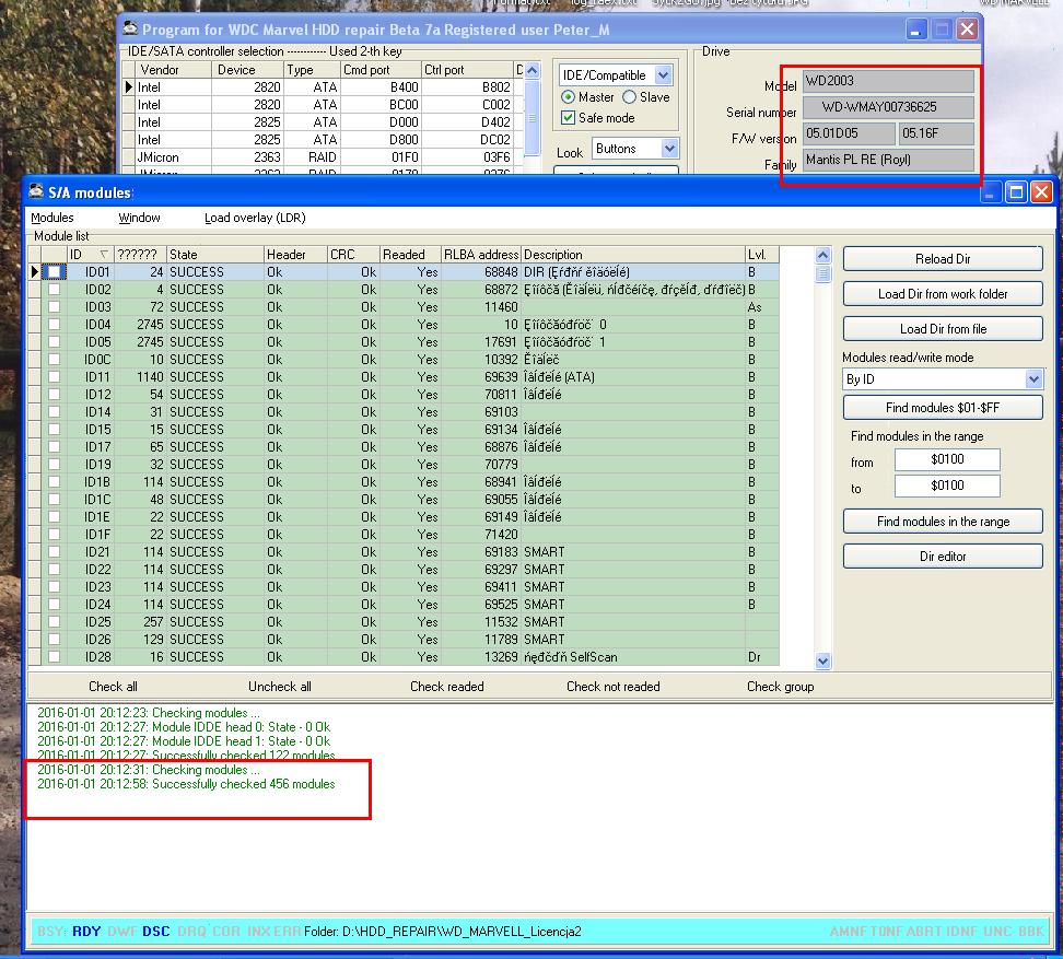

Back region to oryginal state and SA module's work look:
checked all modules Work, but contents mod 03, 0C is incorrect, mod 31, 33, 36 are empty :arrow:

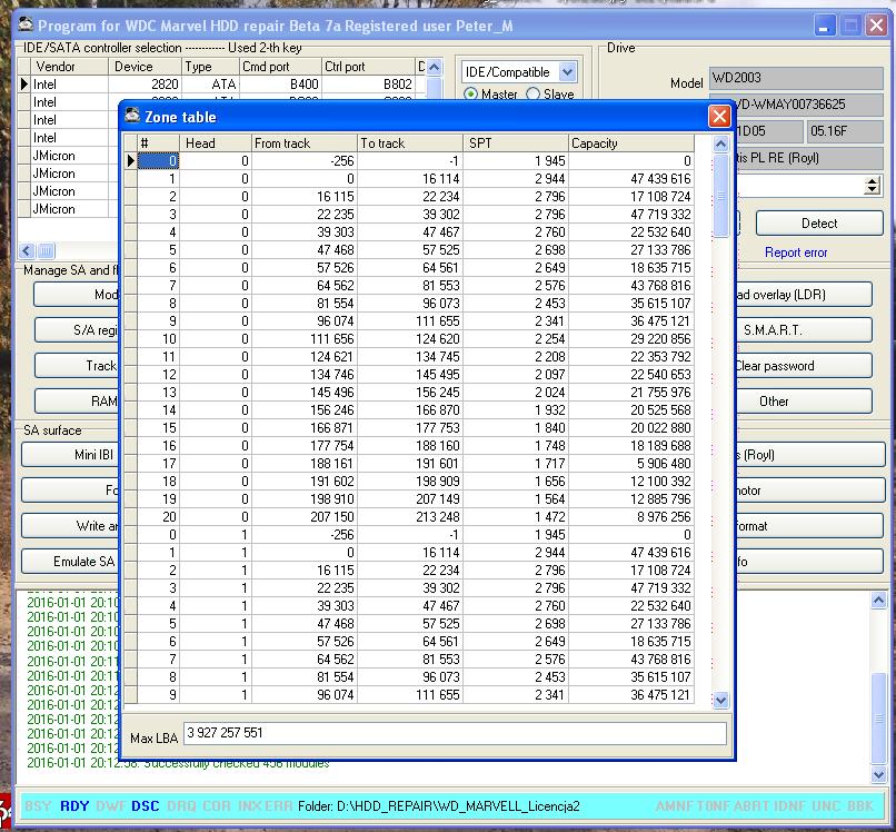

In contrast, as presented current insight into the zone table:
:arrow: All heads are the same entries.

Head map TPI, and capacity, max LBA, CURRENT DATA TPI for all head is incorrect.

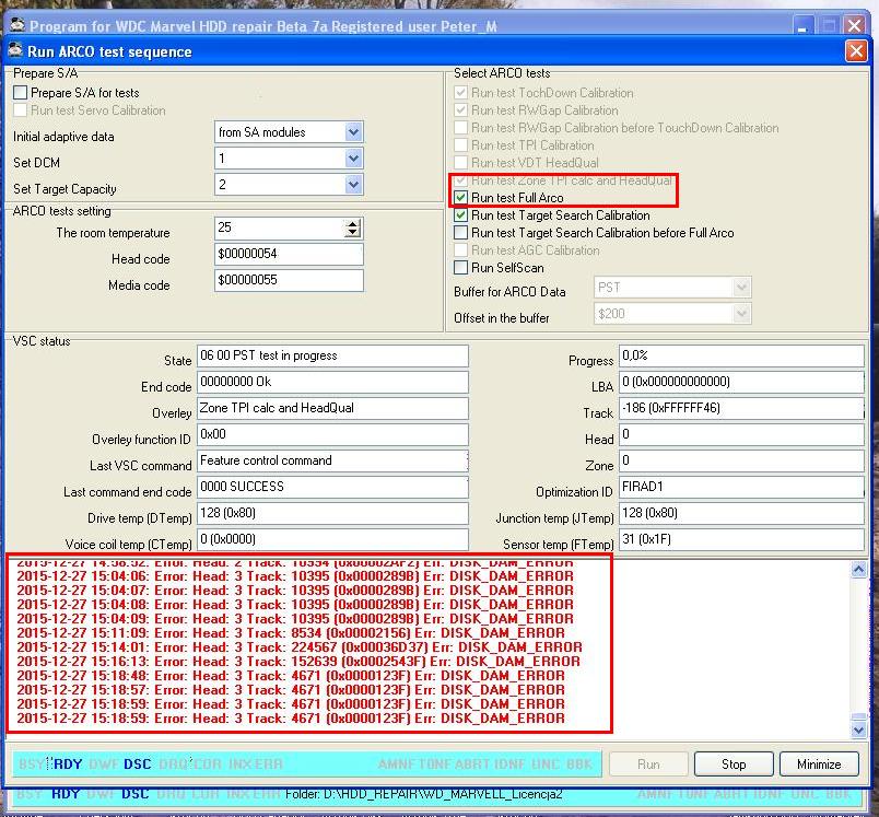

so The situation is during the procedure ARCO:
Regards, and thank you so much behind all replies :)

Try "Prepare Sa For Test" checkmark.
Try "Run Test Servo Calibration" Checkmark.
Try "Set Target Capacity" to 1.

Oh spildit friend, I tried, and Nothing of that. Target capacity must be 2, because Plater condition in these drives do not allow you to set options 1.
I also tried the scripts I've written on your forum, but the scripts were other models even though they were from the same family drives.
 Post subject: Re: CA_FLUSH_ALL_GOT_CANCELED - what's wrong?
PostPosted: January 2nd, 2016, 9:34
Posts: 438
Anyone have any idea's? Regards friends :)
PostPosted: January 2nd, 2016, 11:46
Joined: December 19th, 2006, 8:49
Posts: 11038
1 - Get an eaqual drive or ask someone with equal drive to test that out.
2 - Ask in general if people can run ARCO on those drives even with other tools.
3 - Test yourself with another drive.
- You must be sure if the problem is with your specific drive or with all drives from that model first.
Regards.
1Q9xrDTzTddUXeJAFRn37aqh1Yr6buDCdw - (Bitcoin Donations)
paypal.me/Spildit - (PayPal Donations)
The HDD Oracle - Platform for OPEN research on Data Recovery.
PostPosted: January 2nd, 2016, 12:15
Posts: 438
1 - Get an eaqual drive or ask someone with equal drive to test that out. :arrow: with this is a problem, because I have another WD Black for testing.
2 - Ask in general if people can run ARCO on those drives even with other tools. :arrow: WD Black drives are rare and the few it has, because of the price. ps. Newest PC3K certainly moves each WD BLACK, or sediv
3 - Test yourself with another drive. :arrow: self tests on other drives such as the ARCO on WD5000AAKX and on Zephyr WD7500BPVT over Seamlessly, WD15EADS SELFTEST module 28 Seamlessly,
- You must be sure if the problem is with your specific drive or with all drives from that model first. :arrow: the problem is not only in my case, viewing the forum I stumbled on another topic: WD20EZRX CA_FLUSH_ALL_GOT_CANCELED
Btw, solutions are 2.
Module 28 with the procedure arco, which is assigned to FW: 00050016F or higher, or a question WD MARVEL Autor to improved ARCO procedure for WD Black and higher. :(
PS, Franc or moltke he probably would have helped something, but first they had to analyze the firmware, but I doubt that they wanted to do :(
