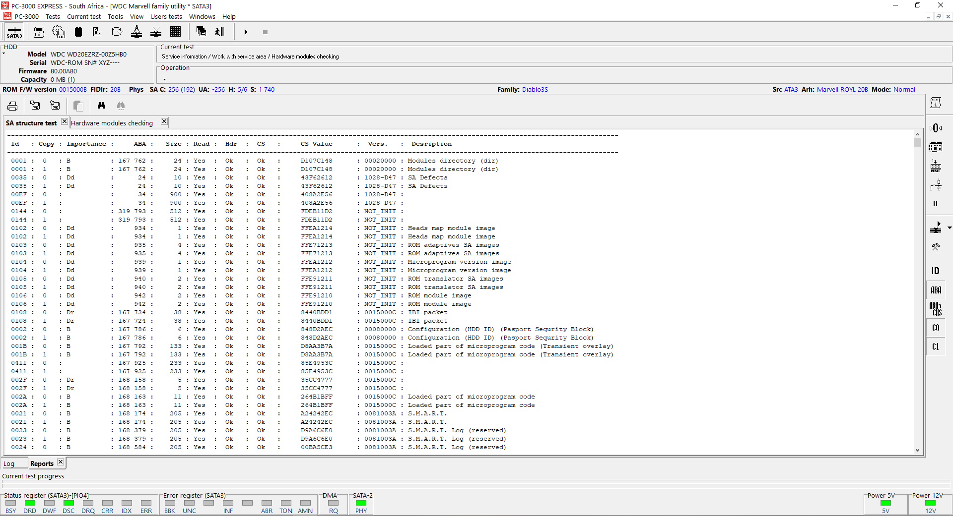

But scan SA surface is good no problems. The modules also, with the exception of the 03 0c. so
Something is not right here. I repeat arco has no access to user area in order to further calibrate the drive :?

This half of the case. disk writes? ie you can write modules or some sort of pattern in sa under normal start, and not under the loader?
 Post subject: Re: CA_FLUSH_ALL_GOT_CANCELED - what's wrong?
PostPosted: January 3rd, 2016, 20:19
Posts: 438
Yes drive writes modules perfectly without errors . Yes, Sa normal start without problems. But arco can't calibrate this drive because arco can't access to user area. Btw I will try record this sytuaution What is happening with the disc. OK?

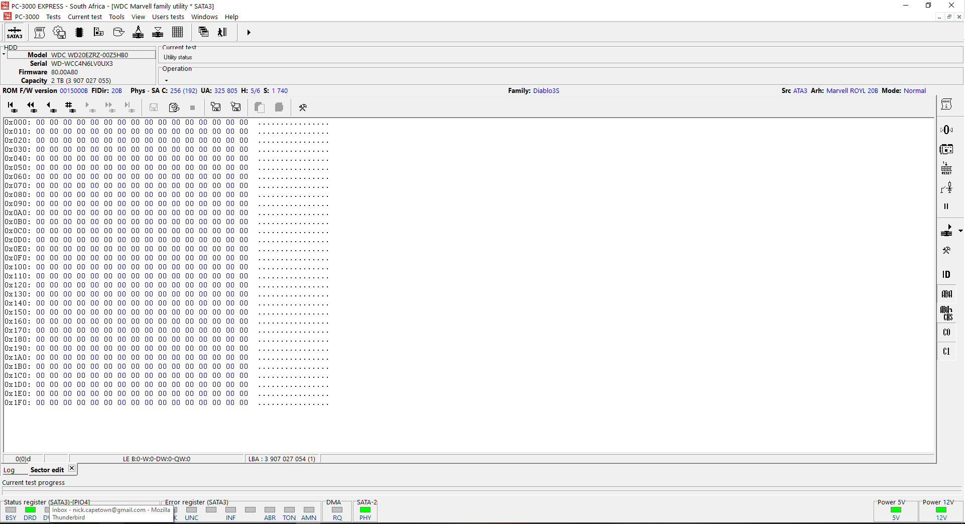

Yes, SA Initialized propertly, No Error :arrow: CA_FLUSH_ALL_GOT_CANCELED, But i can,t access to User Area, ARCO procedure Can't access to User Area, no SLOW responding.

Nothing, but problem It occurs when you need access to the User Area, then everything locks up and you receive an error CA_FLUSH_ALL_GOT_CANCELED understand me?
