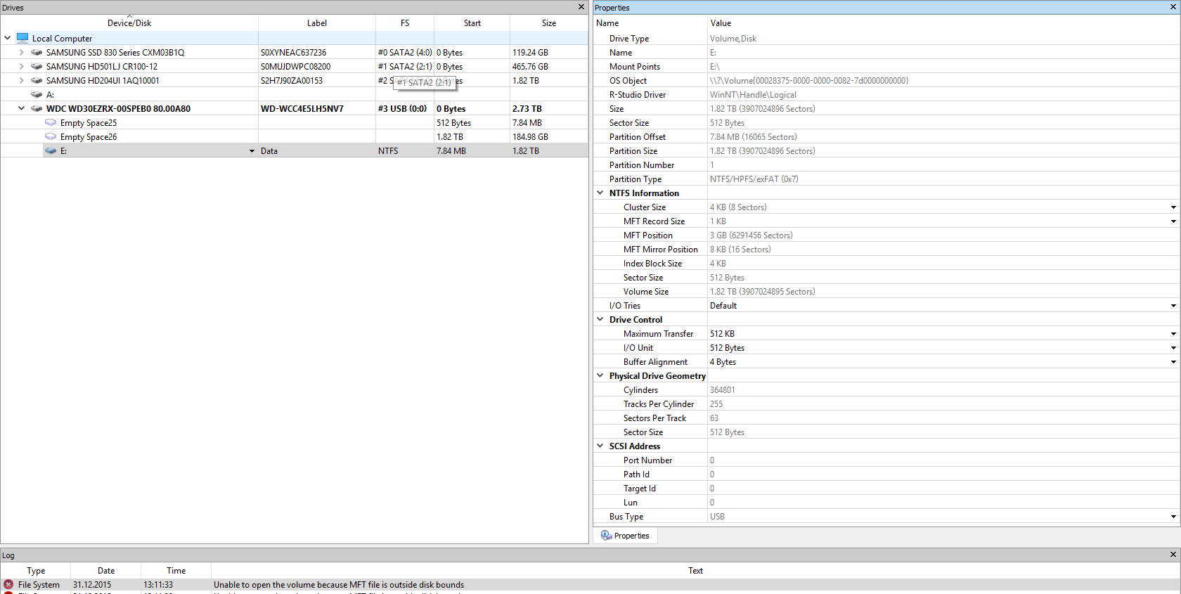

I have a serious data loss problem and hope that someone can help!
Situation: My 2 TB hard drive (HD501LJ) with all my personal data was suddenly not accessible anymore by Windows. So my first reaction was to use EaseUs Todo Backup to create a partition backup on a different drive. I tried to recreate the partition on the original drive after formatting, but that didn't work, because it said the space was insufficient. (I know, formatting the original drive was a terrible idea...) So I got a 3 TB drive (WD30EZRX) and recreated the partition on that drive. However, the drive was still not accessible by Windows. I used a demo versions of recovery tools to scan the drive, and some of them listed files from the drive, so I assume recovery is possible. But for the actual recovery, all of them required to purchase the full version.
Goal: The best result would be to repair the files system, so I could access it normally again. If that doesn't work, my goal would be to recover as many files as possible with the original folder structure. There were a lot of files on that drive (documents, pictures, music, video, etc.), and organizing them again into folders would cost me weeks. A solution that takes a smaller amount of expert knowledge would be preferable.
Diagnostics:
    SMART results are all good for both the old and the new drive (I assume this is not a hardware problem)
    The problem seems to be a corrupt master file table, I tried to fix it using CHKDSK e: /f /r but Windows wasn't able to
    R-Studio says: MFT file is outside disk bounds (I attached the log file and a screenshot, drive number 24 (e:) is the relevant partition)
Any other information required?

It appears that EaseUs cloned your partition or physical drive to a file. It also appears to have prefixed this file with 7.84MB of header information.
ISTM that there may still be an easy solution using freeware. I would examine the 3TB drive with a disc editor, eg DMDE.
Can you show us DMDE's Partitions window?

As Spildit suggested, I have indeed mixed up the model numbers in my question. The following is correct:
HD51LJ - 500 GB
HD204UI - 2TB
I have tried the free editions of R-Studio and DMDE which both seem to be great tools for working with damaged drives. I went on with DMDE and did a full scan. Then the whole folder structure (as far as I can tell) was listed and I was able to selectively recover the files and folders that were most important to me, which was a great relief! :D
Now, before going on and searching for folders worth recovering, I was wondering if it was possible to actually repair/recreate the MFT record or any other damaged parts of the file system to make the volume be normally recognizable/accessible by an OS?

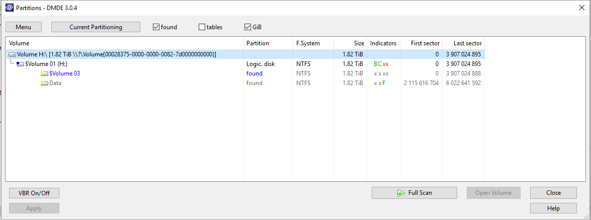

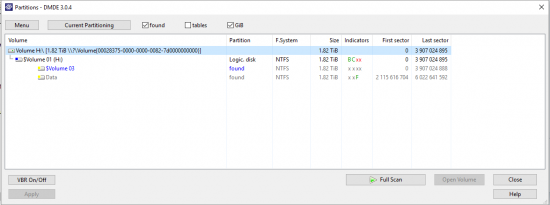

@fzabkar: Here's the partition view of DMDE:
Is that of any help?
If you need more information, I'm happy to provide anything DMDE or R-Studio produce as outputs.
Thanks again.

It appears that you cloned your 2TB partition to a file, and then restored this partition to your physical 3TB drive starting at sector 0. The usual offset for the partition on an MBR system would be sector 63 (for Win XP) or sector 2048 for later Windows OSes.
The solution would be to shift the whole partition by 63 or 2048 sectors, but that would be risky. An alternative would be to edit two bytes in sector 0. This would then turn your HDD into a Super Floppy, ie a drive without a partition table. The changes would be very easy to undo and would not affect your data in any way.
Can you select Mode -> Hexadecimal/Text and show us the contents of sector 0? This should be an NTFS boot sector.

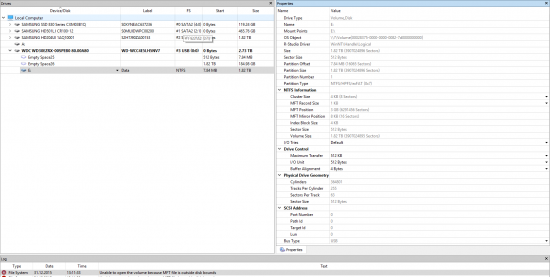

Sector 0 is a Win7/Vista boot sector. Normally sector 0 would contain an MBR.
The Number of "Hidden Sectors" is 2048 (= 0x00000800). This means that the boot sector should be located at sector 2048, not 0.
00000000010: 00 00 00 00 00 F8 00 00 3F 00 FF 00 00 08 00 00
The size of the volume is 3907024895 (= 0xE8E077FF) sectors.
00000000020: 00 00 00 00 80 00 80 00 FF 77 E0 E8 00 00 00 00
http://www.google.com/search?q=0xE8E077FF+in+decimal
There is a backup boot sector at the end of the volume. You should be able to locate it by selecting ...
    Editor -> Goto Offset
    Sector = 3907024895
Page down to the next sector if necessary. The backup NTFS boot sector should be a copy of sector 0.
We then need to edit the Number of "Hidden Sectors" from 2048 to 0.
00000000010: 00 00 00 00 00 F8 00 00 3F 00 FF 00 00 00 00 00
You need to select ...
    Edit -> Edit Mode
    make the change
    repeat for both sectors
    Drive -> Apply Changes
Reboot so that Windows can reexamine the file system. Hopefully the volume will now appear in Explorer. DMDE should also see it differently (the "Indicators" should now be BCF rather than BCx).
If the drive does not appear in Explorer, then it may be that Windows does not know how to handle a Super Floppy on a Fixed Disk. In this case you could try to edit the registry so that the drive appears as a Removable Disk. Alternatively you may be able to check the Removable box in the Properties for the disk in Device Manager. Still another alternative might be to mount the drive by booting to a Ubuntu Live CD.

I am trying to reactivate this thread since I am finally back at the issue after a few months of other troubles, including other parts of my computer breaking down. I hope you're still here!
I followed fzabkar's suggestion and edited sector 3907024895:
