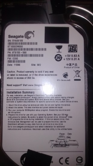

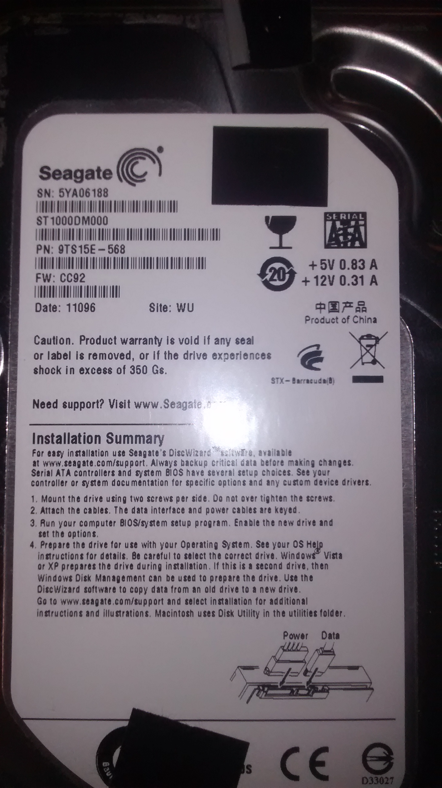

Attached image from the back of the drive:
 Post subject: Re: Seagate 1tb - advice on recovery please
PostPosted: January 4th, 2016, 12:15
Posts: 738
Location: Ottawa, Canada
It's the dreaded Seagate DM series, so will be a challenge even for a data recovery pro to deal with. I would suggest telling the repair shop to disconnect and return the drive to you so you can take it directly to a DR pro. The more they work on it, the less the chances of recovering the data. It probably has damaged firmware, failing heads and/or bad media, none of which will be cheap to deal with.
Contact Sean at PCImage for an honest assessment. He's located in Peterborough.
