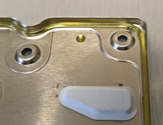

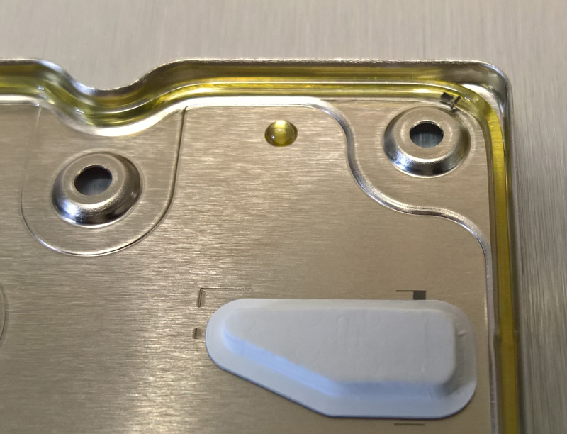

Happy New Year In Advance To You .Thanks For The Inputs .I Disassembled The Drive As i Wanted To See What Are The Damages Inside .The Head Seems To Be Outside The RAMP On The Platter Very Close To It .Well i Though Might Be The Company i Used To Give My Cases did Not Check This .I Tried To Get The Heads Off The Platter On The RAMP .The Heads Would Not Go on The RAMP .Hence i Removed The Ramp And Got The Heads Off The Platters .Seems Head No 1 And 3 Are Not even There in The stack The Actual Black Head Seems To Be Missing/Broken .One of It Is From The Top Side Platter And i Cannot See it Anywhere .Might Be Once i Disassemble The Entire Drive Other Then Platters i Could See Those Two Tiny Heads Somewhere .According To Me There is a Risk Factor in This Drive As Might Be If i Arrange New Head Stack And At Least one of those heads are stuck on the platter [ Its Gona Be Fireworks ] . Hence i Have Decided To Let Go off This Case .

If 2 sliders are missing, I'd say it's game over for that drive (for me, anyway). Some drives, you can remove and inspect/clean platters without worrying about platter rotational alignment but lots of luck with that. Chances are the platters are scored by the bare gimbals (to which the sliders are normally attached).
This is typical. Look for the missing sliders on the bottom side of the top lid, on the yellow rubber or on the small filter.
This drive could have chances but it is not going to be easy.
3 out of 4 sliders "hanging out" in the top lid.
