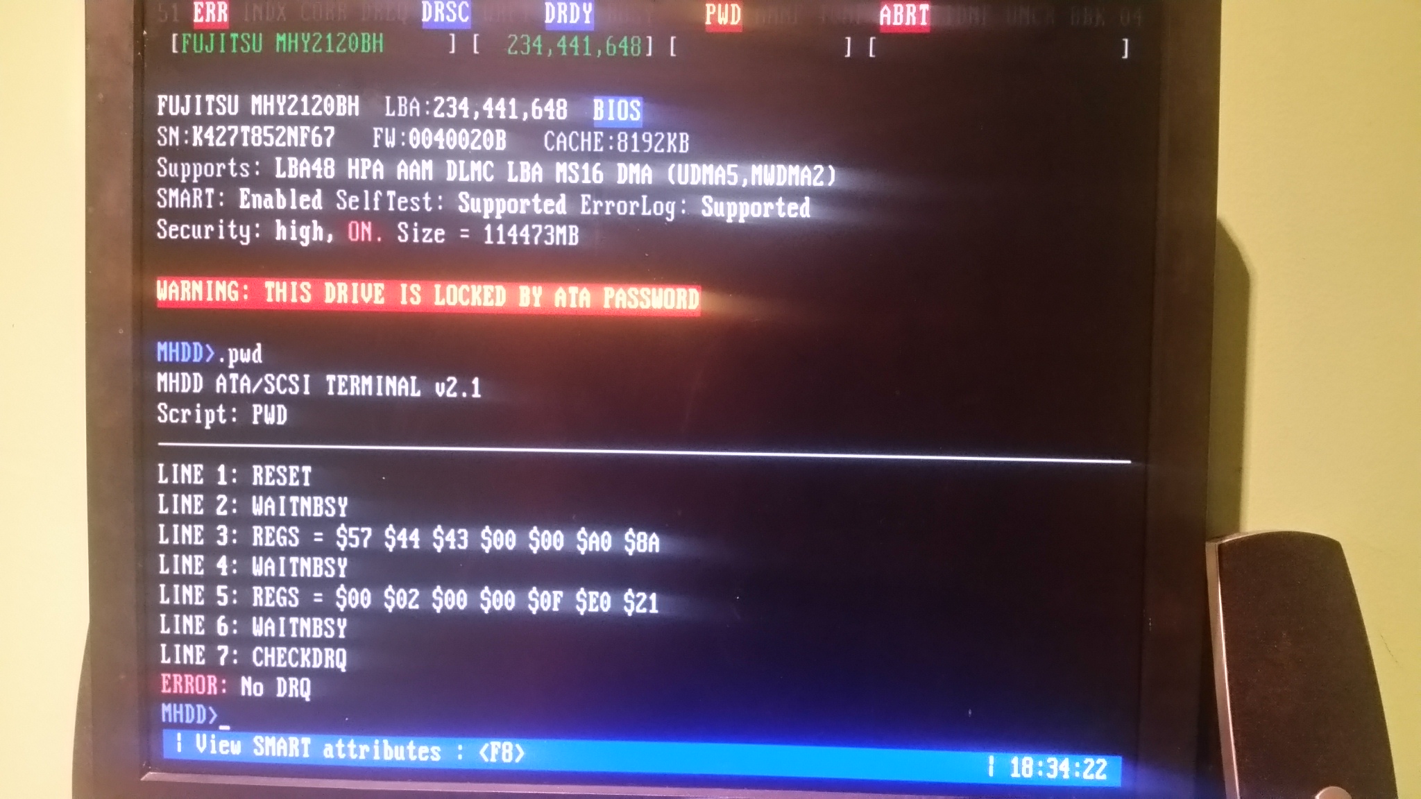

Hi All,
Sorry I'm really noob at this, first time coming across an encrypted HDD password and it's a PITA. Really struggling with bypassing the password. The user has already said they're happy to wipe it, but I'm struggling to unlock the unit to do a secure erase. The laptop initially had a BIOS password / Supervisor password. Cleared these
The HDD has been encrypted with a User ONLY password (security High by the way not Max)
Things tried so far:.....
HDAT2
I tried to unlock the device using Master password (32 spaces, or WDCWDC, etc no luck just fails)
Master Password Revision Code : FFFeh
MHDD2
I tried running .dump & .dump2, no script files intially. I found one on the forum by another user, but when running this I receive a No DRQ error message on Line 8. Are the scripts files you make specific to every model or HDD, or is there a generic script that you run which dumps the password data into the 21.bin and 22.bin files?
I can run the DISPWD command and it comes up as "Done" (I leave it as blank spaces)
When I type UNLOCK and select the option for "Master" it comes up as fail (I tried 32 spaces)
ATAPWD
Tried removing the password (tried all options really) every single one
"Command rejected by drive"
VICTORIA
I can go into PIO mode via Hirens' Boot CD (Mini Windows XP) but gives an error about DISPWD and drive being Frozen
I'm assuming this is because I haven't unlocked the drive yet.
Also, additionally. I have tried connecting the drive into Windows (Disk not intialised message) and when trying to format I received an I/O device error (I'm guessing this is because it's locked it's denying access to the drive). I also tried running the "HDD Unlock Wizard program" (think it's A-FHDD or something like that) and it detects the drive but says the Firmware is not supported
Could anyone suggest or offer help on where I need to go. I'm assuming the first step is dumping the info from the HDD but I need to get a correct working script or understand where I need to go from here.
For reference the script I'm using :
; rm modul id 42
reset
waitnbsy
regs = $57 $44 $43 $00 $00 $a0 $8a
waitnbsy
regs = $00 $02 $00 $00 $0F $E0 $21
waitnbsy
checkdrq
sectorsto = 42.bin
; End.
Is there any reason why you are attempting to unlock a Fujitsu HDD with a Western Digital Corporation master password?
Is this a WD drive that has been hacked with HDDHackr?

Spildit wrote:
The posted MHDD scripts are for WD drives ...
Guess what ... VSC = Vendor Specific Commands meaning the ARE NOT ATA standard meaning that each manufacturer have it's own way to access firmware.
The posted MHDD Script attempts to retrieve module 42 on OLD wd drives.
So ....
1 - Either YOU KNOW THE PASSWORD and you can unlock the drive.
2 - Some of the master passwords that you have can be used as "Master" to ERASE THE DRIVE with data loss IF YOU ARE VERY LUCKY TO GUESS A MASTER PASSSWORD THAT WORKS.
3 - You send the drive to some data recovery firm to unlock with very expensive tools like PC-3000.
4 - You buy a PC-3000 unit yourself ($6000 USD to $7000 USD) and you unlock the drive yourself.
Regards.

Unfortunately it was, unless I'm doing it wrong. I used MHDD and inputted 32 characters for master password and it came up fail. I made sure the identifier was set as Master first. I've tried a variety of the common apps with 32 spaces and they all came up as wrong password. I'm sure I recall reading somewhere that the Master Revision Code was a certain hexidecimal value to allow you to identify if it was the original master password.
