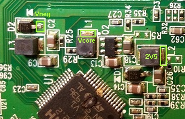

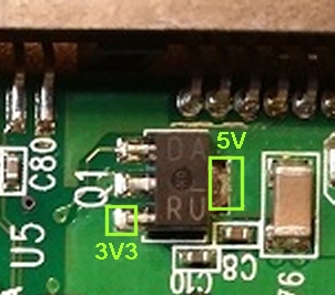

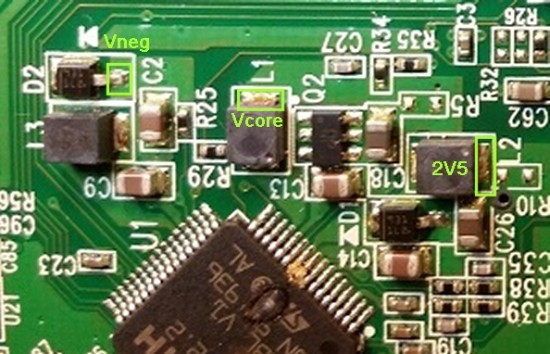

 Post subject: Re: Need help with damaged WD 1 TB SATA drive
PostPosted: January 11th, 2016, 1:12
Posts: 17328
I would take a few more resistance measurements to determine the likelihood that the Marvell MCU survived. To this end I would measure the resistance between ground (eg a screw hole) and the test points in the attachments. Use the 200 ohms range of your meter.
PostPosted: January 11th, 2016, 15:36
Joined: January 7th, 2016, 17:47
Posts: 9
Location: California
Hi fzabkar,
As usual, thanks greatly for your attention! I've made the measurements you requested on both drives, and they are:
Drive 1
Vneg = 100 Ohms
Vcore = 80
2V5 = ~1
3V3 = ~1
5V = open
Drive 2
Vneg = 125
Vcore = ~1
2V5 = ~1
3V3 = ~1
5V = 35
Even if the MCU didn't survive, couldn't the BIOS be retrieved from the SA on the platters with the help of the replacement PCB, and then written to it?
Still not quite gettin' it...
ianc
PostPosted: January 11th, 2016, 16:31
Posts: 17328
Jono-ats is saying that the ROM components are not always backed up in the SA, in which case a DIY solution involving ROM regeneration would not be feasible.
Repairing your PCB would only be feasible if we could determine whether the MCU is likely to have survived. The SMOOTH chip generates 3 voltages for the MCU, namely Vcore, +2.5V and +3.3V. If any of these supplies are shorted, then any component that is connected to them must be suspect.
Your results are a little confusing. I presume that "~1" means that the measurement overranged on the 200 ohms scale, in which case I don't understand the distinction with "open". If instead the resistance is 1 ohm, then that's a short circuit. Could you clarify this for us?
PostPosted: January 11th, 2016, 16:41
Posts: 9
Sure, sorry for the confusion.
~1 means about 1 or less Ohms, basically very little to no resistance. Open means infinite resistance on the 200 Ohm scale.
Hmmm... Repairing the PCB sounds a little nightmarish; troubleshooting and replacing every damaged component sounds like an arduous and expensive job. I should think extracting the ROM would be the low hanging fruit, but what do I know... ;)
ianc
PostPosted: January 11th, 2016, 16:59
Posts: 17328
Thanks for the clarification. Previously you measured 3 ohms when I would have expected to see 0 ohms, so I assumed that 3 ohms was the resistance of your meter leads. A reading of 1 ohm would have been less than the resistance of your leads, which is clearly not possible, hence the confusion.
Anyway, it does look like the MCU in both cases is dead, so your only DIY hope is to rebuild the ROM from the SA.
