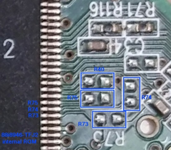

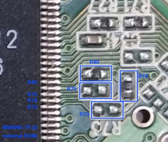

Can you upload photos of your PCBs? There is a resistor (R74) which determines whether the MCU looks for an internal or external ROM. There is also an additional resistor which appears to be present in some implementations, but I don't understand its function.

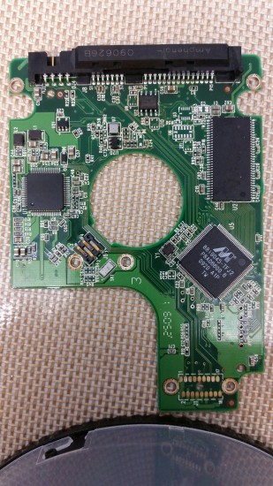

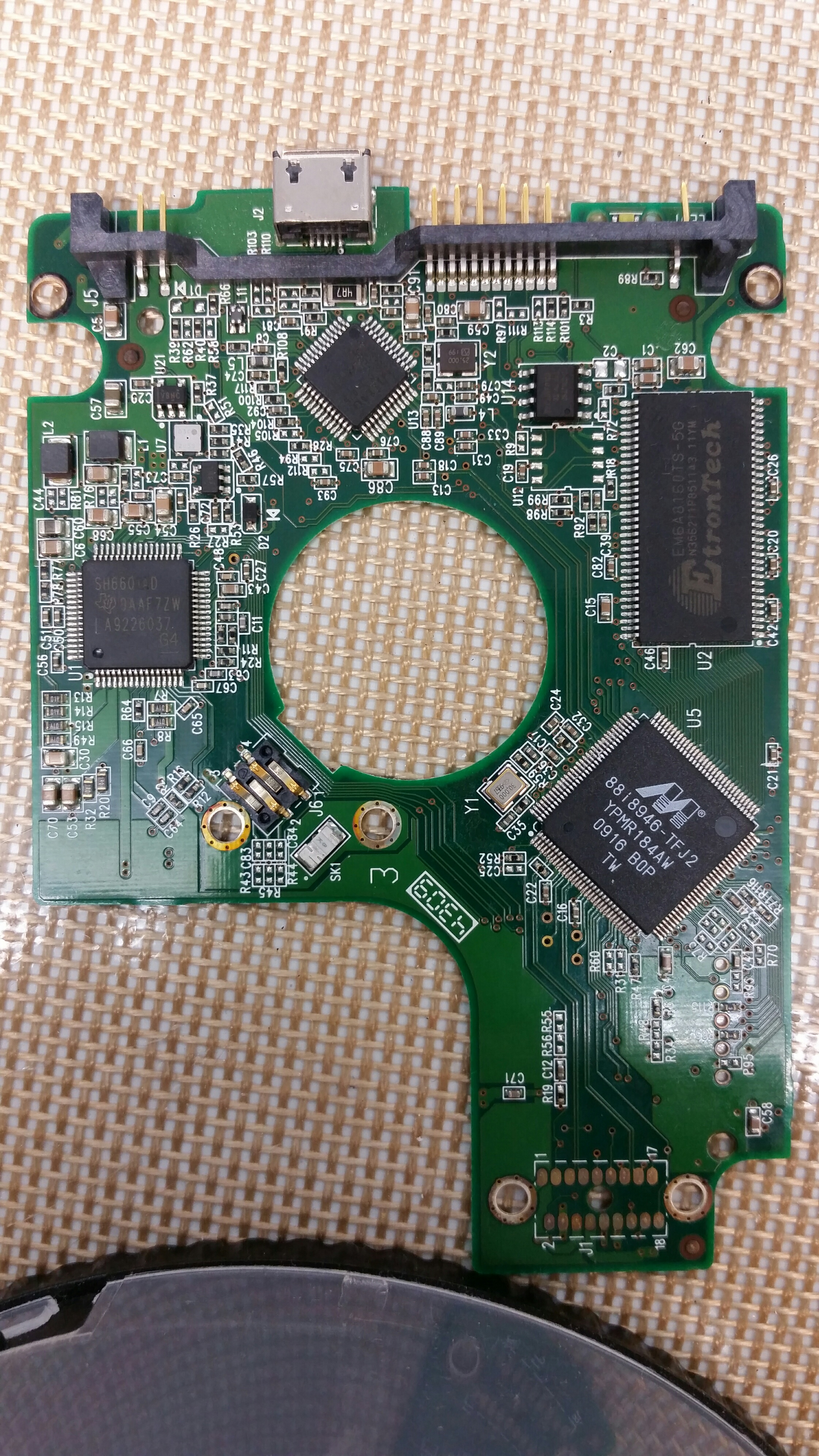

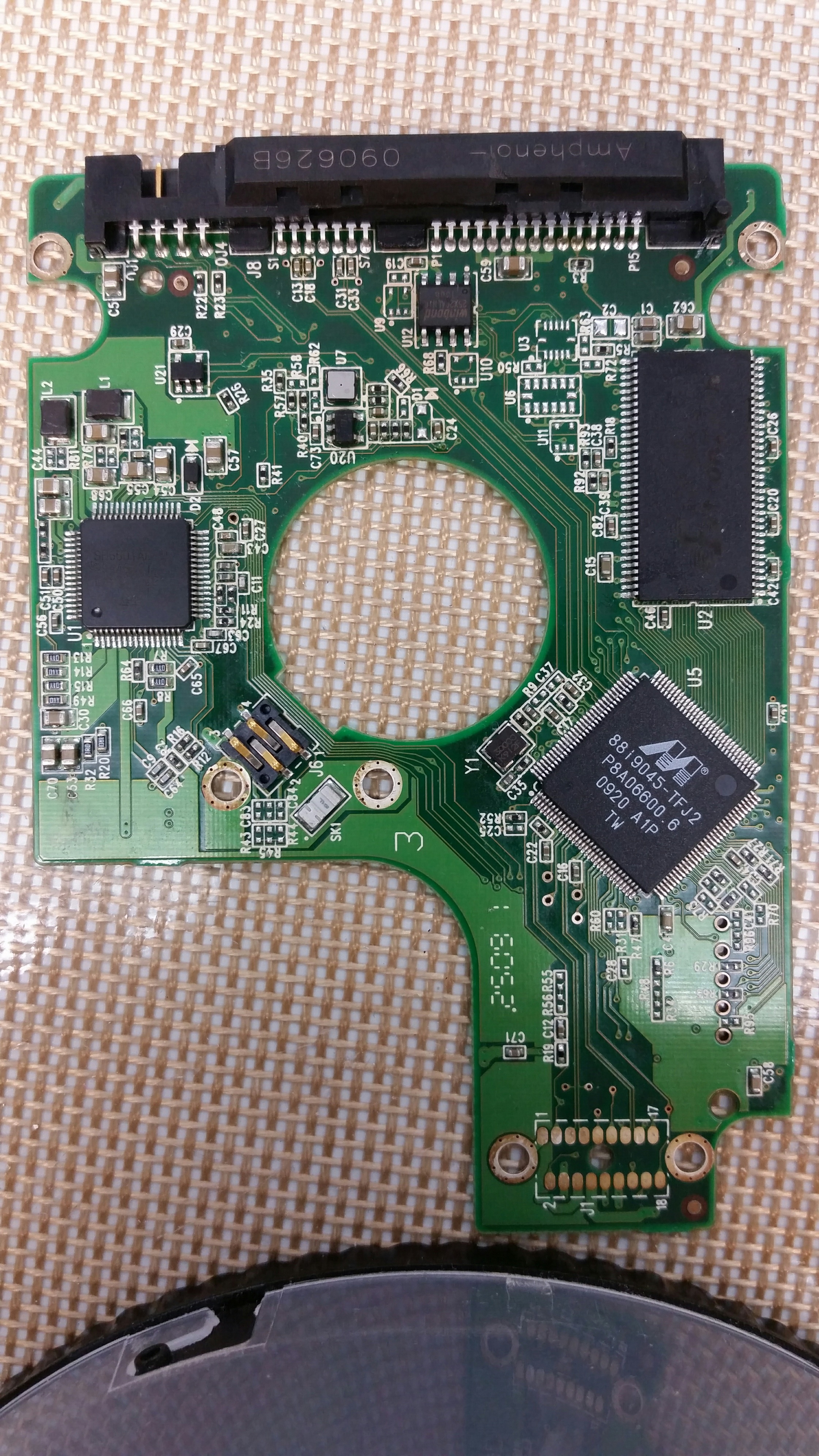

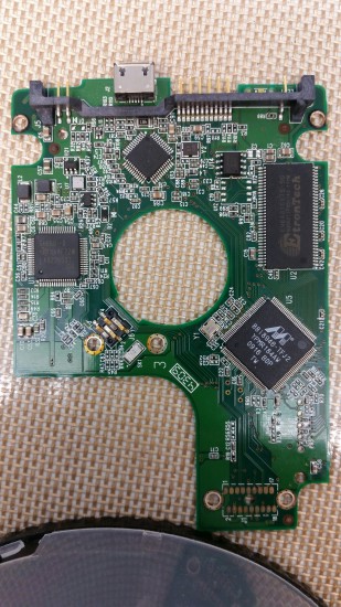

Sorry for the later response. Here are the two boards.
 Post subject: Re: WD10TMVV 11A27S2 USB drive ROM
PostPosted: January 13th, 2016, 5:51
Posts: 17328

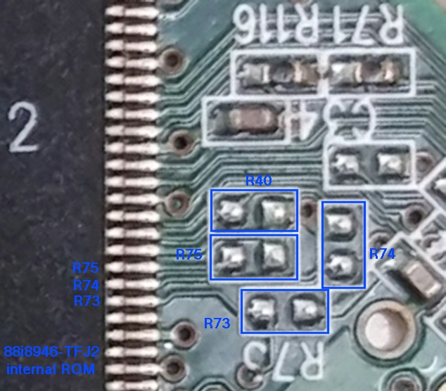

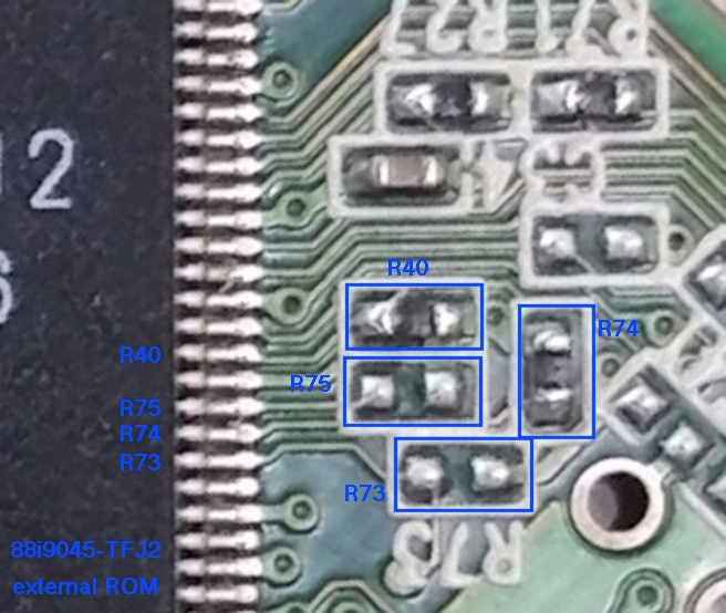

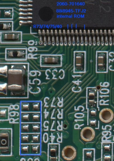

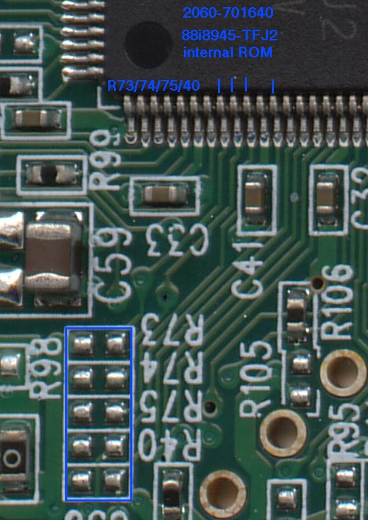

The SATA PCB has an 88i9045-TFJ2 MCU whereas the USB PCB has an 88i8946-TFJ2. ISTM this may be your problem. ICBW, but I would think that the ROM code would test the processor's ID and abort if the correct processor is not present. It appears that the motor controllers are both SH6601AD, so that part is OK.
ISTM that there are two resistors that differ in the external/internal ROM configurations. According to the 2060-701640 PCB, these resistors are designated as R74 and R40. Both are present when the ROM is external, otherwise they are absent for an internal ROM. ISTM that R74 is the important one. I don't understand what R40 does.

The Ace Labs USB/SATA PCB matching list is not totally correct. While the SATA board does match the USB for boards with an external ROM, they do not match for this unusual internal ROM version. The advice given above to try 701609 is correct, but needs additional info. I didn't have a 2060-701609-004 (and cannot find that board on Donor Drives), so I looked at a 2060-701609-001 which I had in stock, but the controller didn't match which threw me off the trail a little. However after doing more research and Mikipp's advice, I have found the correct board (see below).
PCB Sticker: 2061-701609-800 03P
PCB Revision: 2060-701609-000 REV P1
Controller Chip: 88I8946-TFJ2
So for anyone that reads this, if you are matching the USB PCB 2060-701675-001, if its an internal ROM check the controller as you may need the above board instead.
