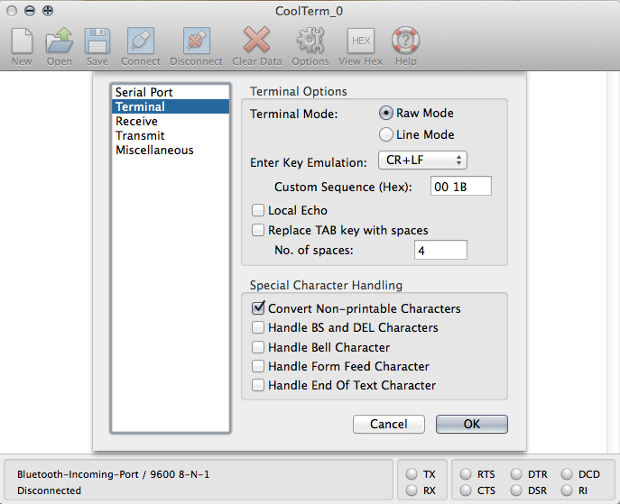

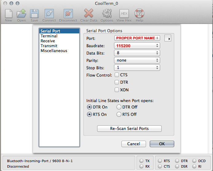

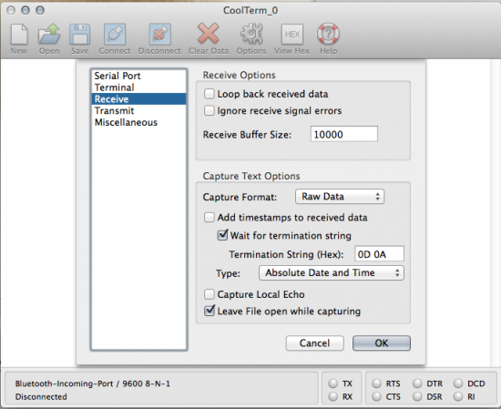

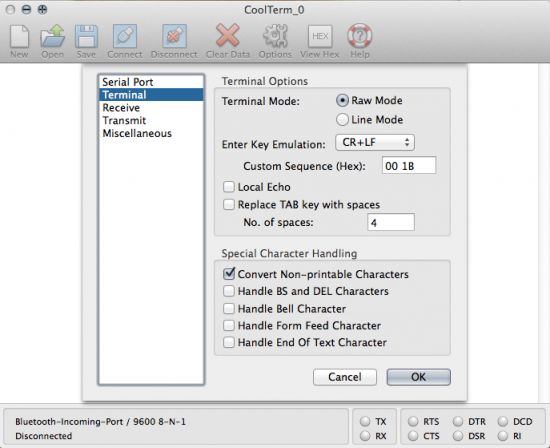

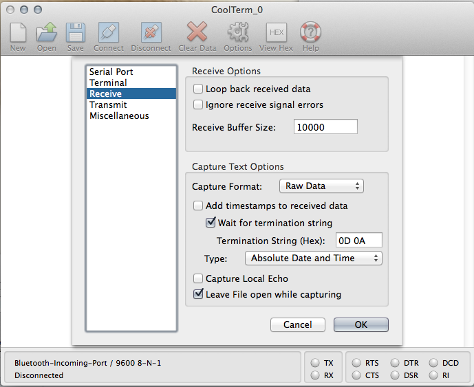

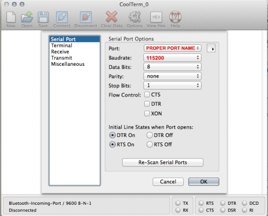

Ok, I received the converter. Before I begin I just want to run through things again. I'm going to connect to the RX, TX, and GND... the RX from the drive should go to the TX on the converter, and vice versa correct? I want the PCB removed from the drive, and if I was facing the drive connectors with the drive upside down (label on the bottom)... the pins from right to left are RX, TX, GND, and the 4th one is I don't know. Then, after I've connected things... I open up whatever terminal program of my choosing. (I was going to use CoolTerm for OS X)... go into Serial Port Options set the Port to the converter (I've already installed the CP210x USB to UART Bridge VCP Drivers for Mac), set the baudrate to 115200, Data Bits to 8, Parity None, Stop Bits 1, and leave Flow Control for CTS, DTR, and XON unchecked... and then connect... and then what? Wait for a text to start flowing in? How long should one wait... 30 seconds? 1 min? This is all while the PCB is NOT connected to the hard drive and does NOT have it's power cable connected to it?
 Post subject: Re: Lacie Network Drive with Seagate Barracudea 7200.12 clic
PostPosted: January 17th, 2016, 16:20
Joined: January 12th, 2016, 18:43
Posts: 24
Location: united states
Ok, I've got CoolTerm for OS X hooked up and am able to get a log each time I connect but it's all garbled text. But it's the same amount each time... just 4 lines.
..à.à.ü.ü.àà.àààüü..à.ü..à.à.ü.ü.à.à.üü...à.à.üà.àà.à.àà...à...ü...àà...à.ü..üàà..à.à...à..ü.üà.àà.ü.ü.ü.à...ü.üà...ü.à.üàü.à..ü.ü..ü.à.ü...à..à.à.............ü...à..à.üà..à.......à.ü....à.ààüü.ààüàü....à..à.à.üàà.....à.à.à.ü...ü...à...ü..à.à.ààààààà..àà.à...à.à.ü.ü.àà.àààüü..à.ü..à.à.ü.ü.à.à.üü...à.à.üà.àà.à.àà...à...ü...àà...à.ü..üàà..à.à...à..ü.üà.àà.ü.ü.ü.à...ü.üà...ü.à.üàü.à..ü.ü..ü.à.ü...à..à.à.............ü...à..à.üà..à.......à.ü...
What am I doing wrong here... how can I get it to display something readable. Or does this mean the drive is toast?
PostPosted: January 17th, 2016, 16:21
Terminal settings seem wrong.
PostPosted: January 17th, 2016, 16:46
Posts: 24
I've attached the settings in CoolTerm I'm using...
With the PCB upside down while I'm facing the connectors (power on my right hand side)... 4th pin on left is empty, 3rd is ground, 2nd is going to RX on the USB and 1st is going to TX on USB.

Posts: 17232
The baud rate should be 38400bps.
