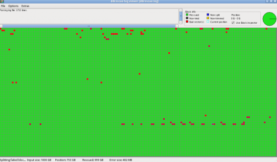

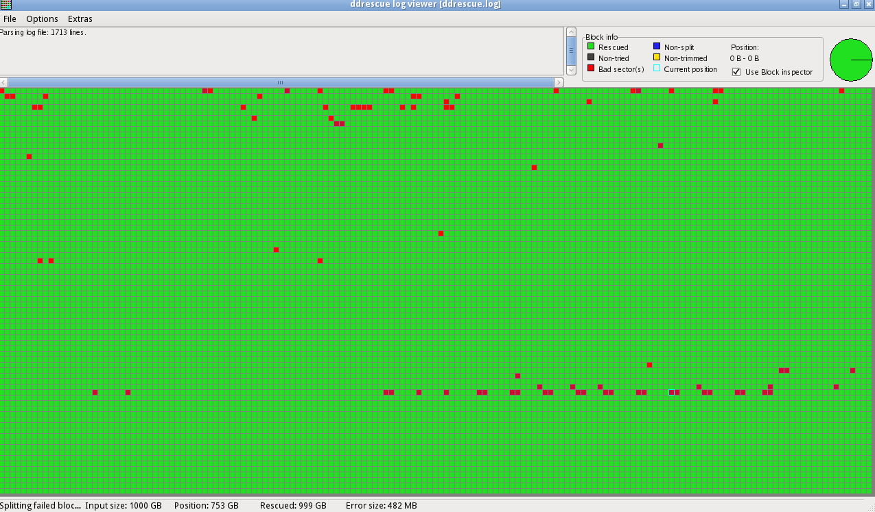

ddrescue logfile and png of its viewer:
https://instaload.de/dl/564c5114c6a1e4.14388583
https://instaload.de/dl/564c50ddaf2642.63334684
? Should I run ddrescue again with r3 / three retries on bad sectors, hoping to get back the critical first sector?
? What are my chances according to the logfile?

here are the two files as attachments...
And you give any details on how to reconstruct the first bad sector..?

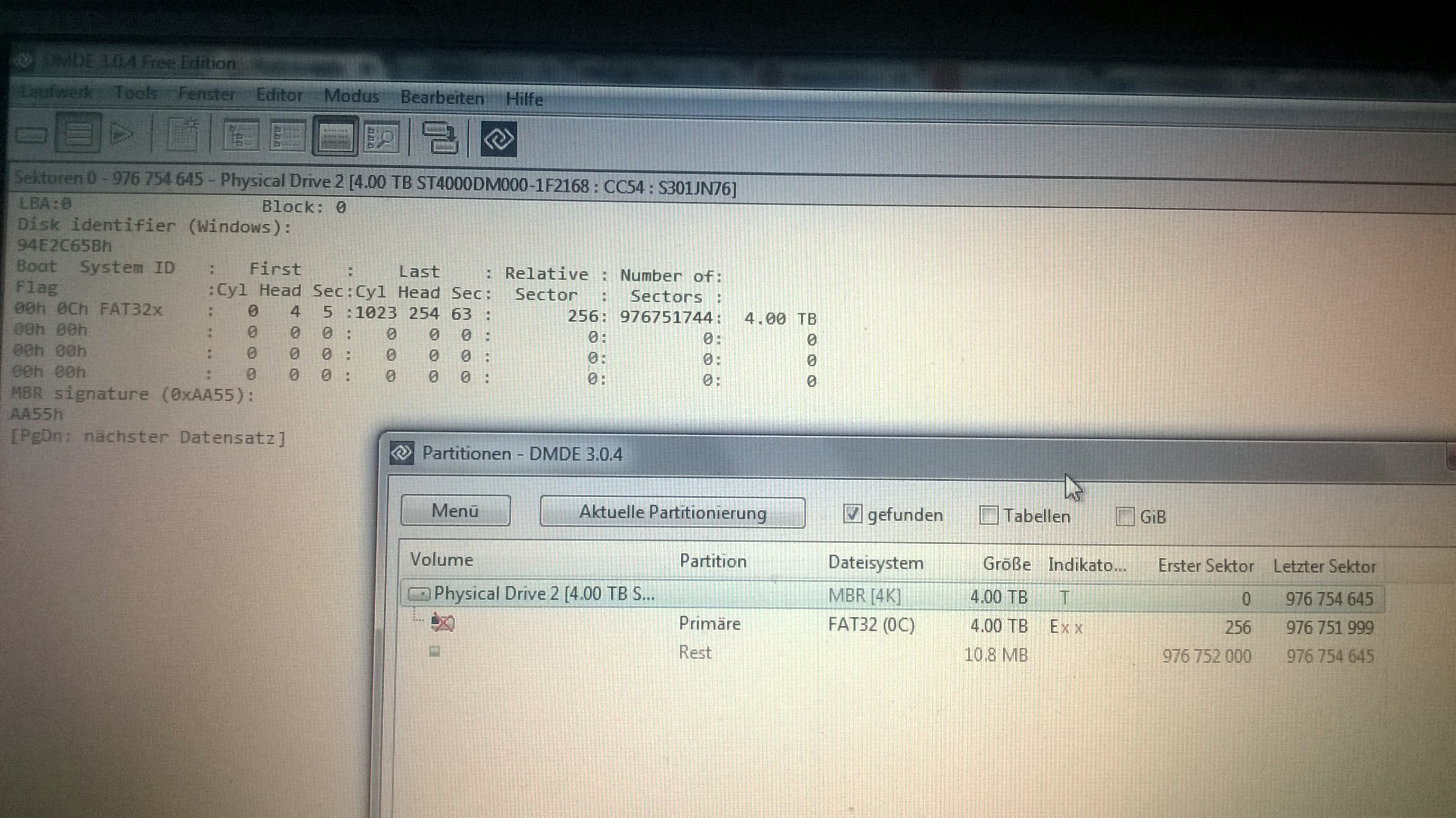

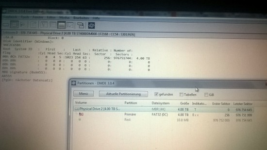

It would be helpful for us to see DMDE's Partitions window. If sector 0 is the only damaged sector at the beginning of the drive, then DMDE should still see the NTFS volume without a search. Repairing sector 0 would then require only a couple of mouse clicks.
One other thing that the Partitions window will show is whether your external drive is using 4KB sectoring, in which case you would have cloned a 512e drive to a 4Kn drive. I'm not sure how that would look to a data recovery program.

thank you for getting back to me - I have attached a picture of the DMDE partitions window, somehow the windows screenshot function didn't work here.
after scanning around 1% of the partition, dmde found ~4000 jpeg files, of which about the half had 0kb. I could recover a sample of the other jpegs could successfully.
- how would you judge the cloned disk based on the attached screenshot?
- I need to get back the structure of the disk, is it possible in any way?
Again, your help is very much appreciated.
