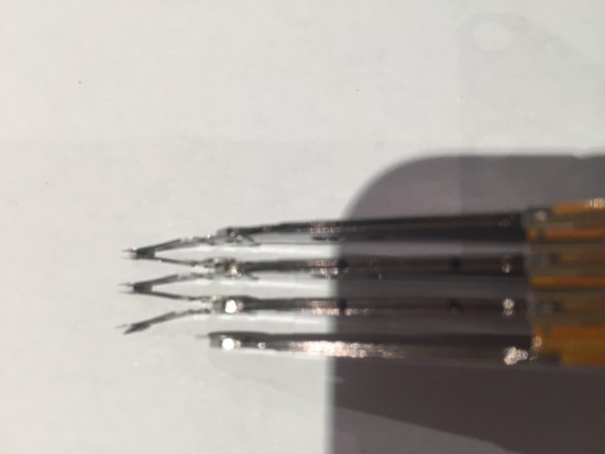

 Post subject: Does this head look right to you?
PostPosted: January 18th, 2016, 13:45
Joined: January 18th, 2016, 13:35
I have recently developed a problem with a Seagate barracuda 2Tb ST2000DM001. After finally throwing in the towel on trying to resurrect it i was curious to see if there was a mechanical problem so i opened it up (I have a backup so no data loss) and found the heads. To me it looks like one of the heads are missing but wasnt sure if this was intentional. I have attached a pic to see for yourselves and to get your verdict on it. I wasn't able to find any evidence of a head floating around in the case nor any scratches on the platters so am not sure if this is by design.
Thanks Mac.
File comment: Head pic.

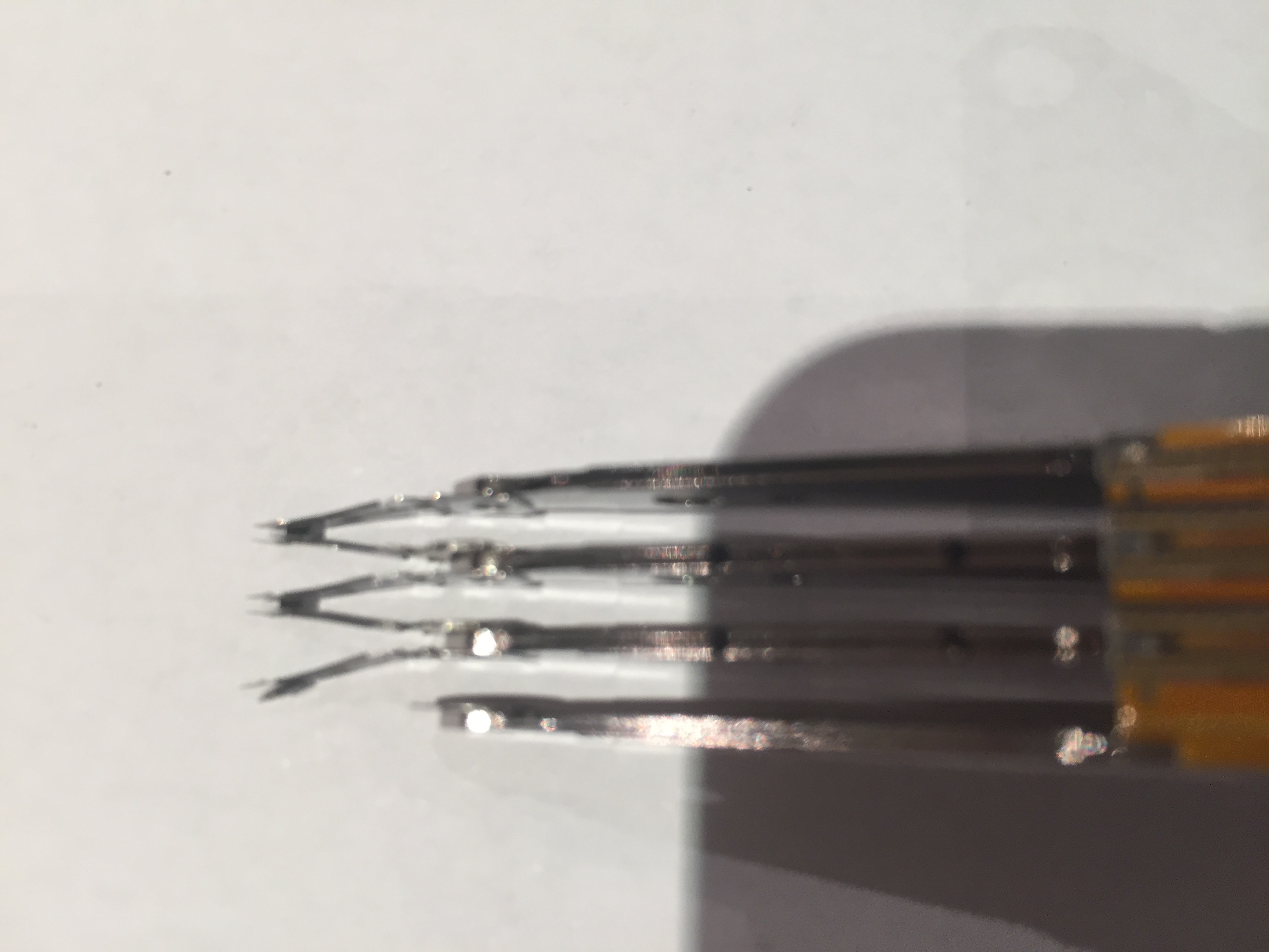

ISTM that there's a missing head or slider, but the picture is not clear enough. Sometimes this is normal (missing complete slider piece). Would you mind to take another picture, trying to focus on the right spot a little bit more?
 Post subject: Re: Does this head look right to you?
PostPosted: January 18th, 2016, 15:09
Have seen this many times on ST2000DM001 with the complete arm deliberately missing, although often it's the top one missing.
As "deftrue" says, the picture isn't clear enough to determine whether the slider on the bottom is missing/damaged or not.

Seems clear enough that the suspension and head is not there.
PostPosted: January 18th, 2016, 17:29
OK thank you guys. Just seemed weird that the whole side of one platter isnt used since there is no head? Maybe the 3TB version is exactly the same but with the extra head?
Anyway It is in the bin now!
Pretty common. Remember kids, friends don't let friends buy Seagate!

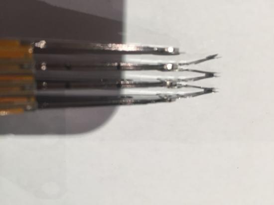

it is the top one
picture has been taken upside down

yes it was the top one. As Jermy said, the picture was taken upside down.
