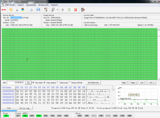

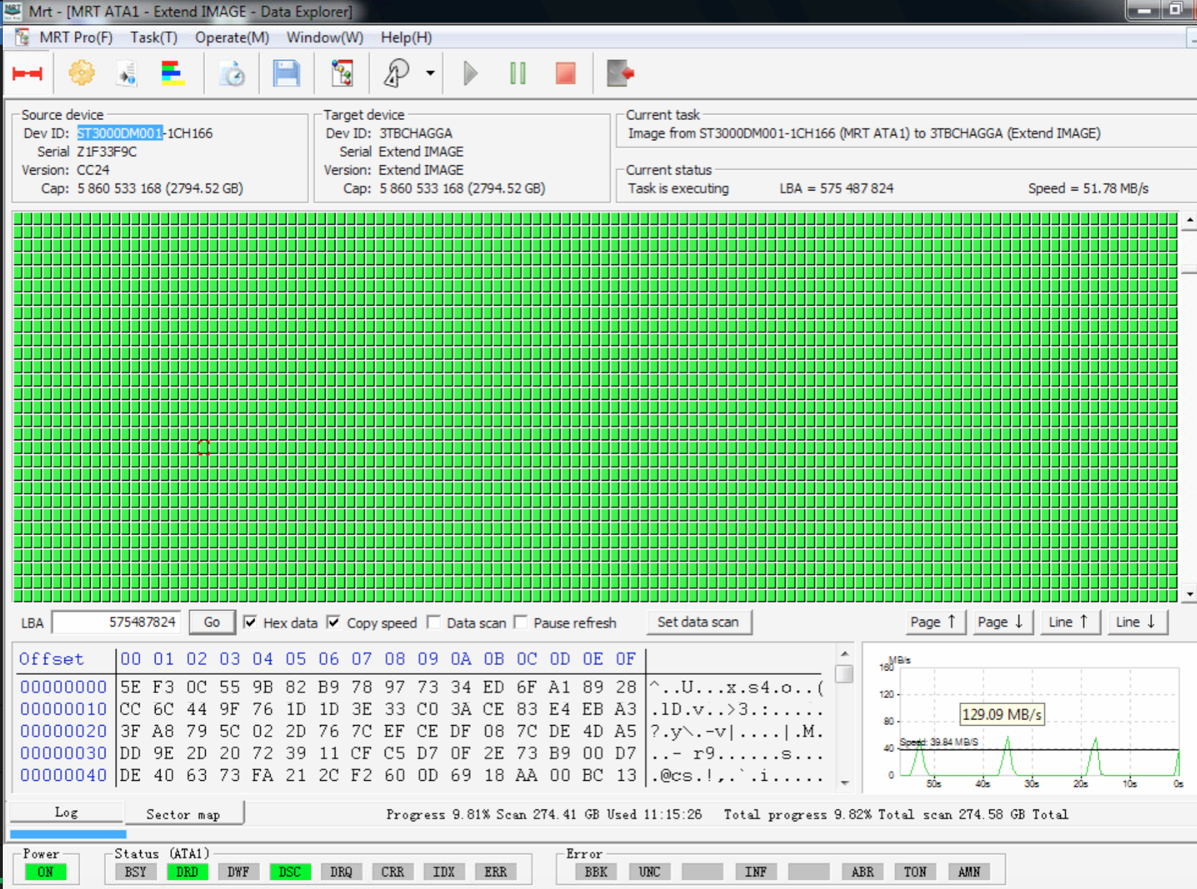

Hey guys,
imaging every 20 secs after Power reset exactly 100 MB! That's better then PIO mode imaging 1 MB/s which is very stable but annoying... the drive would image ages...
is there a way to get it more stable? Already 250 GB imaged - but it is a 3 TB drive...
Thanks in advance
Benjamin

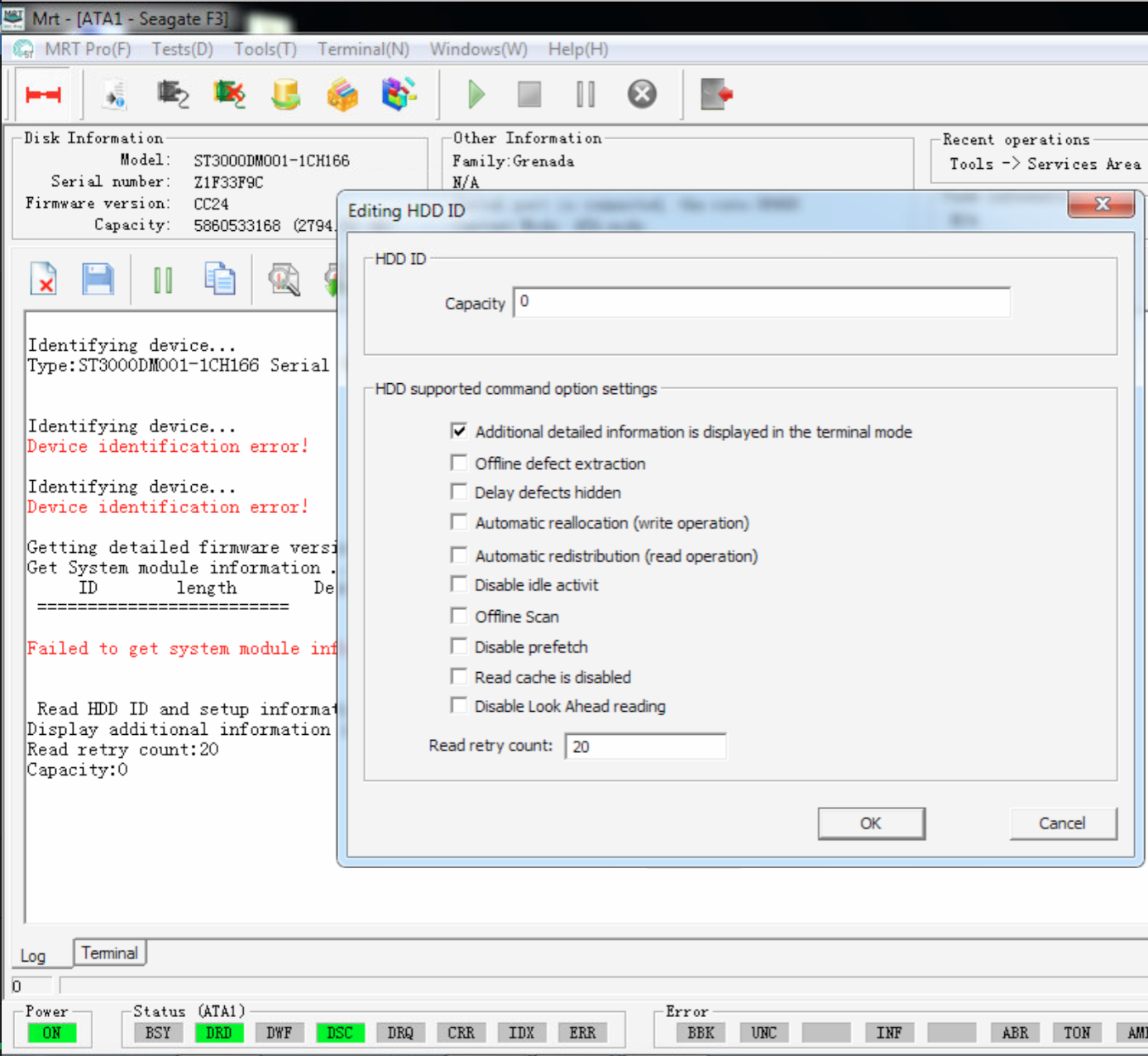

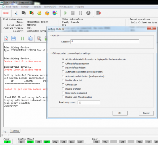

edit: I added a screenshot with changes that were made... Jared edited the SysFile 93 with PC3000 to get the changes persistent.. that was the only way. With Just unchecking the boxes the changes were only temporary... or were not even made.. maybe because of the small timeframe the HDD is going to BSY again.

When the slow down occurs, what is the drive doing in the terminal?
 Post subject: Re: ST3000DM001 - Imaging every 20 secs after Power reset th
PostPosted: December 12th, 2015, 0:02
Posts: 1758
Location: Verona, Italy
Try to clone via UDMA33 instead of UDMA66 or sata high speed.
Also, try to change read timout, sometimes with this drives is better to read with very low timouts (example 150 ms instead 10000 ms).

Try imaging just by head, and in reverse.
Are you able to image the MFT? If so why don't you try selective file imaging.
How much data is on the drive?
I wouldn't bother imaging the whole drive unless there is a lot of data.

Before we imaged the whole area, there were some modyfications in CONGEN. Additionaly we programmed the process to imaging in 200MB parts .
We managed to clone almost 100%

I've found that some really strange DM reading issues can be resolved by just reading in reverse (and sometimes with PIO) without any errors at all, one head at a time.
