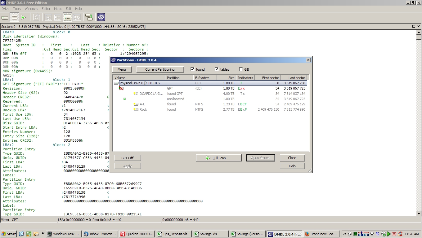

Is this what you're looking for? I had a similar problem with a drive a while back and Active Partition Recovery showed the data as bad and I recovered it without a problem.

Smartctl indicates that the full user capacity of the drive is 4TB but DMDE is showing a capacity of only 1.8TB (3519067759 sectors).
In fact the full design capacity of the ST4000VN000 is 7,814,037,168 LBAs. Smartctl is actually reporting a capacity of 4,000,785.948,160 bytes which corresponds to 7,814,035,055 sectors. I suspect that you may have a Gigabyte BIOS which steals 2113 sectors from the end of the drive for its backup purposes (Xpress Recovery BIOS). If so, then be aware of the following bug:
GigaByte BIOS bug results in loss of 1TB capacity:
http://malthus.mooo.com/viewtopic.php?f=59&t=150
Your GPT partitioning is showing a max LBA of 7814037167 in sector 1. This means that the drive was partitioned on a system where the BIOS did not reserve a Host Protected Area (HPA) for itself. You need to remove this HPA using an appropriate tool, eg SeaTools, HDAT2.
The next problem is that the drive is affected by a 32-bit LBA limitation, most probably in the SATA driver.
    4TB - 2TiB = 1.8TB
I suspect that the 4TB and 3TB drives were both partitioned and formatted in a 48-bit LBA capable environment and then transferred to a 32-bit LBA limited environment. Essentially this creates a data loss time bomb. Everything proceeds OK until you attempt to write data beyond the 2TiB point. As soon as you do this, the data wrap around to sector 0 and trash your file system. At least that's what I think happens.
I suspect that you may have reverted to an earlier SATA driver. This can happen if you move the drive to a different machine, or if you change the mode of the SATA controller in BIOS (AHCI/RAID/IDE). Hopefully all that you need to do is to update the SATA driver and recover those sectors stolen by your BIOS.
