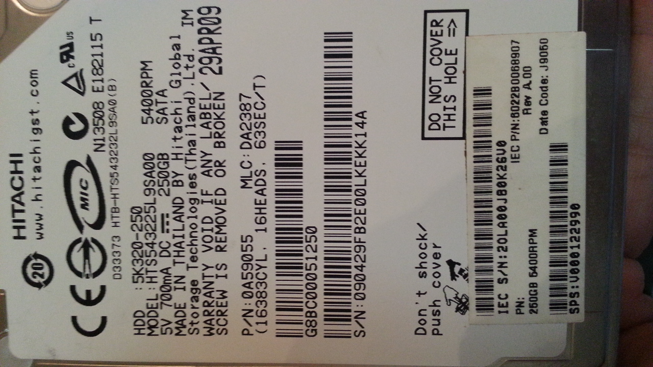

Hello, i'm new in this forum, my english is not so good, so sorry in advance.

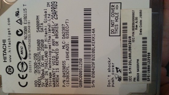

I have a HDD from a laptop, hdd model Hitachi 2'5" 250gb 5k320 that is password protected, under windows 10 i can't read it, only detect but no more.
I have read some messages in this forum, i have tried MHDD that i have run under msdos but told me that is blocked but i don't know how continue for unlock it. I have read some guides like victoria with a hexadecimal program but don't know if is correct or no.
Only that i want is unlock these hdd.
Can anyone help me please?

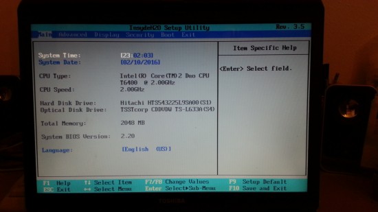

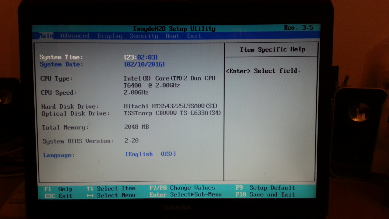

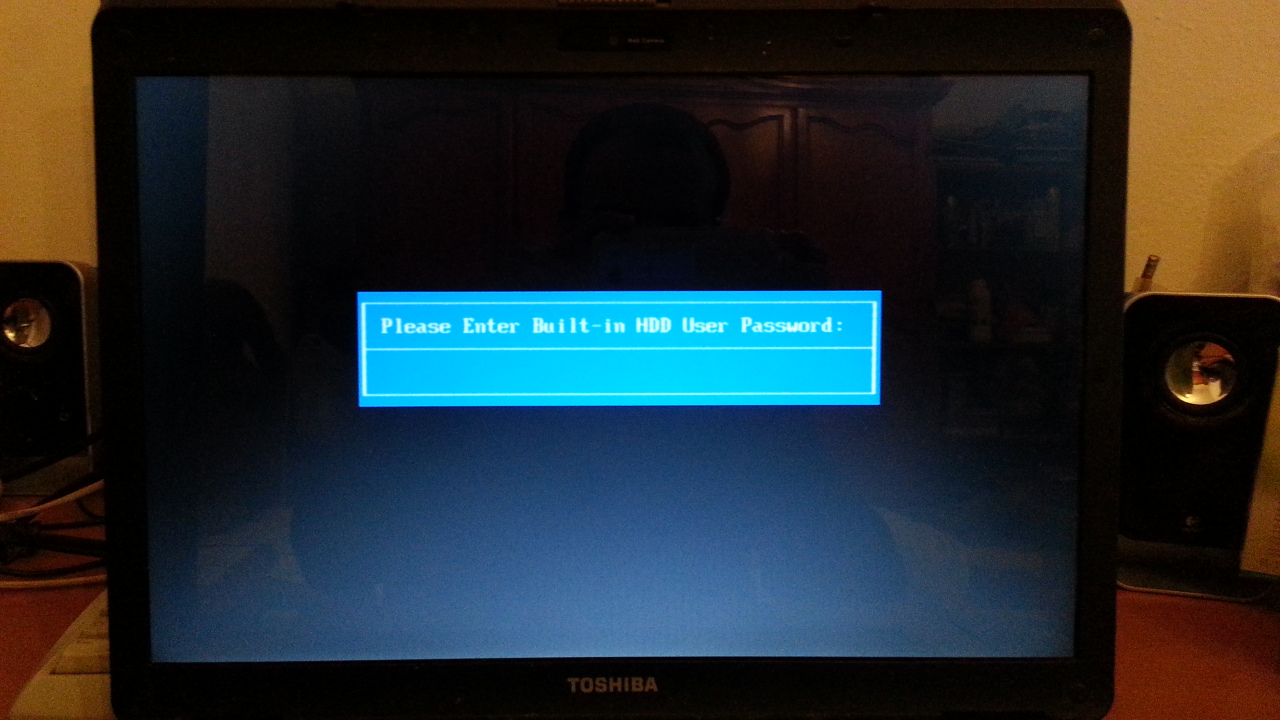

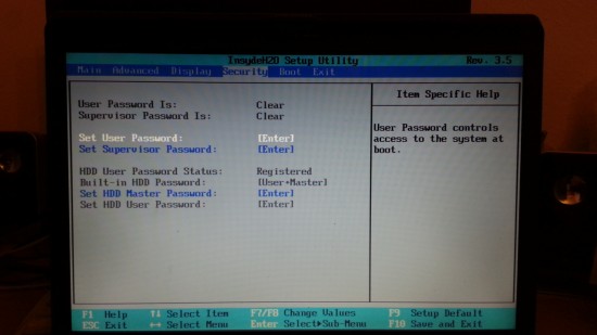

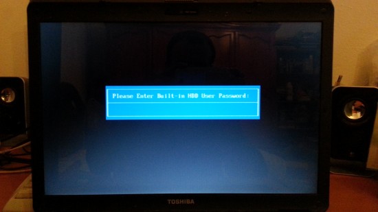

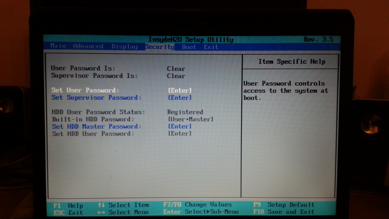

Unit is blocked, but i don't know why, is a laptop that bring me for repair it, toshiba satellite pro l300 with a sata hdd hitachi 5k320-250, when you turn it on appears the message "enter built in hdd user password" and i can't continue. I enter in bios ok and it as hdd password protected option "user+registered", the owner don't know the password

i upload a pitctures of the laptop in question:
 Post subject: Re: Hitachi 5k320
PostPosted: February 10th, 2016, 18:27
Joined: February 9th, 2016, 8:43
Posts: 26
Location: Spain
