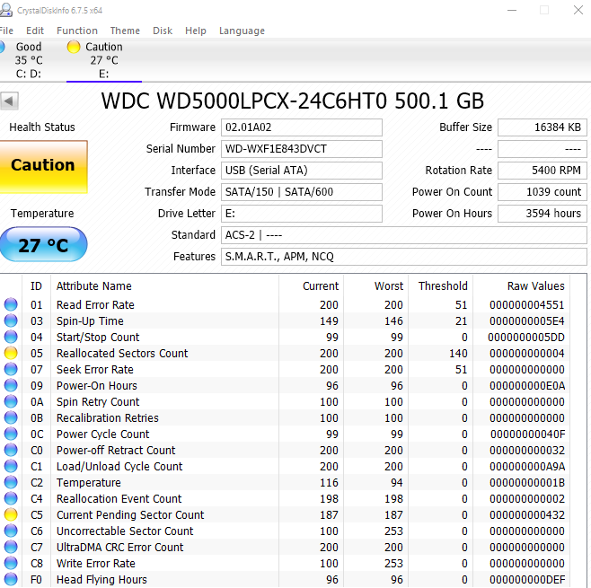

I have a HDD that has some unkown problems.
At first it was not viewable in explorer.
Now i made that happen with the "Test Disk" program.
I did manager to recover some files but i cant acces the "users" folder, it is also quite slow.
Maybe this gives you some info
I hope someone can help me recover my data,
Thank you!
 Post subject: Re: HDD repair problems
PostPosted: February 28th, 2016, 5:10
Media issues I'd say, probably has "slow responding" issues now.
Not sure, but also suspect this is an SED (self encrypting drive) so firmware access is blocked.
If you really want to try DIY, search "slow responding fix" but if the data is important then you really should seek pro assistance. We can help with this :-)

+1
diagnostic should be free, so it is always better to get a professional opinion before attempting any DIY.
