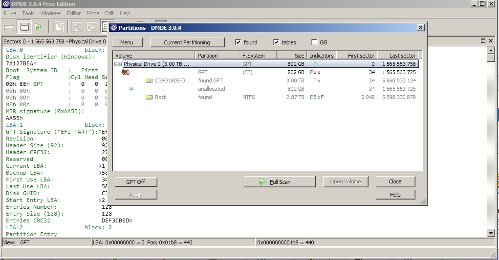

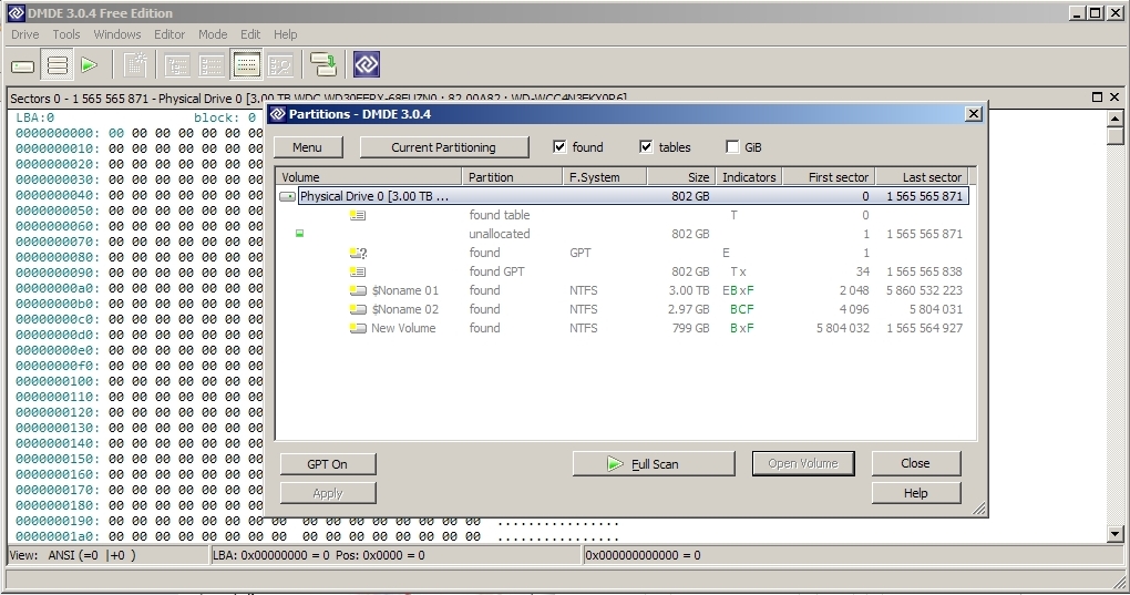

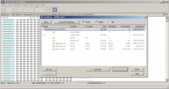

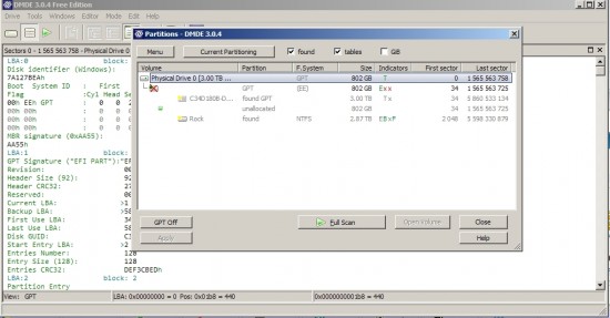

Thanks. Now I have another weirdness the old 3TB WD30EZRX and the new one WD30EFRX are only showing around 800GB. I've attached screen captures of the DMDE partition scan reports.

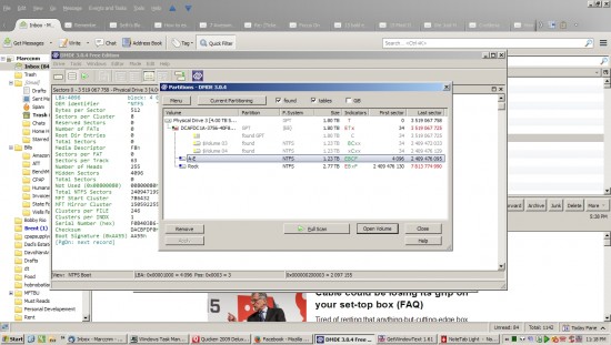

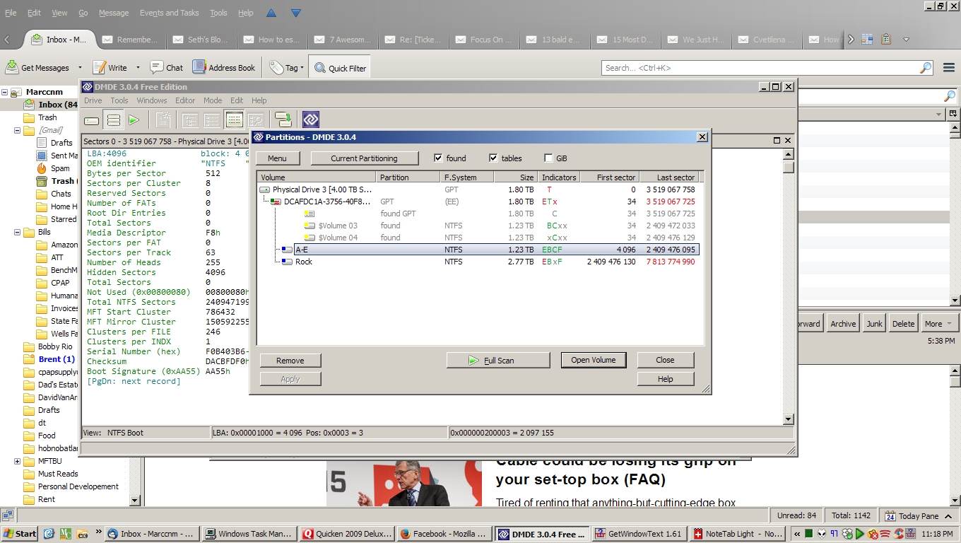

Your SATA driver appears to have a 32-bit LBA limitation. This could be because you have changed the SATA controller mode (AHCI/IDE/RAID), or it could be that you have reverted to Microsoft's driver. The fix is to switch to AHCI mode and update the driver.
3TB - 2TiB = 800GB
4TB - 2TiB = 1.8TB
