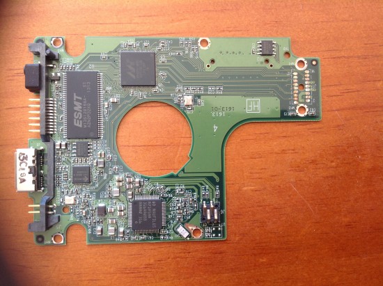

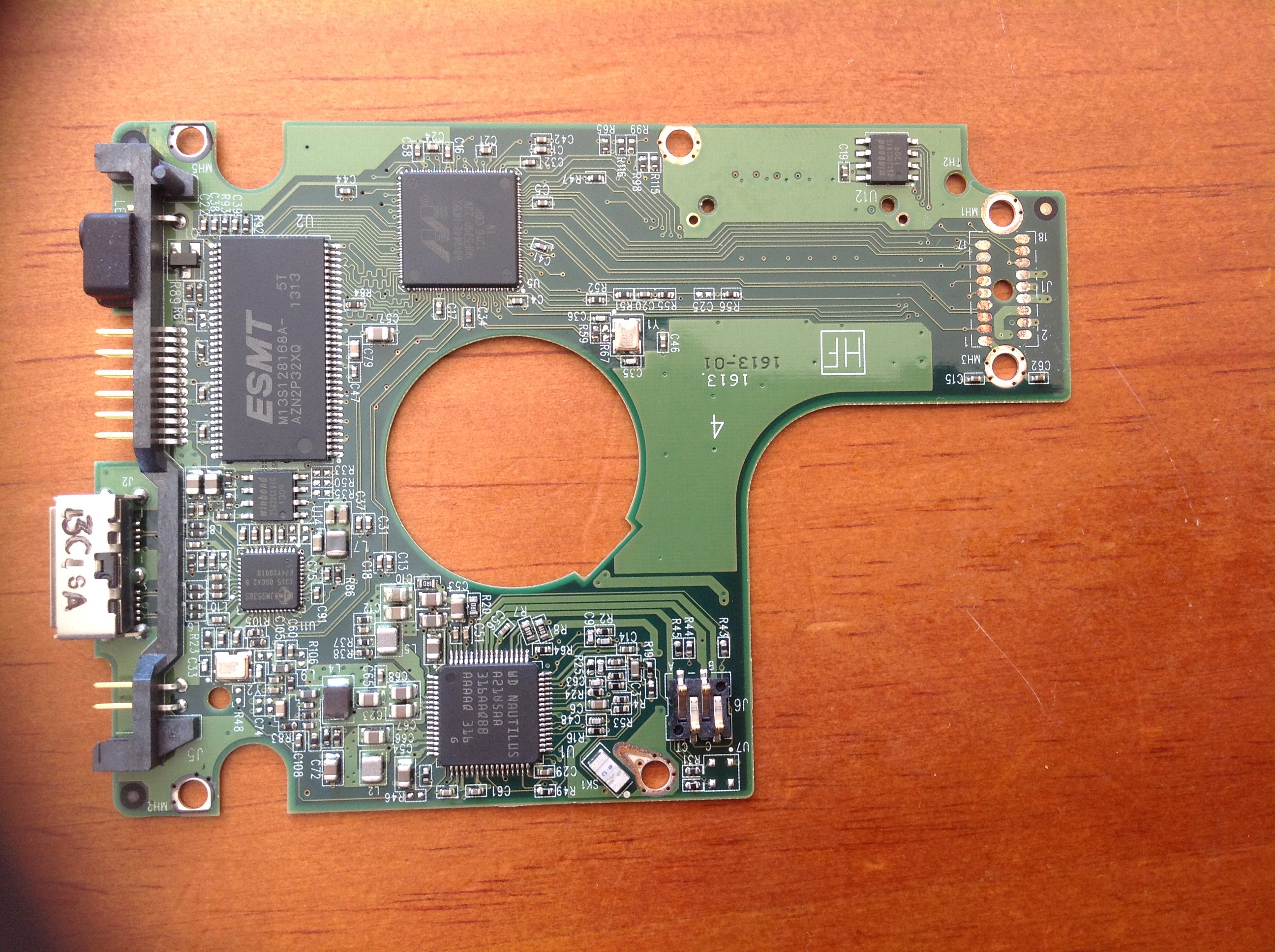

There are two winbond serial flash on my board. One is u12.
You mean If I swap to sata board, I can use firmware tool without special equipment?
Is there any firmware tool download link? Thank again.

 Post subject: Re: Is any hope for my WD elements 2TB usb3.0?
PostPosted: September 11th, 2014, 15:21
Posts: 17223
Sorry, 2060-771692 looks like a completely different board.
Instead this SATA board looks like it might be compatible:
http://www.hdd-parts.com/14060482.html (2060-771931)
It uses the same MCU (88i9446-NDB2) and motor controller (Nautilus).
Your board appears to be a 2060-771961. See the bottom side:
http://ep.yimg.com/ay/yhst-144375849714 ... b-fw-3.gif
http://ep.yimg.com/ay/yhst-144375849714 ... 4146-5.gif
As for firmware tools, there are a few:
http://sediv2008.narod.ru/Easy3.9Passwo ... 567890.rar (SeDiv, demo version)
http://wdmarvel.com/ru/ (WDMarvel, free demo or US$9 for 1 month licence or US$100 for full version, English GUI)
plus others ...
