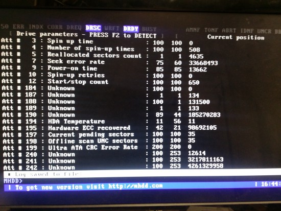

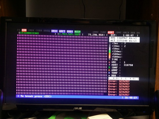

Seagate Barracuda 7200.11 1000Gbytes
Used in a encloser but taken out since it failed.

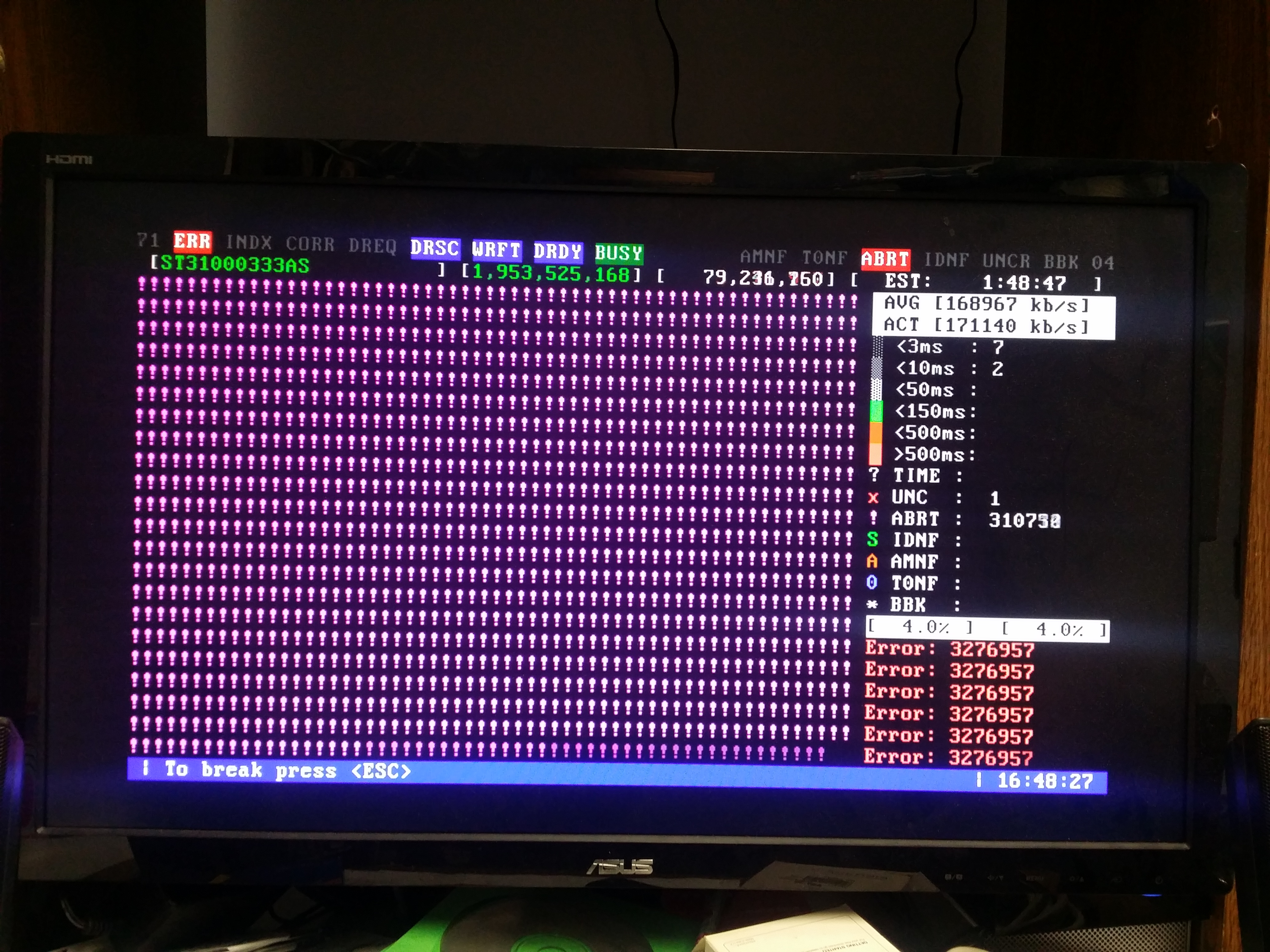

Windows could not see it so I used spin rite and it found some bad sectors so I tired lvl 2 fix and it eroded out on me and now if i do a scan all sectors are found as bad.
I need my sata off but spin rite made it wrose.
mini windows and linux don't see it but it does show up in BIOS
Seatools error out on long test
69d6d056
69d6d066

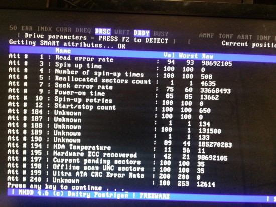

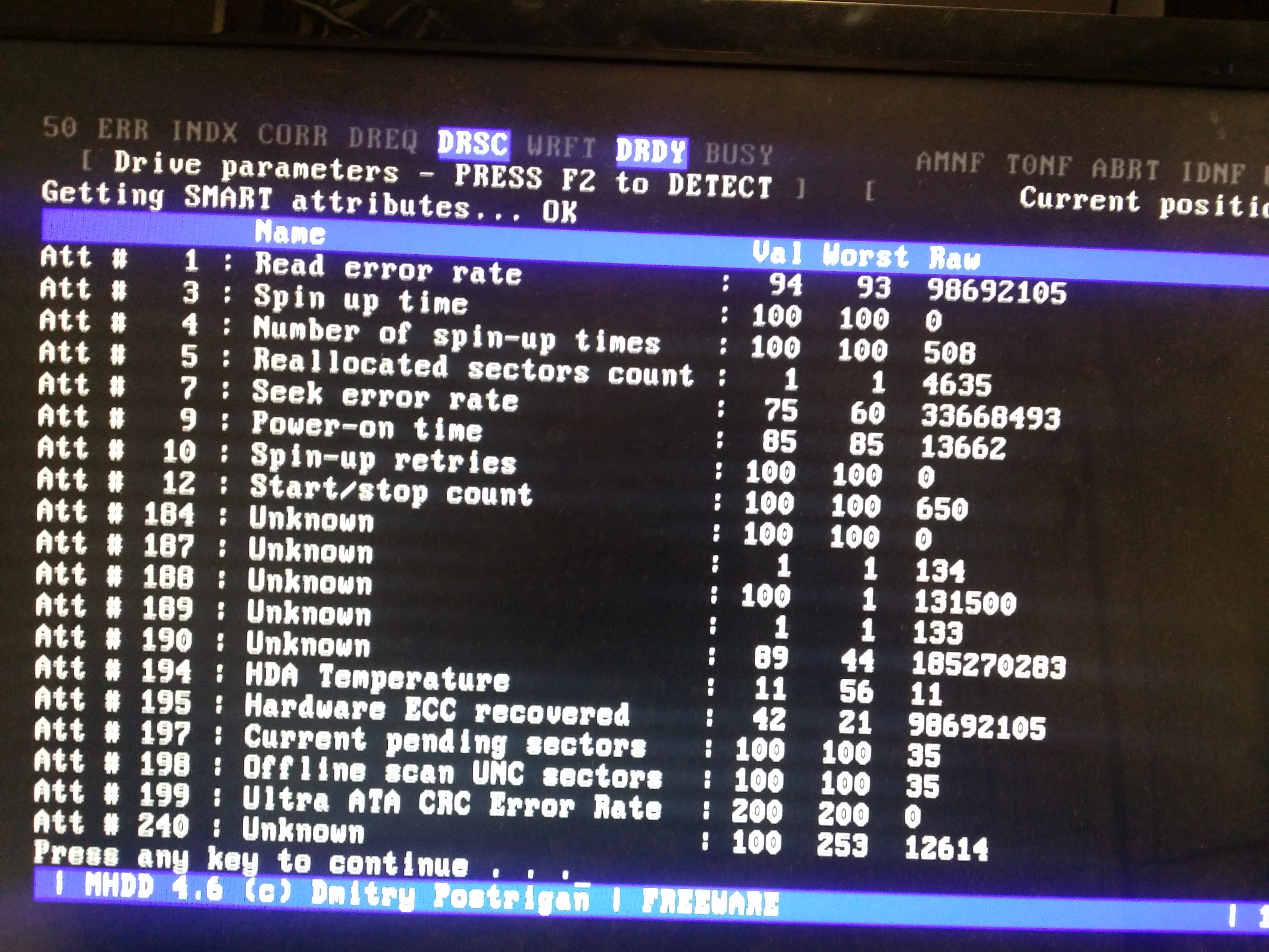

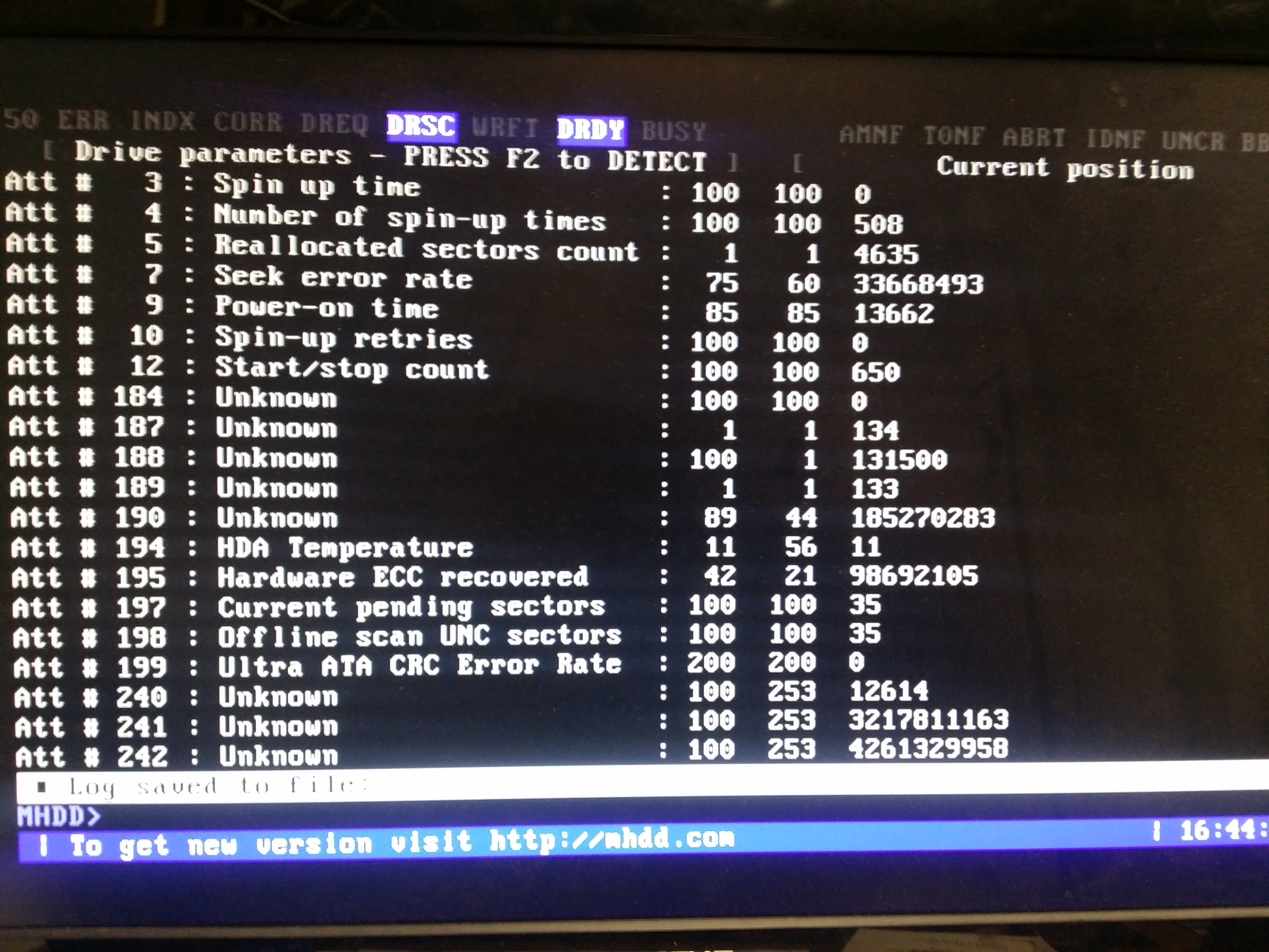

Im uploaded the smart read out on MHDD
Please help me it wont even show up in parted magic and test disk.
drive makes no bad sounds but sounds like the head is constantly searching like it does not see anything.
Thank You,
Doomwake

 Post subject: Re: Data recovering Seagate drive
PostPosted: March 11th, 2016, 5:33
Posts: 330
My bet is a trasnalot sys file is corrupt, and it's not loaded. The heads are not reads from surface, because controller sends back ABRT to any reading requests.
What tools you have? First you have to backup firmware modules, and some important sys files before do anything with the drive.
If you don't have proper tool(s), your chance is very slim.
