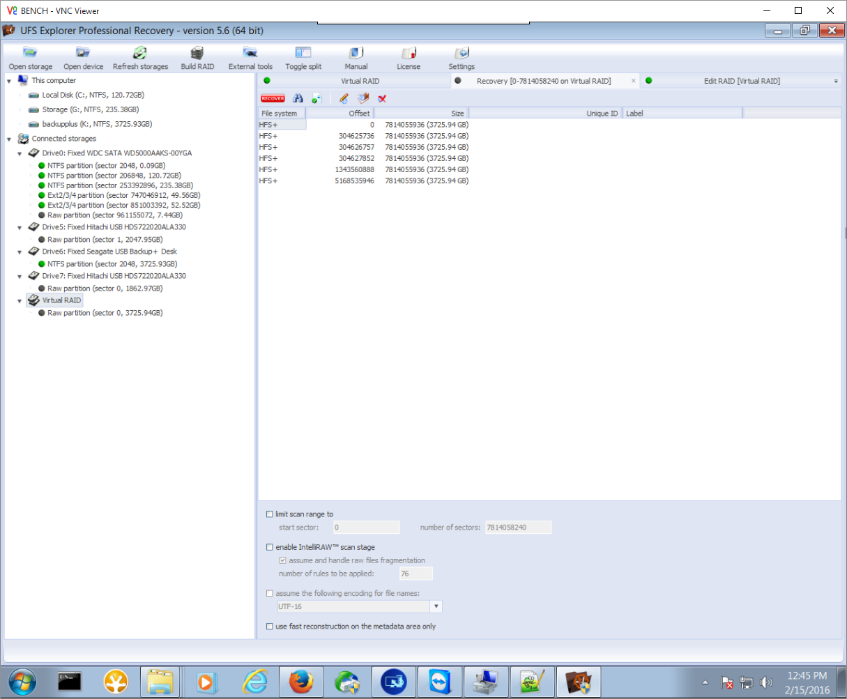

I am attempting to recover data from a raid 0 two drive array. These two drives were part of an caldigit VR 4000GB enclosure. The controller has since failed so I am attempting to do the recover on another USB enclosure.
The drive specifics are below:
*-disk:0
description: SCSI Disk
physical id: 0.0.0
bus info: scsi@8:0.0.0
logical name: /dev/sdg
capabilities: partitioned partitioned:dos
configuration: sectorsize=512
*-disk:1
physical id: 0.0.1
bus info: scsi@8:0.0.1
logical name: /dev/sdh
root@bench:/home/trinsic#
root@bench:/home/trinsic# mdadm --misc --examine /dev/sdh
mdadm: No md superblock detected on /dev/sdh.
root@bench:/home/trinsic# mdadm --misc --examine /dev/sdg
/dev/sdg:
MBR Magic : aa55
Partition[0] : 4294967295 sectors at 1 (type ee)
I talked to the person using this drive, he said the drive booted but hanged during a on device system check of the array VIA LCD display. He power cycled it the enclosure and it went though its check successfully this time, but the OS failed to read the partition when it was connected to his mackbook pro. The drive was partition as HFS+
I booted the two drives up in my linux box and checked for a partition using SFdisk, but it was missing as far as I could tell.
During a scan for lost partitions using testdisk I got a raid failure on the LCD display and testdisk stopped responding. I attempted to power cycle the enclosure but one of the drives wouldn't finish its check and the test failed to complete successfully. I attempted to reseat the drives but the enclosure would not reaching a passing state in the test of the drives. So i pull the drives out of the enclosure and put it into my two drive enclosure.
I did a smart scan on both the drives and the both are healthy.

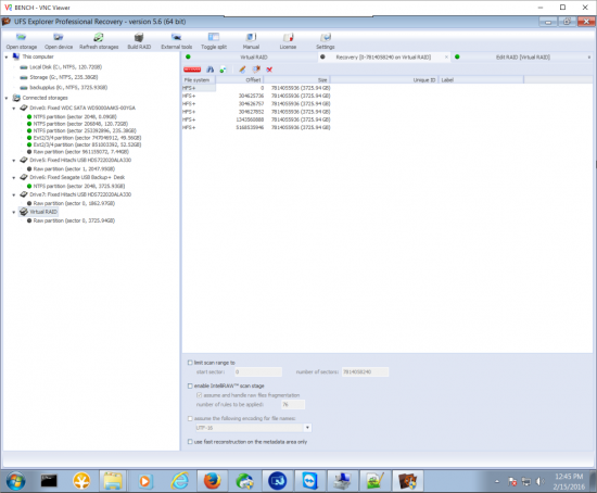

Since i dont know how to build a virtual raid in linux I used UFS Explorer to create the virtual raid making sure drive 0 was the first drive in the list and ran a partition recovery on it. It found 6 partitions with different characteristics and wondered what would be the best way to find out which one was the right one. attached is a picture of HFS Explorer's recovered partition information.
I want to make sure I recover the right partition and wondered if anyone has experience with this particular kind of recovery that could help, thank you.
File comment: UFS explorer list of partitions recovered from the virual raid 0
ufs-explrer-screen-shot-raid-partition-information.png [ 222.83 KiB | Viewed 17854 times ]

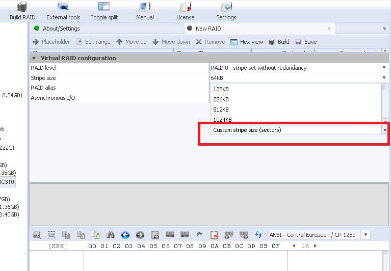

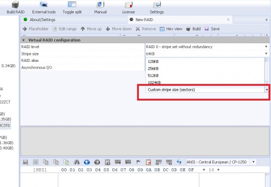

Configuration of Caldigit's RAID0 is a bit tricky. Set 1 sector stripe size.

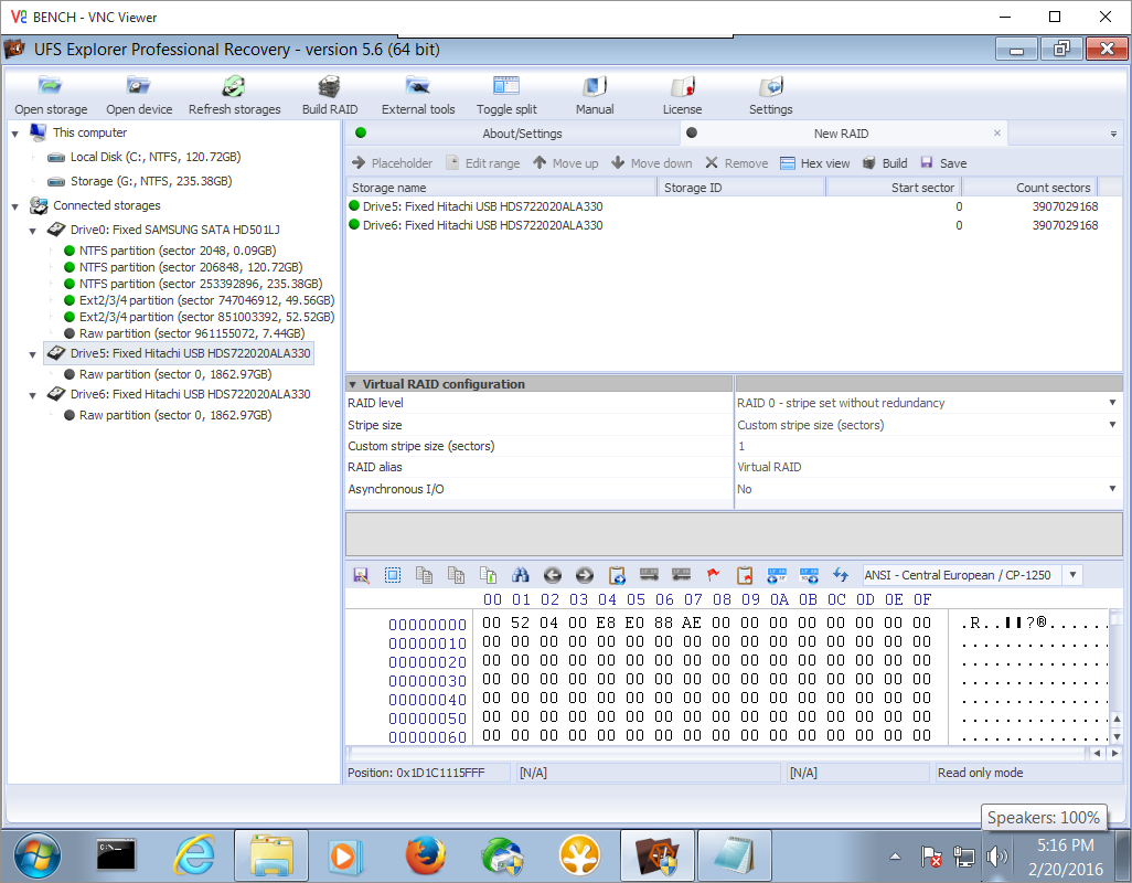

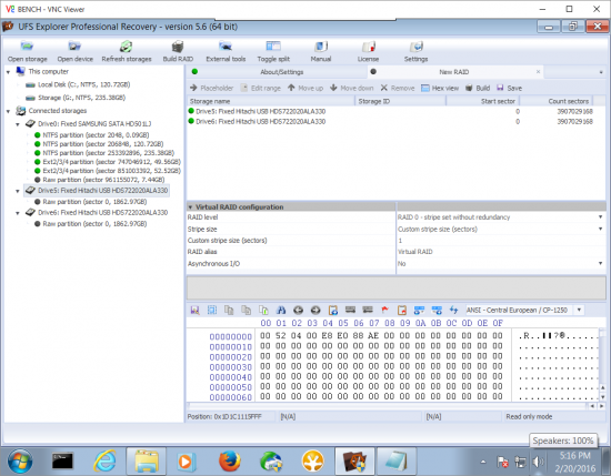

Done.
FYI, I made sure the drive configuration is in the correct order by refreshing the storage devices one for each drive detection.
ufs-explrer-screen-shot-raid-partition-stripe-size.png [ 102.76 KiB | Viewed 17625 times ]

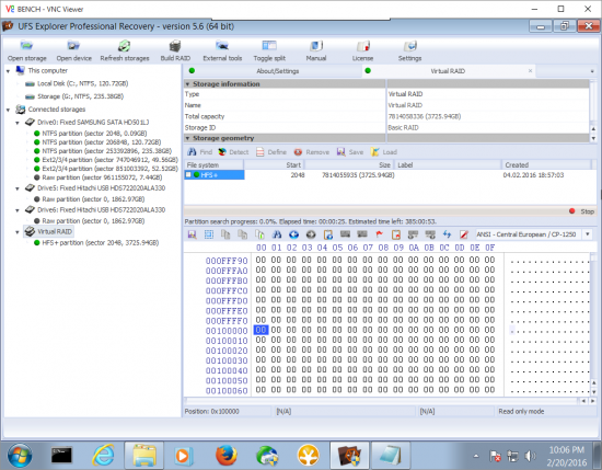

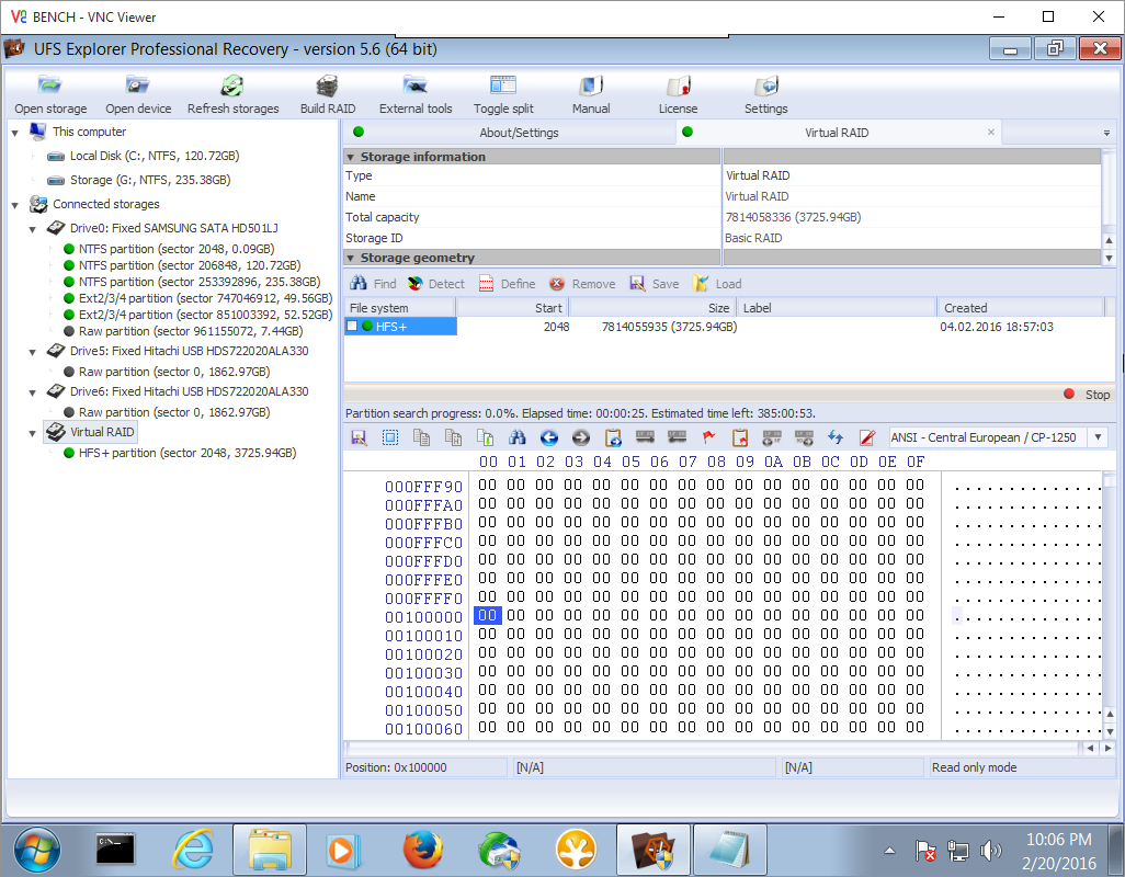

Now , start seaching for the Hfs+ partition , it usualy starts from 409640 offset
Angel Data Recovery
 Post subject: Re: Recovering a lost HFS+ partition fr a two drive raid 0 a
PostPosted: February 21st, 2016, 2:07
Joined: September 16th, 2010, 15:27
Posts: 28
Location: California
I started it, but it looks like its going to take 380 hours? is that right?

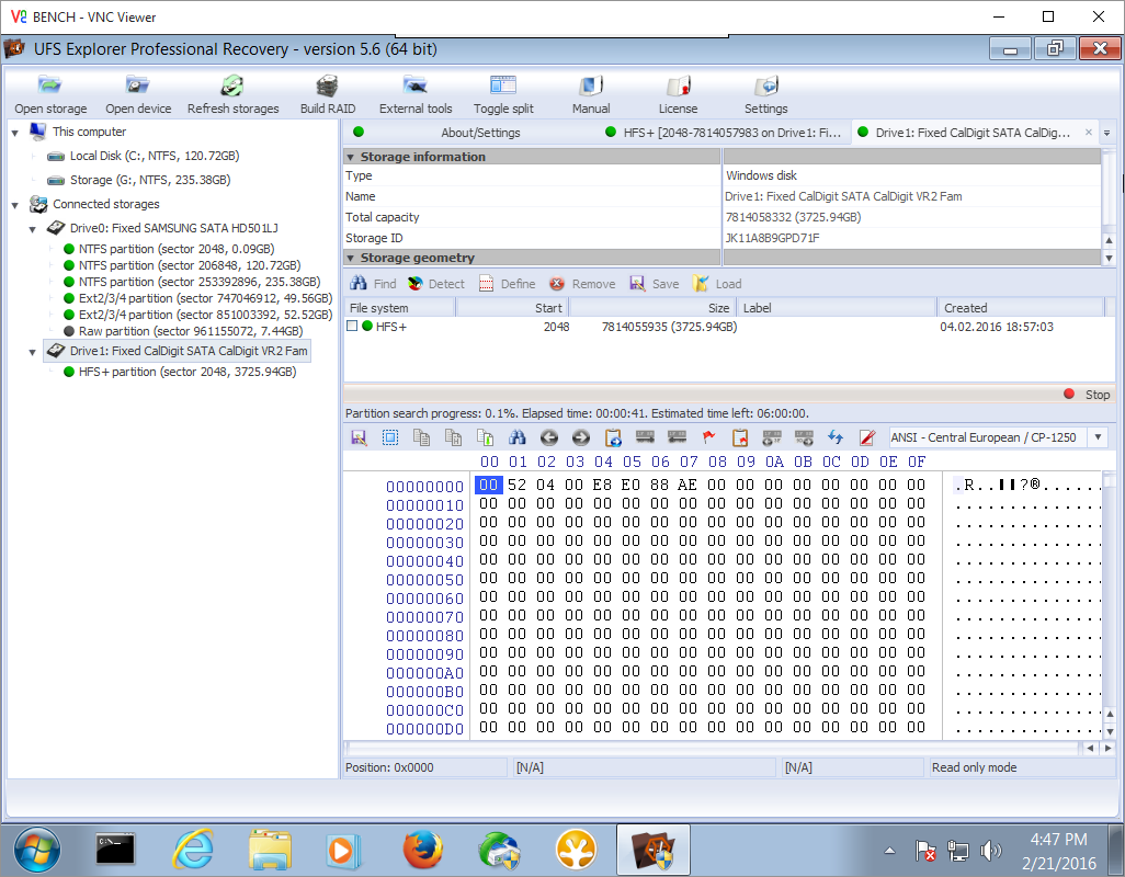

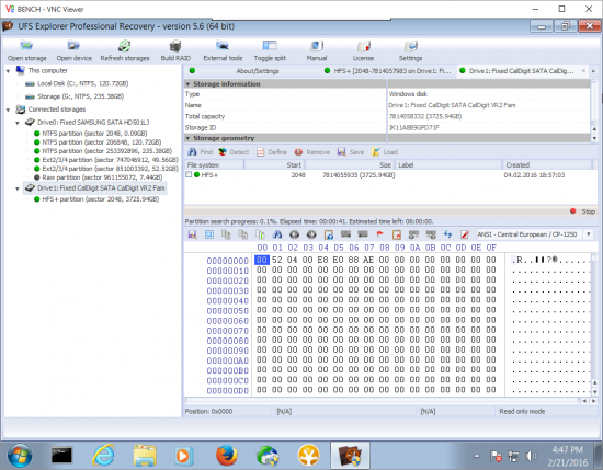

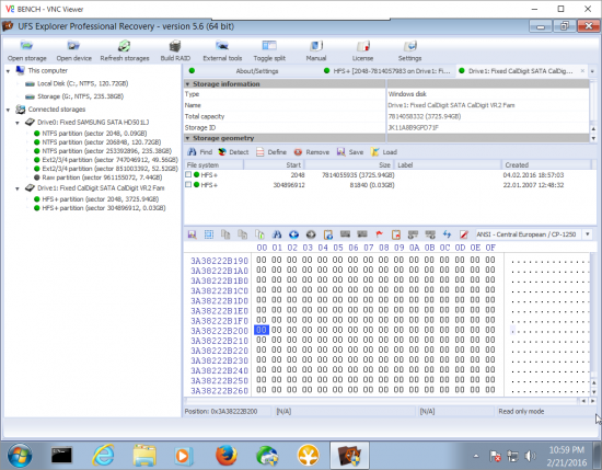

I now have in my possession a new replacement caldigit enclosure of the same type of the original enclosure these two drives are in when it died. Here is the new screen shot with the enclosure connected via sata. The scan time has decreased to 6 hours. Ill let you know when its done.

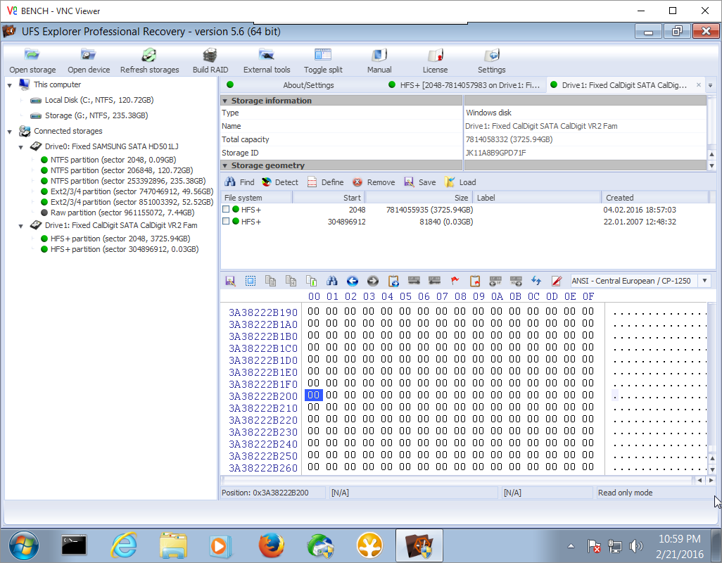

The scan is complete.
PostPosted: February 22nd, 2016, 10:49

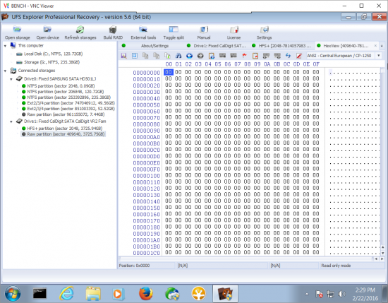

I don't think I've ever seen an HFS+ partition start at offset 2048 before. Seems fishy to me.... Perhaps the start of the partition was wiped somehow. If you're not able to open any files by using that layout, try manually defining a HFS+ partition at sector 409640 instead.
PostPosted: February 22nd, 2016, 18:34
Posts: 28

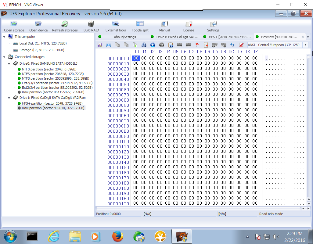

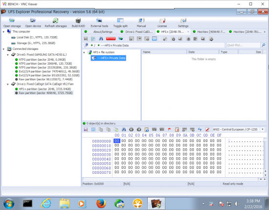

OK, I adding the partition at that range, but it comes up as unknown, or raw.

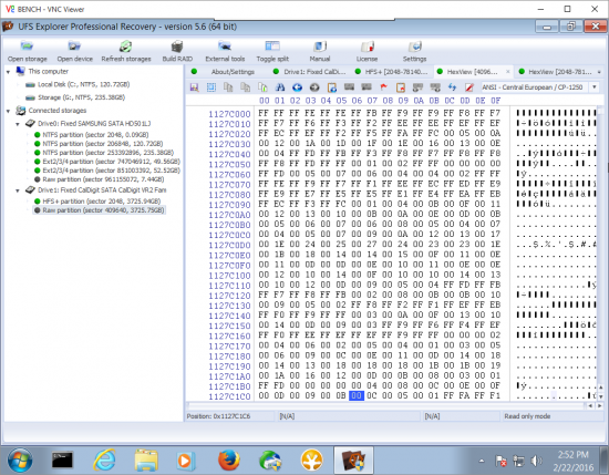

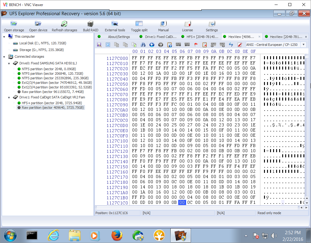

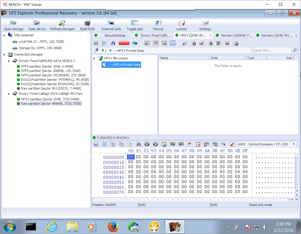

It doesnt look like there is any data until position 0x1127C000
ufs-explrer-screen-shot-caldigit-unknown-0x1127C000.png [ 97.02 KiB | Viewed 17447 times ]

Also the HFS+ file system only has one directory HFS+ PRivate Data but the folder is empty.
ufs-explrer-screen-shot-caldigit-hfsplus-filesystem1.png [ 99.84 KiB | Viewed 17442 times ]
