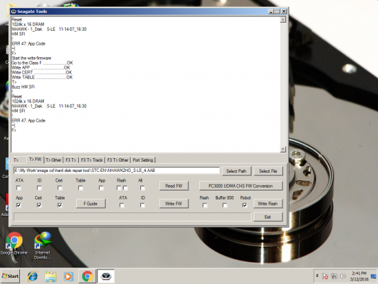

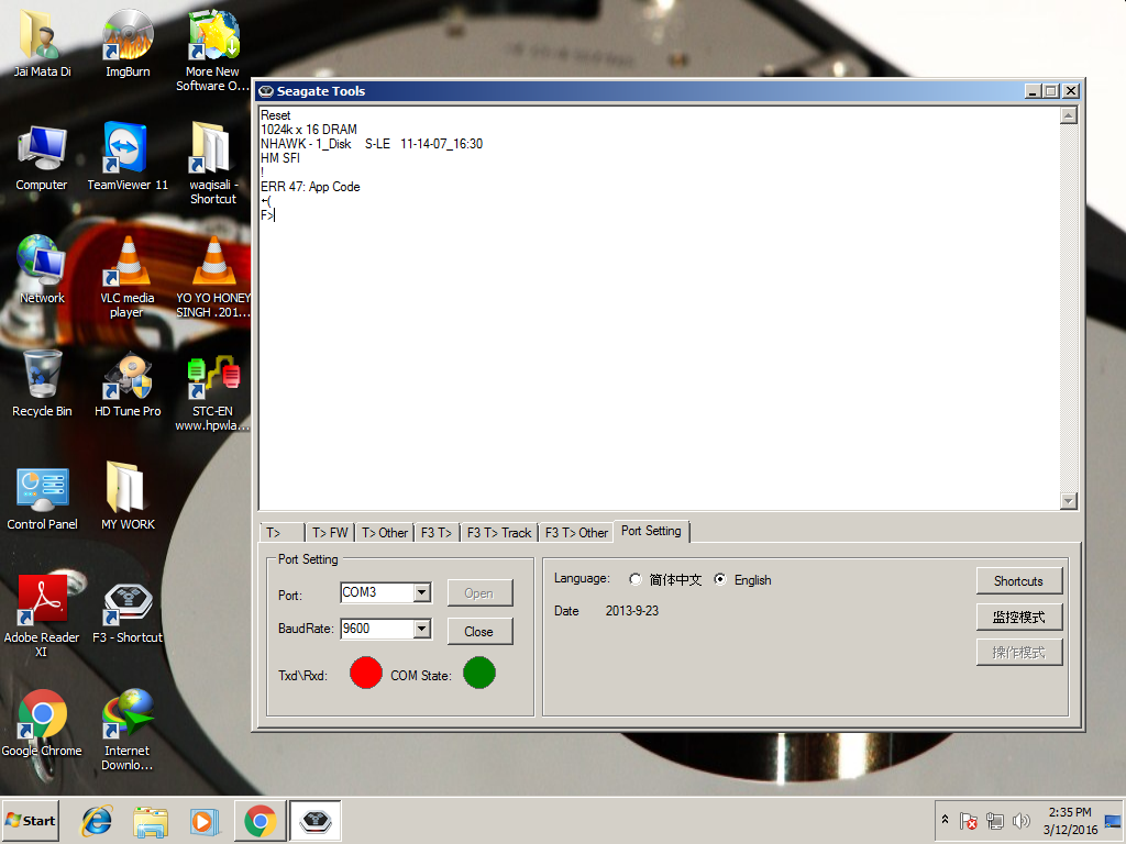

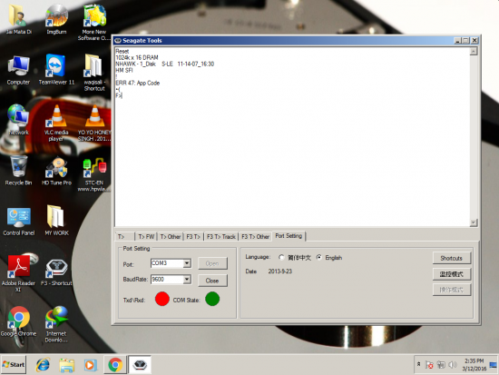

i load Cert/ app / table
but cant fix the problem

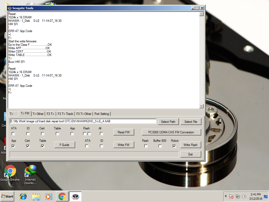

after load

Spildit wrote:
Did you save the ENTIRE APP TRACK with something like STCom tools ?
If so restore the entire track when the drive is booted up to T> with the correct code.
Looks like that either your APP code is damaged or your tools are not properly writting it to the drive.
If the firmware boundries where the software is attempting to read or write the app from are incorrect writting back the entire track might solve the issue, assuming you have a backup from it.
@ galaxy
either you can upload all mod in level F
simply be Stcom
then start SF
or do 02 calibration
http://www.hpwlab.com
