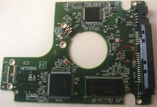

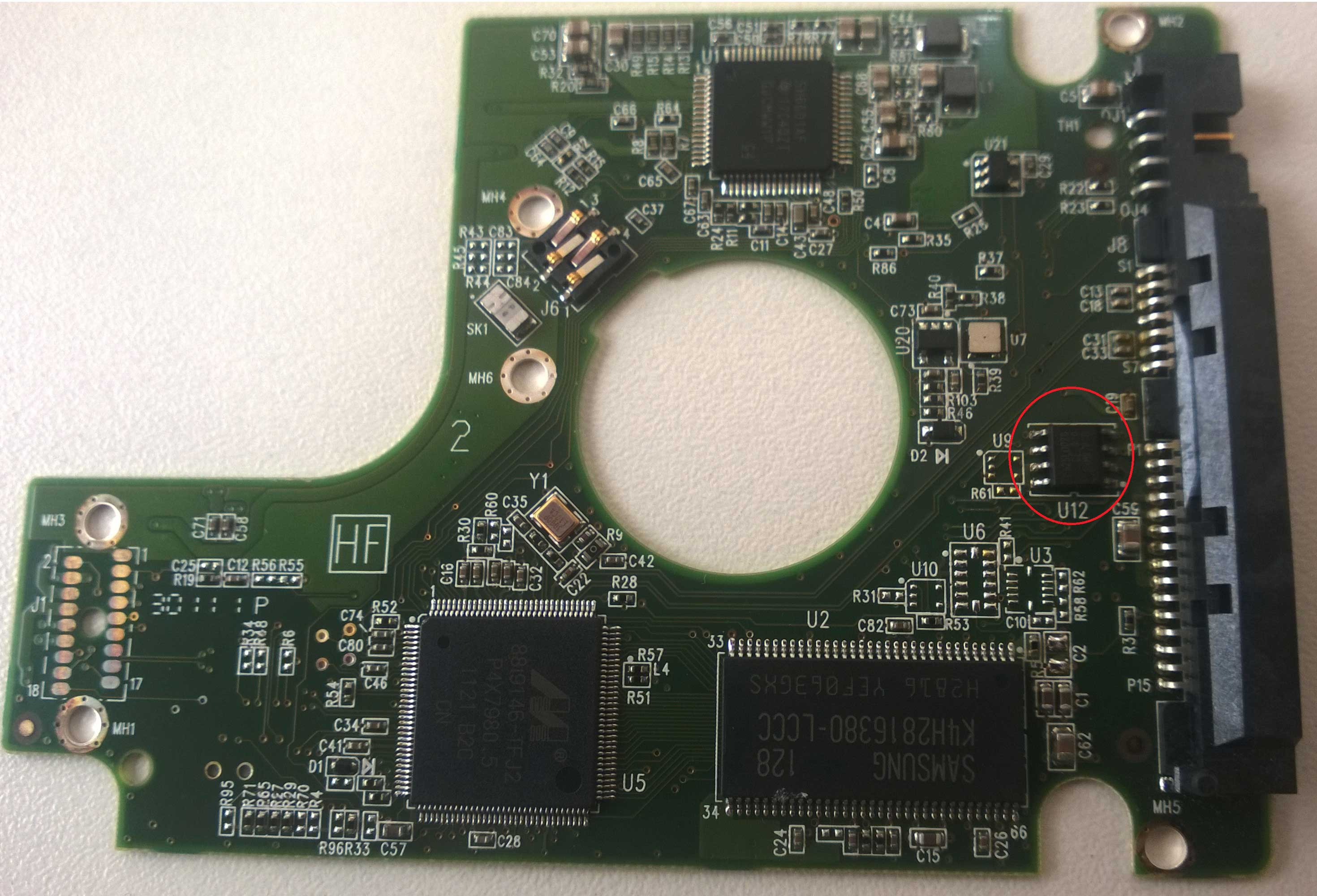

I try to replace a USB PCB 771737 by a SATA PCB according to http://ts.acelaboratory.com/index.php?/ ... usb-drives I can use either 701692 or 771692
When I see the USB PCB, I can see 2 ROM but the SATA PCB coes have only 1 ROM (see photos)
The USB PCB contain U8 & U12 chip but SATA PCB contain only U12 which is smaller than the U12 of the USB PCB (looks like the U8 chip).
Any solution to make teh replacement work please?
Thanks in advance.

U8 contains the bridge firmware whereas U12 contains the HDD firmware. You only need to bother with U12.

But if you see the USB and SATA PCB, U12 chip doesn't seem to be the same size!

They are the same size, well the pin specs are the same which is all you need to worry about, they are just different packages.

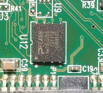

Hello
I resume this topic because I have a similar case with same USB board :-)
It is on a WD10TMVW-11ZSMS1 and the board is 771737-600
well I have its "donor" SATA board 771692
but reading the 771737-600 ROM I got it as size 512KB while the "donor" 771692 is 256KB
so writing is not obviously allowed
ok, moving the ROM is the solution, but have have you had the same experience?
And so, have you found some 771692 with ROM size 512KB?
If yes, which was it the donor drive model?
I ask that because I don't like to solder de-solder too many times the ROMs from the same board, because sooner or later some lane will detach.
Additionally, as you can see from the attachment, the ROM is the really annoying one to get de-solderd
Thank you
File comment: ROM Picture

Yes, some have 256Kb and some 512Kb.
