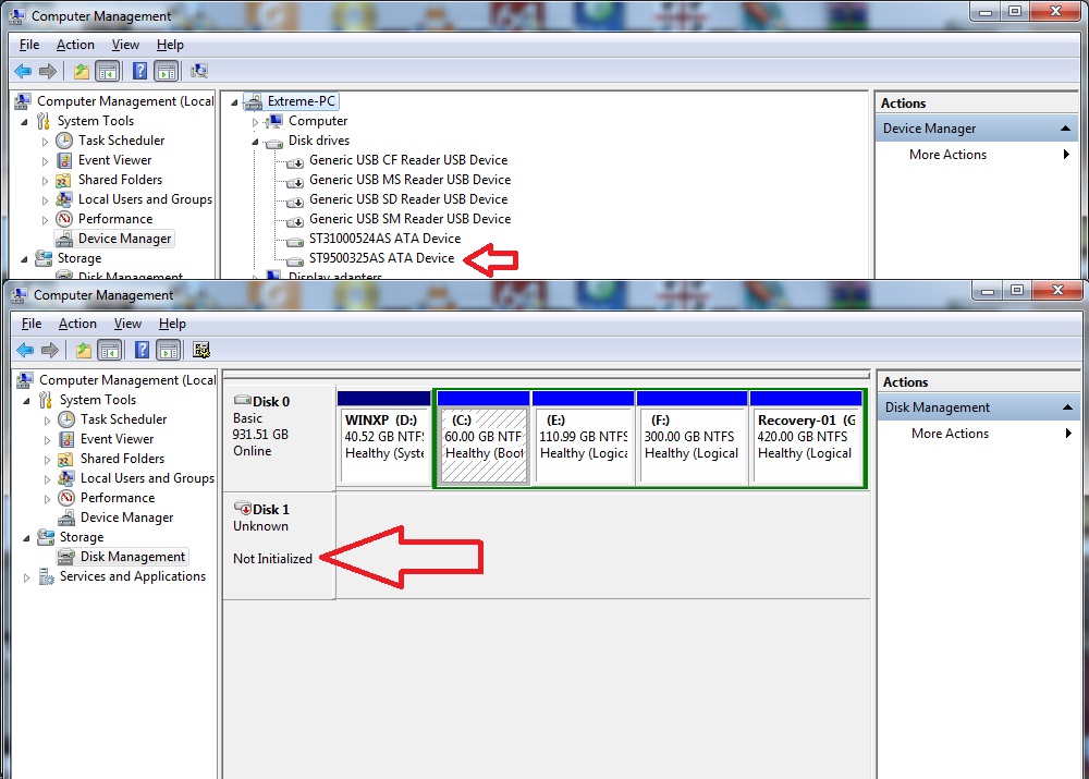

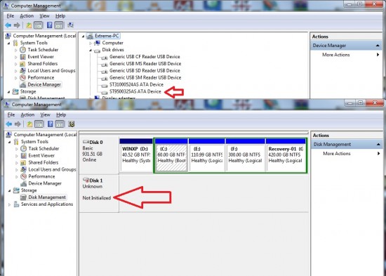

1. Hdd is not detected when spinning with tor tor sound(not Tick Tick) 11 times with small interval
2. After Spin-down the hdd is detected with correct ID no Size but not initialized (image Attached)
One More info: When Connecting just PCB with sata and power the system detect with correct ID
how this how to resolve this?
Sorry for poor explanation
 Post subject: Re: ST3500325AS Problem
PostPosted: March 17th, 2016, 11:04
Heads and/or media. Requires heads exchange plus further work.
Not DIY
