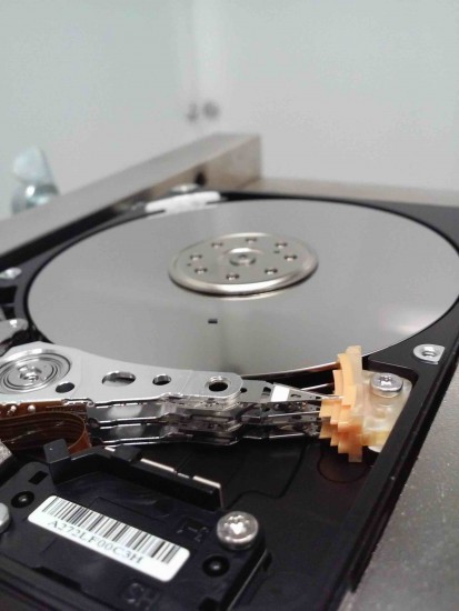

Before I begin, I know I am a potato head and that I should've made backups. Lesson painfully learned. Thank you all for reading and helping. Any advice is appreciated.
I have a 1TB Seagate Drive with some files on there that are very important. The drive suffered a mechanical failure and I've taken it in to a very reputable local data recovery place with a clean room and they quoted me: $1900. This was their diagnosis:
Mechanical/Physical failure(s):
-Previously opened drive* (I took the drive to them first, then shopped around for prices but no other service could do it, and then went back to them and they said "more damage has been done" so the price went up as well from $1300 to $1900).
-Visible damages on the top platter.
-Read/Write heads damaged and bent.
-Fused read/write chip on the platter.
-Drive has bad sectors.
-Possible minor scratches on the internal platter(s).
I am now deciding between going with them for $1900, or DriveSavers for a range of $700-2000, or Seagate's In-Lab data recovery which will do it for a flat $599. How come Seagate is substantially cheaper?
These files are fairly important so it is crucial that I recover the folder on the hard drive (don't need everything, just about maybe 50gb of files). Could you guys please recommend the best route for me to take right now? I am a student, so obviously money is an issue, but also I weight the value of the files more heavily.

data-medics wrote:
From the looks of that drive and description, there's a good chance that no one will be able to get your data back, I'm sorry to say.
That is very disappointing to hear...if you are judging based off of the black dot you see that is just a reflection in the image im pretty sure. thanks for the input.
 Post subject: Re: Data Recovery Help and Advice - Urgent - Many Thanks In
PostPosted: March 4th, 2016, 0:40
Posts: 17223
It looks like the slider has detached from the top head, most likely due to stiction.
+1
Shoot...I think you are right...oh man oh man. What do you suggest I do at this point? I'm honestly just trying to get some real opinions, because everyone I've talked to has tried to sell me on something...

Also, I agree with others; it's not going to be an easy recovery -if any-. Expect partial recovery if you're lucky.

Thank you very much for your kind words and referrals.
Just for the record, we don't charge anything to evaluate a drive. The $100 lab fee comes into play only if we replace the heads but cannot complete a recovery.
I'll be delighted to check out your drive. We recovered one with identical symptoms (mangled heads and stuck slider) this past week. It all depends upon the depth and location of the media damage.

Hi All, I've spoke will Jon regarding this recovery and will be mailing him the drive this afternoon. I will keep this post updated as the recovery process begins and if anyone in a similar situation has any questions please feel free to contact me or post here.

*UPDATE ON THE MATTER*
I've recently just received the recovered drive back from Jon at DataSavers, and honestly guys I could not have been more satisfied with how everything went. Jon is absolutely AMAZING and extremely patient/knowledgable. He kept me updated everyday and even sent me pictures of the recovery process. This was by no means an easy recovery as I've gotten diagnostics from various other data recovery centers before finding Jon. However, despite the difficulty, Jon was able to essentially recovery 100% of the drive. I could not love this man more. Please, if you are in need of data recovery, stop looking and call Jon.
