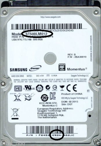

Samsung drives for HSA exchange compatibility you need donor drive with:
Matching model number example: ST1000LM024 , or USB drive with model number ST1000LM014 is same as ST1000LM024 inside.
Matching second part of part number, example G84A, G14A, G141, G841. The third character represents numbers of heads.
Closest manufacturing date for safety sake.

 Post subject: Re: Samsung ST1000LM024 : head stack compatibility questions
PostPosted: April 6th, 2016, 16:52
Posts: 331
H13 wrote:
matching second or first off part number ? its not clear for me
thanks

Hi , saltwater,
Thanks :)
this is what we look for
