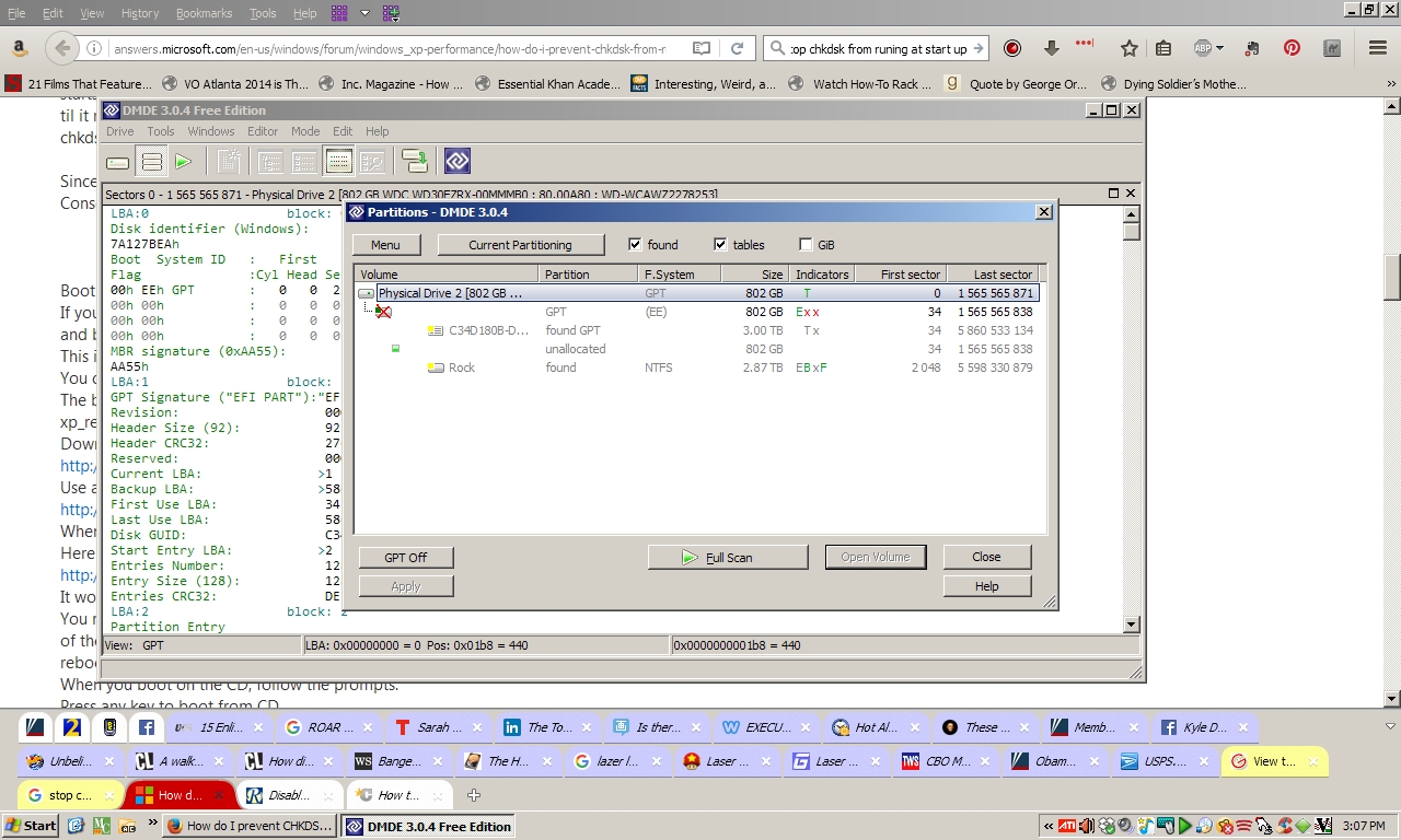

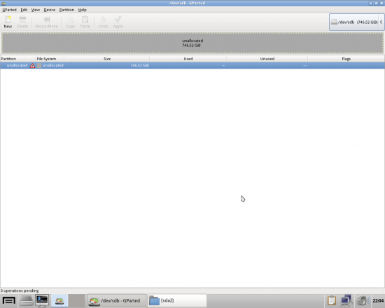

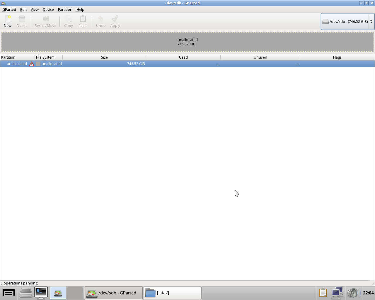

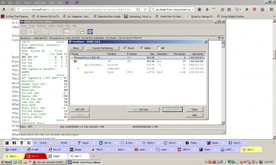

First thanks for all the help on the bad drive with the read errors. I recovered most everything. Out of 142053 files only 63 that were recovered are unplayable. The Western Digital WD30EZRX-00MMMB0 in the first post with the GigaByte BIOS bug problem is the last one and it's a relatively small partition at the end. It's only 125GB with only about 25GB of data. The drive still reported errors with it's size even though I could access the entire drive. I used SeaTools for DOS and set the drive back to it's original capacity. Now there's nothing. DDRescue, DMDE and Gparted all show the drive being about 800GB. Windows Explorer shows the entire drive but both partition aren't formatted. I've attached the screen captures from DMDE and Gparted along with the log file from DMDE.

The reduced 800GB capacity is symptomatic of a 32-bit LBA limitation. This is either a BIOS problem or a SATA driver problem. Upgrading to the latest SATA driver would be advisable. Also confirm that the SATA controller is set for AHCI mode, not RAID or IDE compatibility mode.
