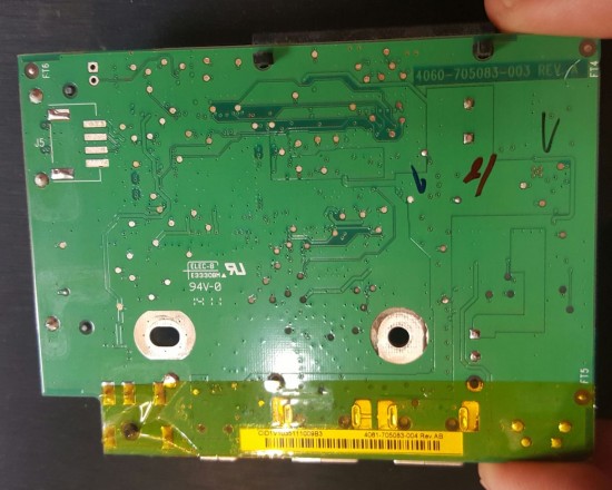

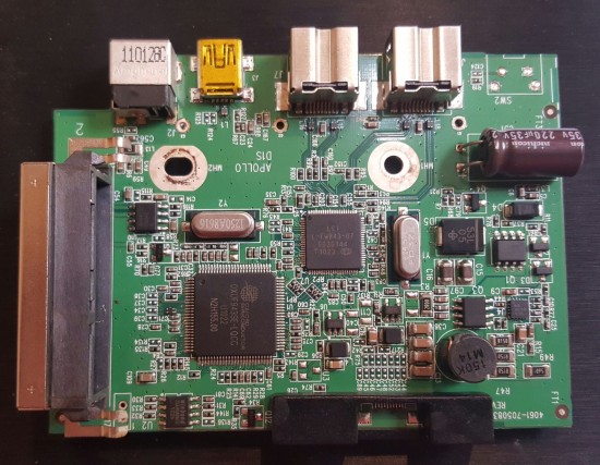

Have a WD MyBook Studio drive here that had the wrong power supply plugged in. This damaged the hard drive PCB but I located a donor board and swapped firmware over and it now powers up and is recognized but of course I can't access data due to encryption. The bridge board on this particular model is part number 4060-705083-003 Rev A with Oxford encryption chip. Unfortunately it is also bad and does not provide power to drive. Normally I would just swap bridge board but I don't have any with Oxford chip, nor can I locate any suitable donor boards online. Any suggestions on testing / repairing the bridge board?

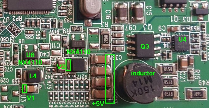

U2 is a serial flash memory. Perhaps you could try moving it to your donor.
U10 is a dual MOSFET. It switches +5V and +12V to the HDD under control of the bridge IC.
U4, Q3 and the 150K inductor appear to constitute a +5V DC-DC converter.
U6/L4 and the nearby IC/inductor pair constitute two switchmode supplies, probably Vcore and Vio (+3.3V) for the bridge, serial flash memory and the Firewire IC (FW843).
Measure the voltages at the V1, V2 and +5V test points. I would also check the zero-ohm resistor (L13) near the DC power socket.

First, thanks, as usual fzabkar, you always have excellent suggestions.
Unfortunately I don't have a donor for the bridge board, just hdd pcb otherwise I would take your recommendation and swap U2.

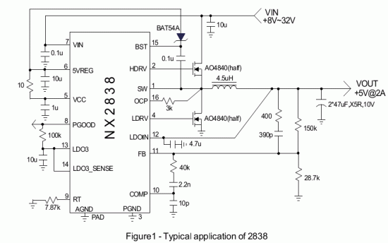

L13 resistor reports .1. I get no readings on V1, V2 and +5V test points. I get 12v on the top left two legs of Q3 (as seen in your enlargement in previous post) no readings on other legs.

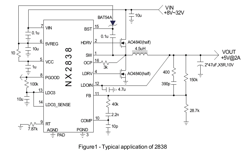

AIUI, the +5V DC-DC converter provides the input to the V1 and V2 regulators. Therefore the problem may be confined to the +5V supply. That said, the NX2838 IC and AO4840 MOSFET are rated for 30V operation, so I can't understand why this section of the circuit appears to have failed. Perhaps your AC adapter had the wrong polarity?
Could you measure the TVS diodes on your HDD PCB? I expect that the 12V diode will be shorted, but it would be interesting to see if the 5V diode survived.

NX2838, Nexsem/Microsemi, 30V Adj HF Single Synchronous. Controller + 3.3V/500mA LDO:
http://www.microsemi.com/document-portal/doc_download/124276-nx2838ds
AO4840, ALPHA & OMEGA Semiconductor, 40V, 6A, Dual N-Channel MOSFET,
http://aosmd.com/pdfs/datasheet/AO4840.pdf
