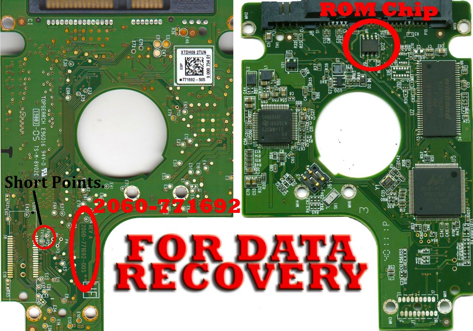

Hello
The solution of WD external USB3.0 hard disk which always shows busy status after giving ready status, not giving access firmware area.
http://hddrepairing.com/forums/viewtopic.php?f=5&t=74

Are there comparable short points for 771959? TV9 & TV10 do not work
 Post subject: Re: WD 1TB external USB 3.0 hard disk Busy problem.
PostPosted: April 7th, 2016, 16:16
Posts: 17324
Tip: How to identify the Read Channel test points:
http://www.hddoracle.com/viewtopic.php?f=24&t=123&p=149
