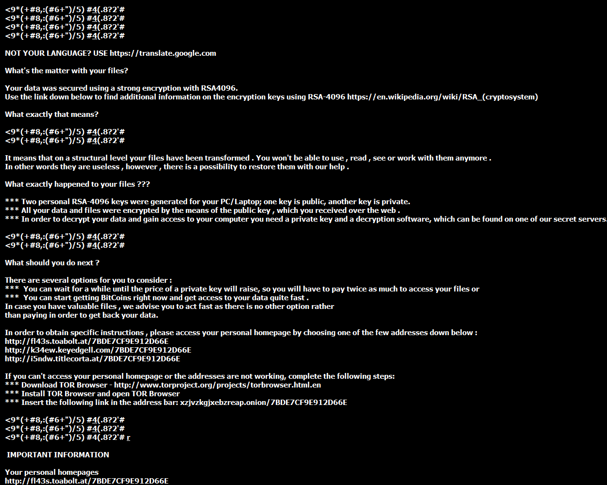

hi,
laptop with magnetic hard drive is encrypted by hacker on internet. all data cannot be opened. it's useless. and there is message from hacker:
is there any means to decrypt and get access to all data again?
thanks.

you are looking at TeslaCrypt 4.0. It is a hard road to recovery for this crap. You will have to start googling and becoming familiar with these threats and before you take on the recovery, know it is a LOT of TIME CONSUMING work on your part. Likely it makes no business sense to try and do these cases unless you have a proven tool for decryption. I haven't researched it, though these suites may help in at least understanding what you are dealing with.
http://nabzsoftware.com/types-of-threats/teslacrypt-4-0
https://github.com/Googulator/TeslaCrack
be extremely careful when researching as some malware scumbags pose as decryption information and you get further hit with it while looking for fixes.

All TeslaCrypt versions (including 3.0 and 4.0 ) can be decrypted

TeslaCrypt shuts down and Releases Master Decryption Key:
http://www.bleepingcomputer.com/news/se ... ption-key/
In surprising end to TeslaCrypt, the developers shut down their ransomware and released the master decryption key.
Now that the decryption key has been made publicly available, this allowed TeslaCrypt expert BloodDolly to update TeslaDecoder to version 1.0 so that it can decrypt version 3.0 and version 4.0 of TeslaCrypt encrypted files. This means that anyone who has TeslasCrypt encrypted files with the .xxx, .ttt, .micro, .mp3, or encrypted files without an extension can now decrypt their files for free!
http://download.bleepingcomputer.com/Bl ... ecoder.zip
Usage instructions are provided at the bleepingcomputer.com page.
